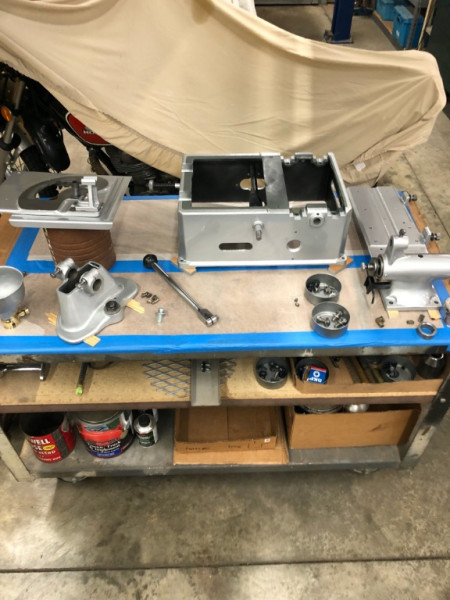

Sometimes old is better in my opinion as the quality in hardness, interchangeability, and self sharpening is unmatched. Been collecting parts for some years for my new up and coming interest...., hyper balanced engines. Everything starts from the inside out. Valve precision is a key factor with porting. Love to see an engine run with a glass of water on the top with no ripples! Watch a true Rolls Royce, Maybach, or M3 BMW, etc.. Pretty awesome!

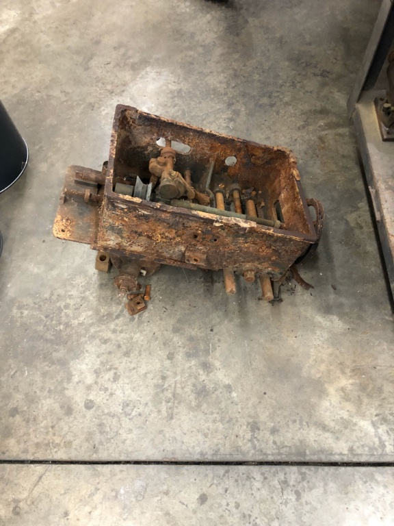

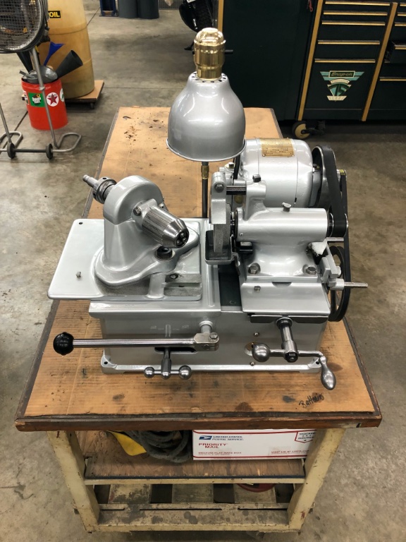

WOW, nice work on transforming that Sioux grinder!
I have the same Sioux valve grinder. Mine is still wearing about 95% of its original paint. Without going out to look, think it is a Catalog number 650. It had a new stone installed when I got it. Only problem is, the outer diameter is now too small to use the stem grinder. With the chuck installed, the stem holder can only go on one way, putting the Vs to the outside of the stone. The stem ends up with a nub on the end. While I don't think so, the stem holder that came with it, may be the wrong one. The stem grinder is missing the stem clamp/hold down. It also came with the stone dresser, the allan tool with knurled handle for adjusting the collars and one other piece that don't recall its use. Because this model is dry grind, takes a little more time to grind the valve and stems, allowing a cooling cycle.

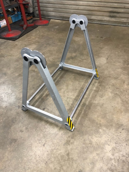

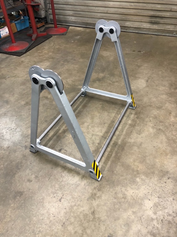

Nice roller balancer! I would trade my knife-edge homemade one, any day of the week for one like that.

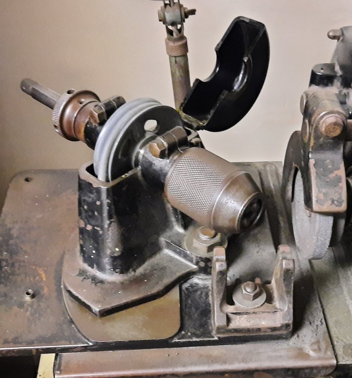

Nice work on that Sioux, Hank.
Where can I obtain belt material or the actual belt that rotates the valve stem chuck? Mine has a round leather belt, hopelessly frayed and crumbling, that needs replacing for the unit to be functional. Thanks, jb

Beam equipment has stones and some parts. eBay is another source on occasions. You can use a small serpent belt and invert it for your stone arbor.., Dayco # 240K4.., or try 5040240. Lower belt from cross drive up to chuck, belt # 4L220, from motor to cross outside belt, # 3L300.

Mine was replaced with a large reddish colored one, like an O ring. There are some parts on eBay. While in my post above I show the Catalog number, I think the correct number is 620 for parts. Model numbers changed, but some sundries remained the same for a long time.
https://beamequipment.store/machine-rep ... air-parts/
Henrys post above mine indicates that a small serpent belt can be used. That would give more options. Great and thanks.

Mark, Hank, thanks very much, jb

My Sioux's leather drive belt came apart like yours. Since it broke while I was in the middle of a project.... I found that a spare "carbon center" spark plug wire worked as a good replacement. Just used the original clip from the leather belt to fasten it together. It's still working with the temporary fix. Bill

Thanks, Bill. I know there's a round solid polymer belt material that should work like your wire, but last time I researched it, I couldn't just buy a short piece and I didn't have access to the splice welding device. I think that polymer belting and the original 'staple' would probably be ok in this application. Your plug wire fix gives encouragement! And does that belt have to be joined in place or can you easily dissemble the drive and install an endless belt without having to join the ends inside the the frame?

The V belt number 4L220 works in its place. Sioux went to this later, but used the same pulleys.

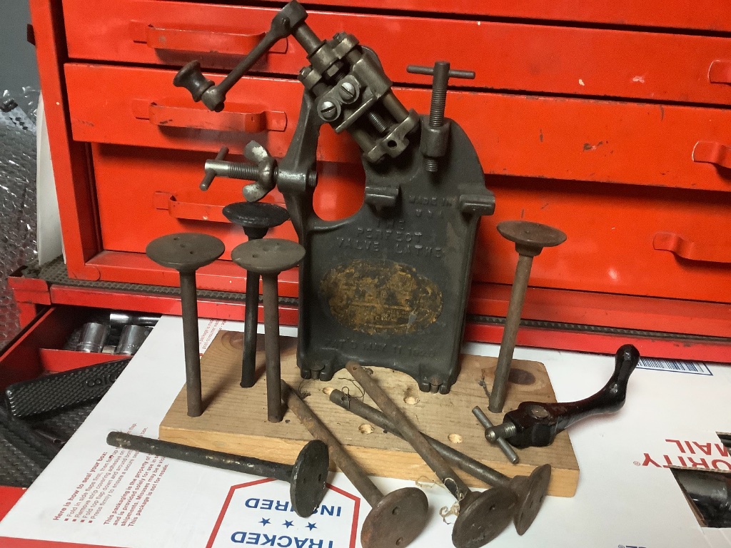

I was given a valve grinding machine a couple weeks ago.It is red in color for what paint is left.it is not quite that rusted but every part is stuck. all the hardware WAS with it but got trashed before my neighbor could save it.
I need to go get the heavy turkey!

JB, Mine has a cover that opens to allow access to the belt. I didn't try, but I'm sure you can install a standard belt. Bill

Bill: Thanks for the pic. jb
