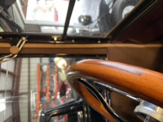

I am redoing some of my coupe's interior in brown. Door panels, kick panels, carpet, and possibly the headliner.
Can anyone spare some pictures of their restored interiors?
My coupe has no windlace/weather stripping. Any reasons I shouldn't add some?
I would like to keep it as "factory" as I can, but I will be doing the work alone and could use some guides.

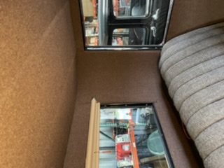

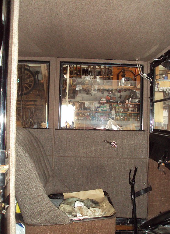

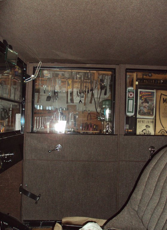

This is the brown kit I put in my Tudor several years ago.
Not knowing, I put the headliner in after the top was on. It was possible but not the best way.

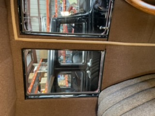

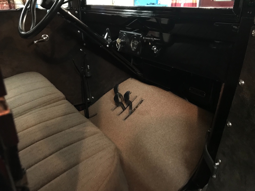

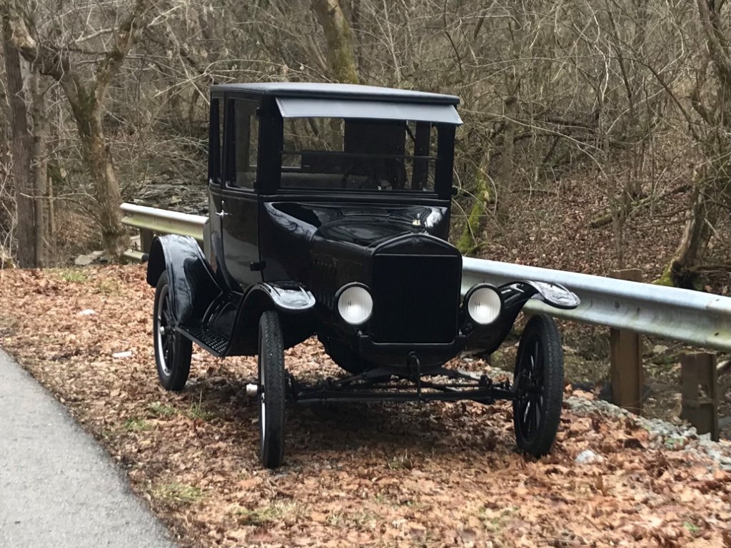

I doubt my ‘25 shown above is correct but that is the way the previous owner had it re-done. No reason I can think of why the seats are gray and everything else brown but it is what it is!😊

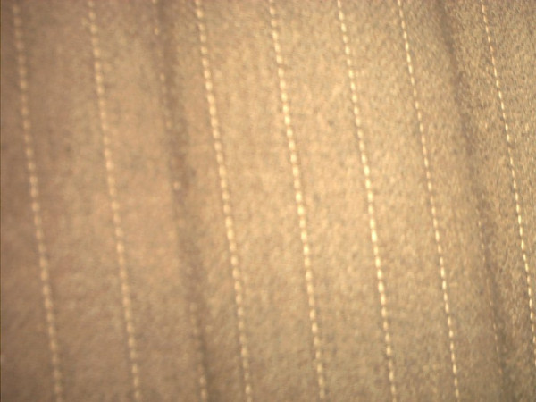

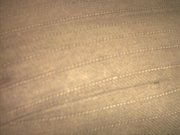

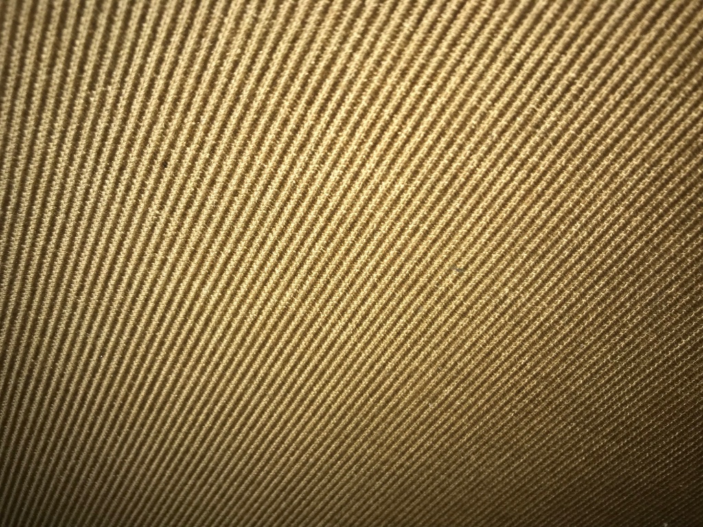

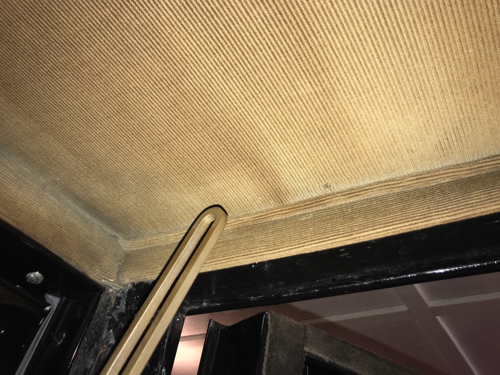

Here is what I am looking at now, I am having a hard time matching material to my headliner. Does it look like it was redone at some point?

I seriously doubt most folks went back to their Ford Dealership when it came time to replace upholstery. Probably went to their local small town furniture upholstery shop and bought any style and color that pleased them. Thus all the off colors and styles from original.

Post by John kuehn » Tue Jan 11, 2022 9:26 pm
https://www.google.com/search?q=caudaro ... ent=safari
Go here and you can see almost the same material and color. Scroll down a bit and you can see it. I think what you have is caudaroy.

Post by Tadpole » Wed Jan 12, 2022 6:36 am
I admit, now that you bring it up it looks and feels like corduroy. I think my best bet is to match it on the upper door panels between and above the windows, then do the rest of the door/side panels in the same pattern as the seats.

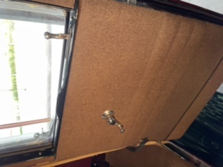

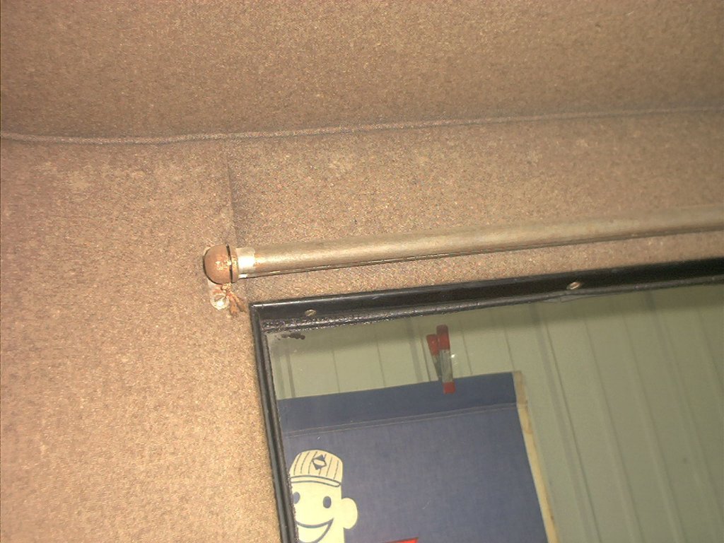

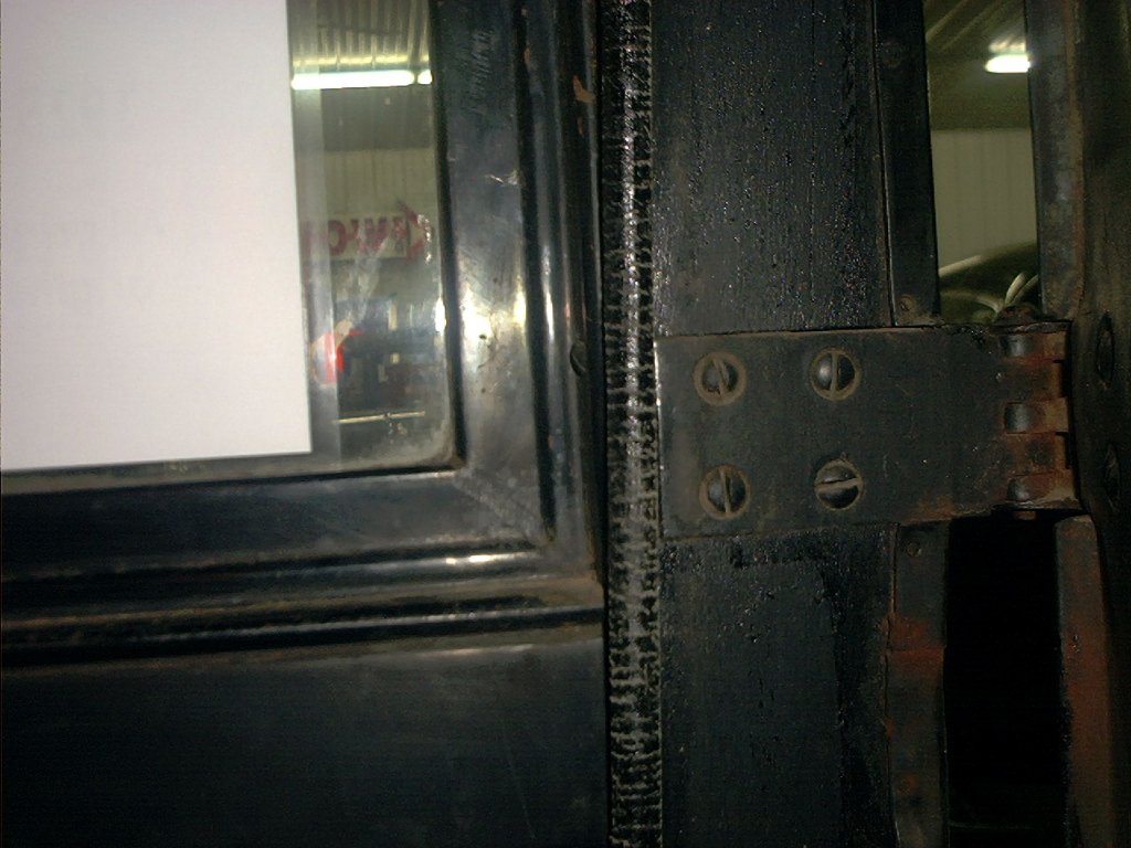

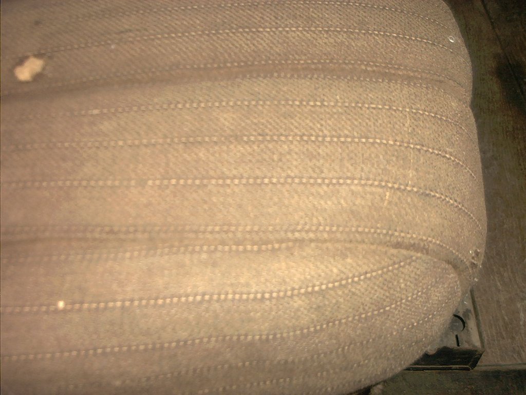

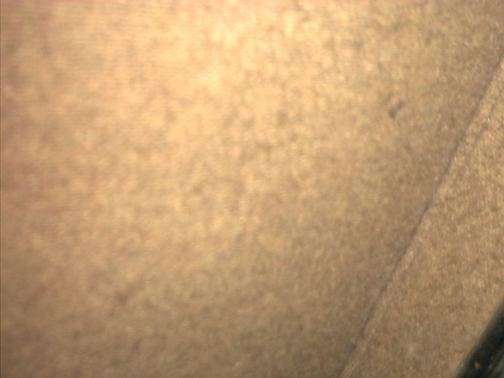

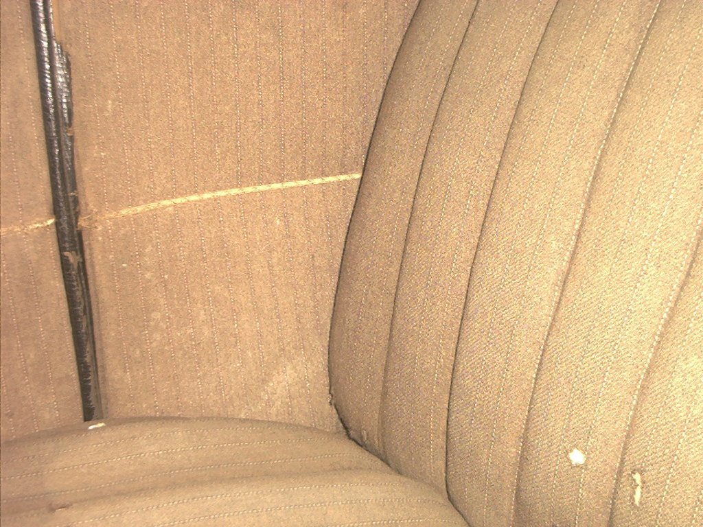

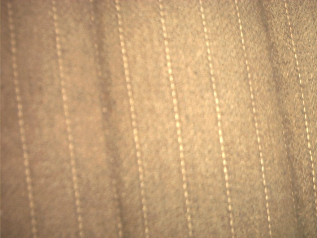

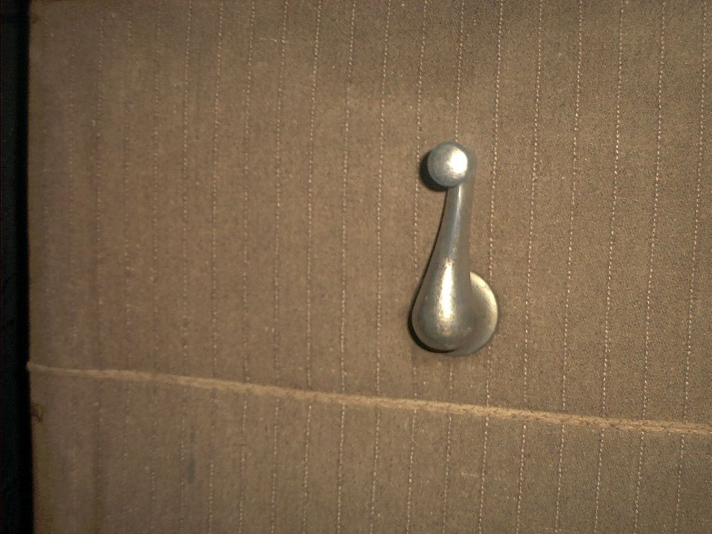

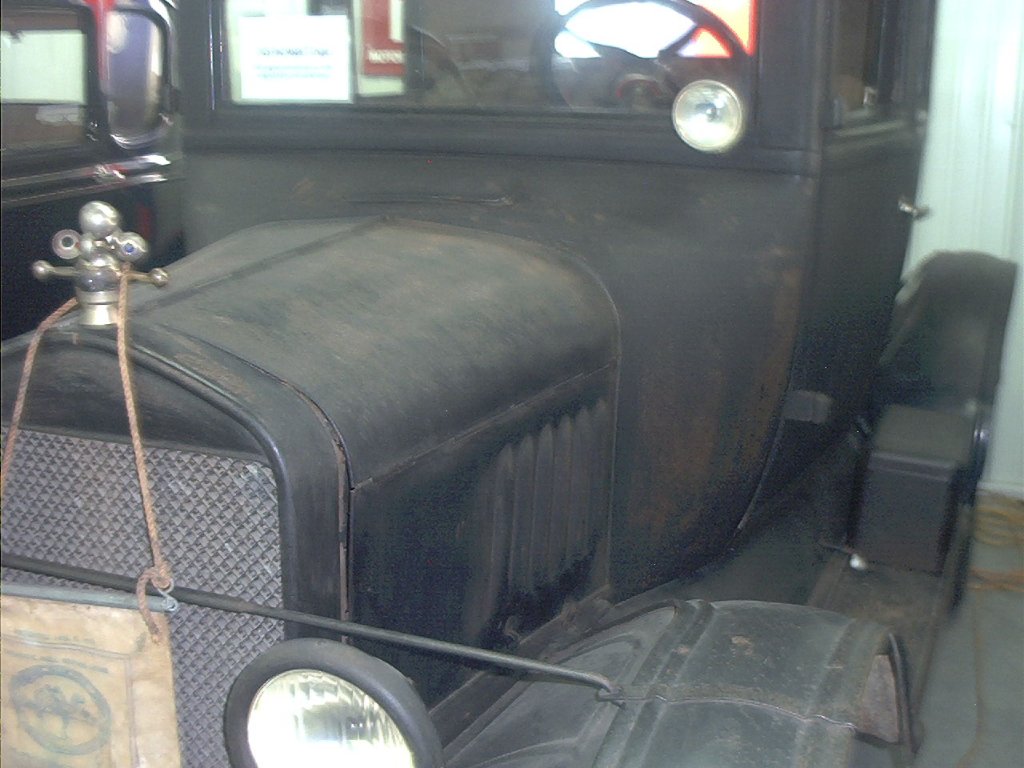

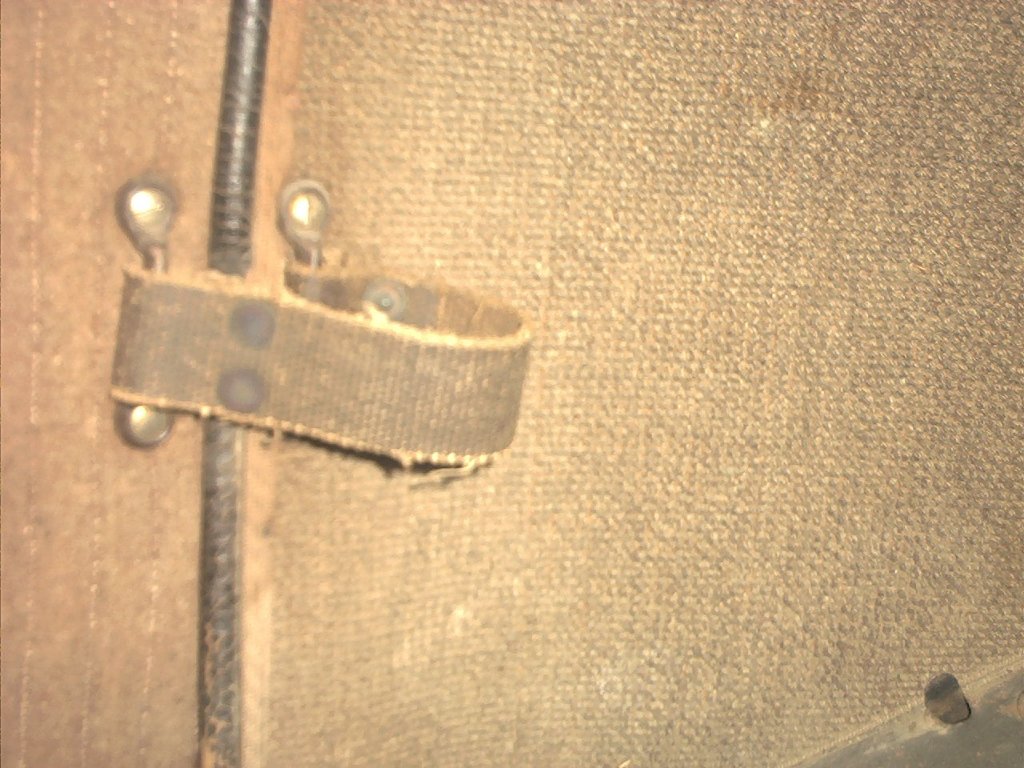

Hi, here are the interior pictures of my original interior. I did not get your PM. I hope this helps, Bob.

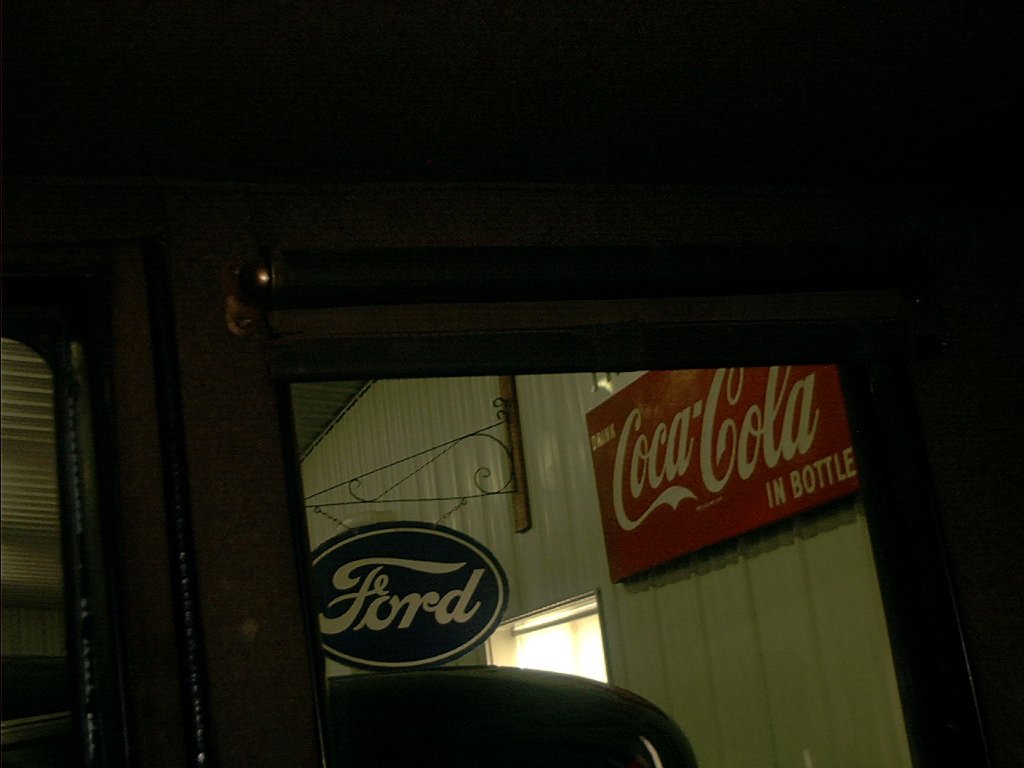

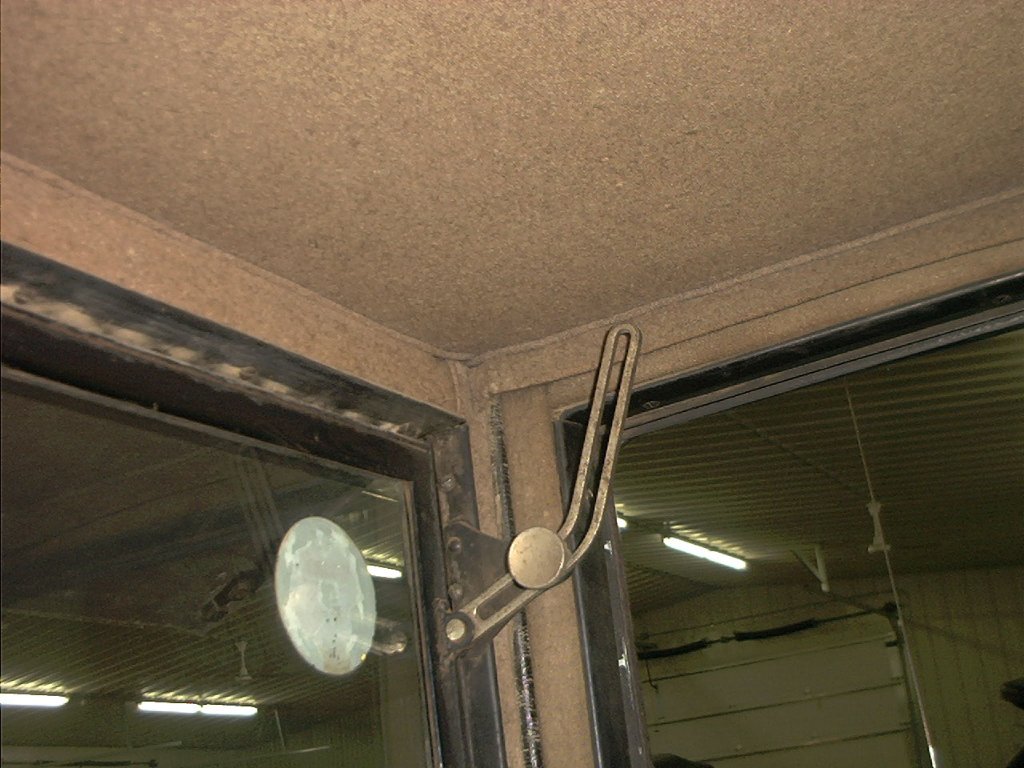

More pictures

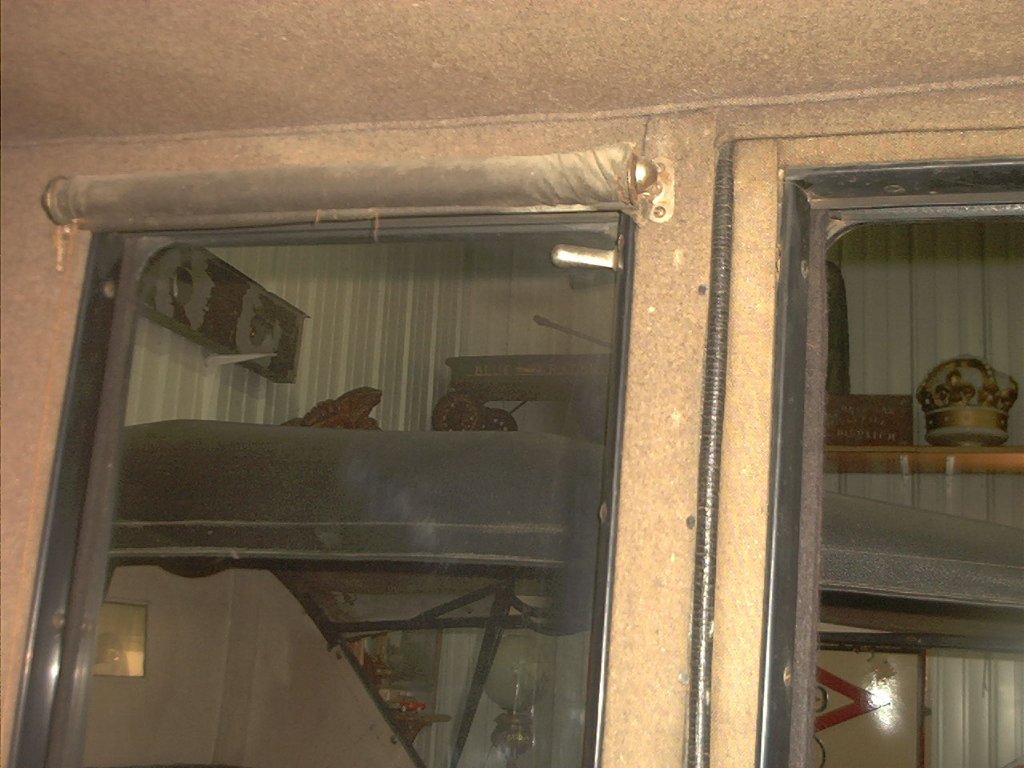

more pictures

A hearty thank you to everyone for the pictures and insight. My headliner is interesting but definitely not original, thank you Bob for the pictures of your time capsule!

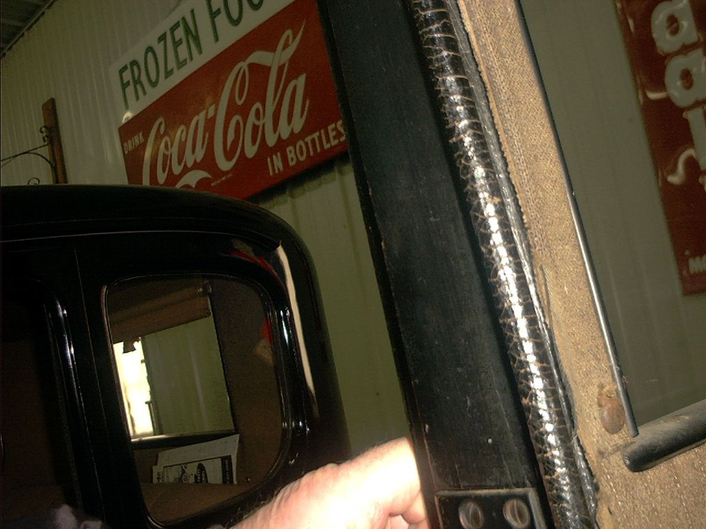

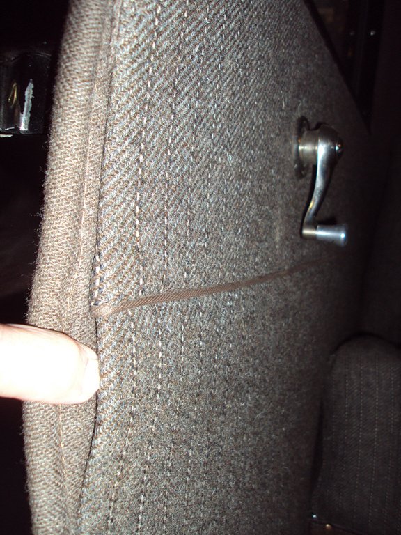

Can anyone spare a photo of where exactly the windlace attaches to the doors?

Post by Rich Eagle » Mon May 02, 2022 4:26 pm
Tad, the windlace attaches to the doorway under the upholstery panels with the panel brads.
