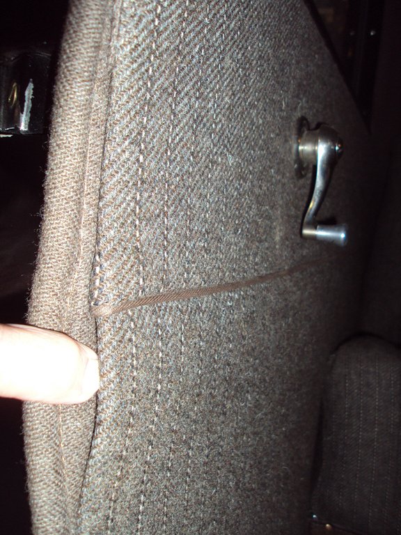

Can anyone spare a photo of where exactly the windlace attaches to the doors?

Tad, the windlace attaches to the doorway under the upholstery panels with the panel brads.
