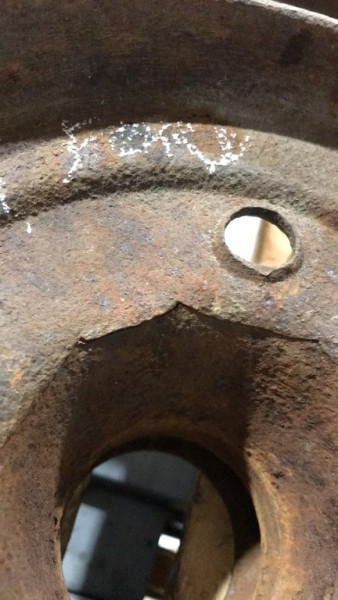

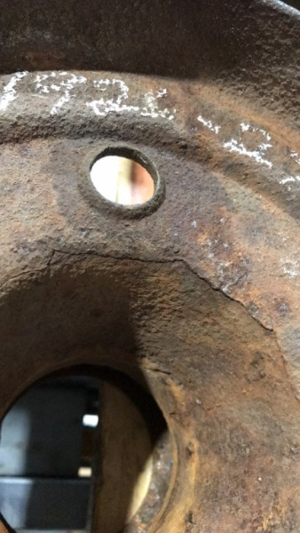

I just purchased a wire wheel from Facebook Marketplace. It has surface rust, nothing very deep. It would make a good wheel, expect for one little fact that the seller neglected to disclose. It has a huge crack all the way around, just inside the bolt holes!
So, now what do I do with it? I'm thinking it might make a decent spare wheel if fixed?
Is this a common failure point, and
has anyone attempted to repair a crack like this?

I would weld it if it was mine

I would look for another wire wheel. That thing doesn't look safe no matter what kind of repair you do to it.

Sand blast around the cracks, grind in the fractures, weld up and mark as spare!

A couple of my wire wheels have been welded. There were a few cracks, maybe 3/4" long. But, that wheel is way too far gone in my opinion. Especially considering that there are still a lot of nice ones out there. Even if you did weld it and was strong enough, I have a hard time believing that it would still run true.

Small cracks, yes. Big large cracks, no.

I have welded or brazed a lot of things, over the years repaired many parts that other people considered unrepairable. But cracks like that in that area? NO WAY! At least not on something that better ones are available.
I would have a tough time justifying that even as a display only spare on a rare car for fear someone years from now would try to use it.
It could be welded, by an expert welder. Properly annealed, a few gussets carefully added so as not to interfere with mounting? But I think the cost unless you personally know someone that would do it for basically free? And frankly, any professional welder would be a fool to charge for a repair like that! Doing for free limits their liability. Why do you think Les Schwab does so many tire repairs for free?

There aren’t many things on your car more safety critical than the wheels. A good one of these sells for about $100. They can be had brand new new for a bunch more than that but what price safety? I have welded up small cracks on them but examples like the one pictured I use for the base of fire pits made with washing machine tubs I sell at swap meets. T chiselers come by freaking out because I did that to a T wire wheel. I tell them I did it because the wheel wasn’t safe and even if it was they wouldn’t give me $40 for it so now it’s a BBQ pit base.

Heavily corroded, thoroughly crystalized.... Yard art ONLY.

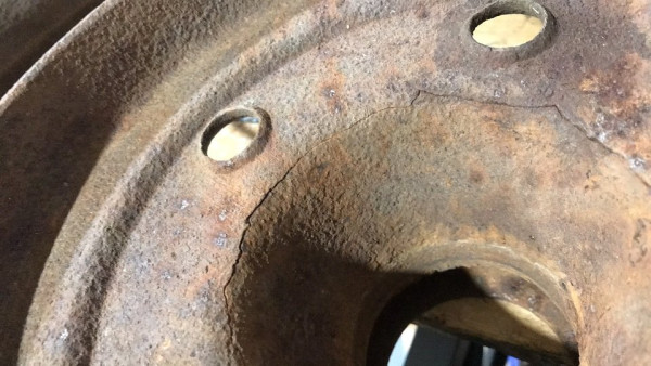

That wheel looks to me like it was mounted on the wrong type of hub and then run to death. It's got a lot of deep corrosion, too.

There is no similarity between hairline cracks and the cracks in that wheel.John kuehn wrote: ↑Thu Feb 24, 2022 12:51 pmI’ll bet there are T’s out there that have similarly hairline crack wheels on them that haven’t been noticed.

No. It's not rare. What is rare is the extent of the crack. Cracks in wire wheel hubs are always something to look out for.

I doubt a professional welder would touch that job. Now if it was the last wire wheel in the world that would be different. It could hold the car up while your wood wheels were being built.
