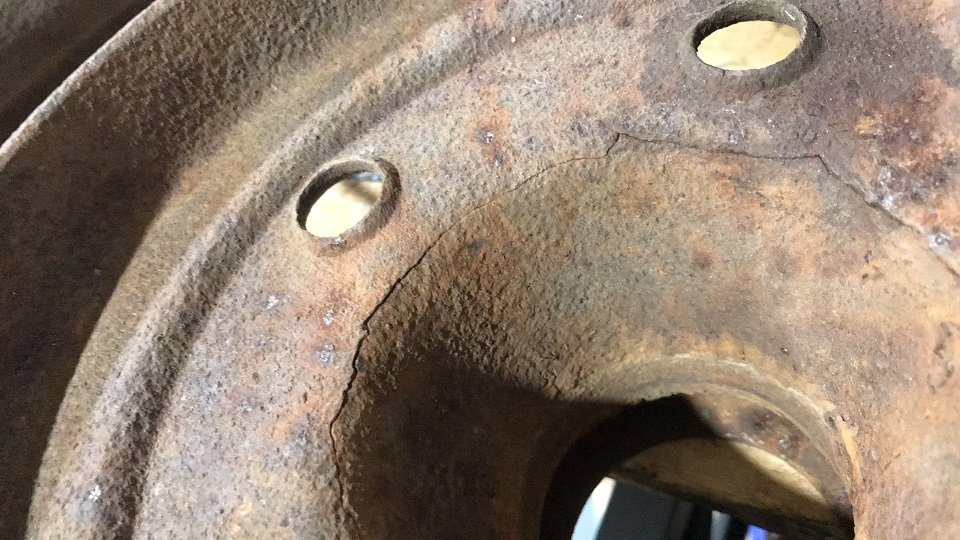

I just purchased a wire wheel from Facebook Marketplace. It has surface rust, nothing very deep. It would make a good wheel, expect for one little fact that the seller neglected to disclose. It has a huge crack all the way around, just inside the bolt holes!
So, now what do I do with it? I'm thinking it might make a decent spare wheel if fixed?
Is this a common failure point, and
has anyone attempted to repair a crack like this?

I would weld it if it was mine

I would look for another wire wheel. That thing doesn't look safe no matter what kind of repair you do to it.

Sand blast around the cracks, grind in the fractures, weld up and mark as spare!
Hank
Hank
- Posts: 4391
Re: Wire Wheel Cracked, Repairable?
A couple of my wire wheels have been welded. There were a few cracks, maybe 3/4" long. But, that wheel is way too far gone in my opinion. Especially considering that there are still a lot of nice ones out there. Even if you did weld it and was strong enough, I have a hard time believing that it would still run true.

Small cracks, yes. Big large cracks, no.

I have welded or brazed a lot of things, over the years repaired many parts that other people considered unrepairable. But cracks like that in that area? NO WAY! At least not on something that better ones are available.
I would have a tough time justifying that even as a display only spare on a rare car for fear someone years from now would try to use it.
It could be welded, by an expert welder. Properly annealed, a few gussets carefully added so as not to interfere with mounting? But I think the cost unless you personally know someone that would do it for basically free? And frankly, any professional welder would be a fool to charge for a repair like that! Doing for free limits their liability. Why do you think Les Schwab does so many tire repairs for free?

There aren’t many things on your car more safety critical than the wheels. A good one of these sells for about $100. They can be had brand new new for a bunch more than that but what price safety? I have welded up small cracks on them but examples like the one pictured I use for the base of fire pits made with washing machine tubs I sell at swap meets. T chiselers come by freaking out because I did that to a T wire wheel. I tell them I did it because the wheel wasn’t safe and even if it was they wouldn’t give me $40 for it so now it’s a BBQ pit base.

Heavily corroded, thoroughly crystalized.... Yard art ONLY.

I’ll bet there are T’s out there that have similarly hairline crack wheels on them that haven’t been noticed. Same things for hairline cracked transmission drums. That wheel was run for a long time before anybody noticed it. It didn’t happen over night.
Is it repairable? For some it is and some it isn’t.

Hi John, The reason that I wouldn't repair that wheel by any means is that 10 years from now, someone could find it and attempt to use it. There are already enough ways to get killed in a Model T without adding another one. If I was going to use that wheel as "yard art," I would do something to prevent it from ever being used - perhaps weld up one of the wheel attaching holes.

EVERYTHING is repairable. BUT, I’ve been on the receiving end of way too much crap like this to be quiet. This one isn’t even a close call. Again, JMHO and a pet peeve, in case anybody wondering.

That wheel looks to me like it was mounted on the wrong type of hub and then run to death. It's got a lot of deep corrosion, too.
- Posts: 4391
There is no similarity between hairline cracks and the cracks in that wheel.John kuehn wrote: ↑Thu Feb 24, 2022 12:51 pmI’ll bet there are T’s out there that have similarly hairline crack wheels on them that haven’t been noticed.
- Posts: 4623
Whether it’s hairline or not there are wheels out there with “cracks” in them. After years and years things begin to happen.

I thought the original question was is this repairable for a “spare”? OK…. To get you home and out of the rain.., yes! Where you live vs freight and availability is the key plus how much money you have. How these threads turn it a war of words is beyond me! stayin’ on the mountain!

Is it repairable?
If it was mine, I would weld it. I have a rim worse than that one that got fixed.
But the very fact that you asked a question tells me "No." Don't fix it.
Mute point anyway since you will probably get your money back.

Look at it this way- WHAT IF the welded wheel were to fail and someone were to get injured or worse, would a billboard lawyer have a good case where he/she could prove neglect against you? Especially if you weld it yourself? I have nothing against lawyers- we need them, but the billboard lawyers are out for a bounty.

You call that "surface rust"??? Looks like deep pitting to me, maybe out here in Callifunny we have a different description of Surface Rust.

While I am not a dare devil, if the wheel were mine, and if the wheel was great in all other aspects (rims not run flat; no deep rust pits in center between rims; spokes straight and not bent or broken), I wouldn't throw it away in the scrap pile. One man's trash is another man's treasure. Several very well respected members have said the wheel is repairable, but with the caveat that it be used as a spare, only to which I agree. If you are not a professional welder, I would certainly have on do the repair. First sandblast the entire rim. Second, the pictures seem to indicate the the cracked center may have moved as the mating surfaces seem to be at different angles and levels. Before welding the hub of the wheel must be perfectly fitted to its original position.Even before welding and after making sure the two broken surfaces are mated properly, the wheel can be bolted to a front hub and spun and checked for straightness. If its off a lot, it might be worthwhile to reconsider welding it. If the wheel has no, or only a small amount of wobble, it can be addressed and straightened after welding. Just mt 2 cents on the matter.

No. It's not rare. What is rare is the extent of the crack. Cracks in wire wheel hubs are always something to look out for.
