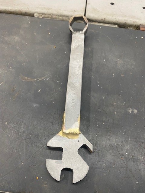

Adjusting the low band is not very convenient, unless you pull the floor out. I made this specifically for adjusting the band, from underneath the car, and I carry it with me in the car's tool kit. The photo pretty much shows it all, no need to go into any great detail about making it. I cut a socket off, and welded it to one end, for loosening the jam nut, the other end pattern of slots allows you to get the wrench on the flats of the adjuster pin no matter what position it is in.

How do you keep the adjustment bolt in place as you tighten the nut? Seems as though it would hard to keep the exact adjustment without two handles on two wrenches.

Oddly enough, I have never had the adjuster bolt move when I tighten the jam nut, on either one of my cars. If your threads are clean, and no one has over-tightened the jam nut an pulled the threads, it won't move. If yours wants to spin when turning the nut, have someone step down hard on the low speed pedal when you are tightening the the jam nut. That will help hold it still.

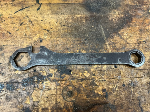

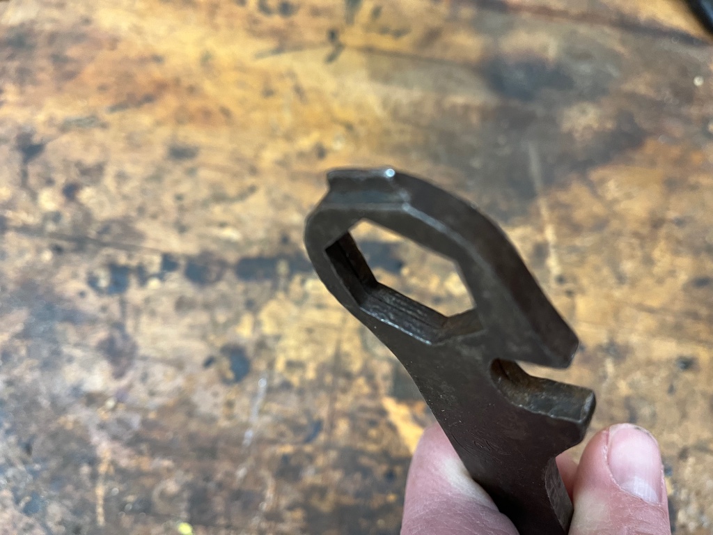

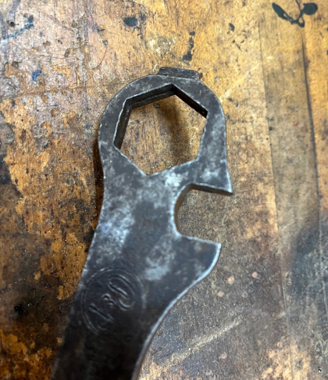

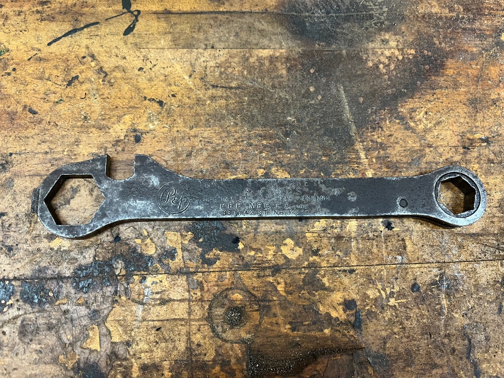

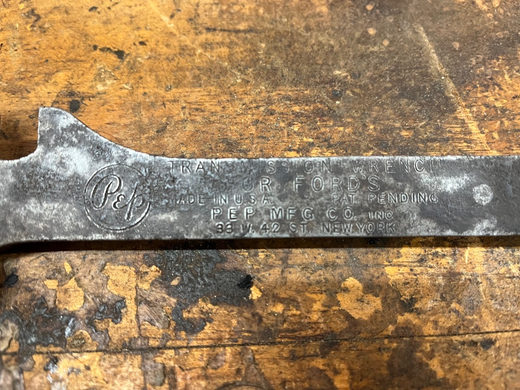

It reminds me of one of my favorite period Model T tools. It is a transmission adjusting wrench made by Pep Manufacturing Co.
The large end fits the low band adjusting screw lock nut, and has a slot that fits the adjusting screw.

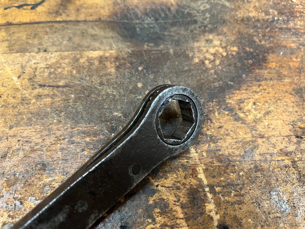

The other end has a ratcheting box end that fits the reverse and brake band nuts.
It even has a screwdriver tip on the end for removing the screws from the transmission cover door.
