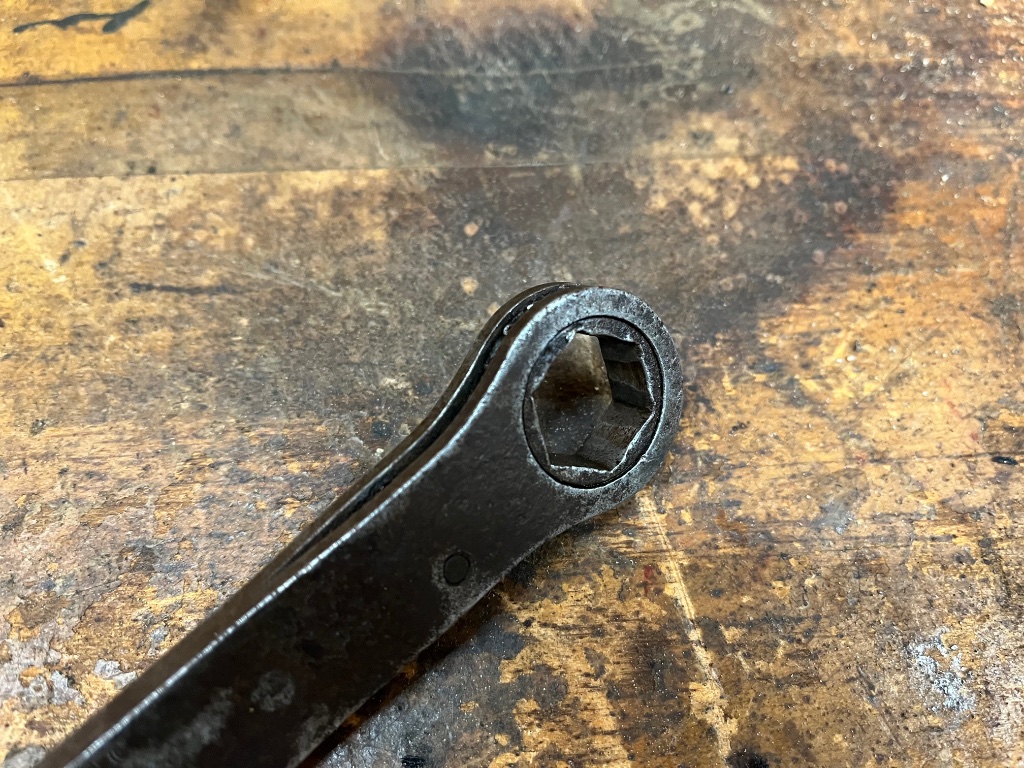

It reminds me of one of my favorite period Model T tools. It is a transmission adjusting wrench made by Pep Manufacturing Co.
The large end fits the low band adjusting screw lock nut, and has a slot that fits the adjusting screw.
The other end has a ratcheting box end that fits the reverse and brake band nuts.
It even has a screwdriver tip on the end for removing the screws from the transmission cover door.
