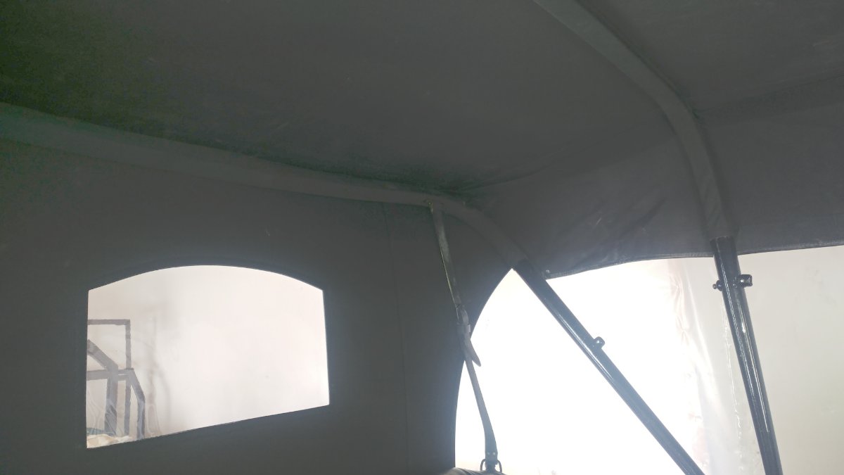

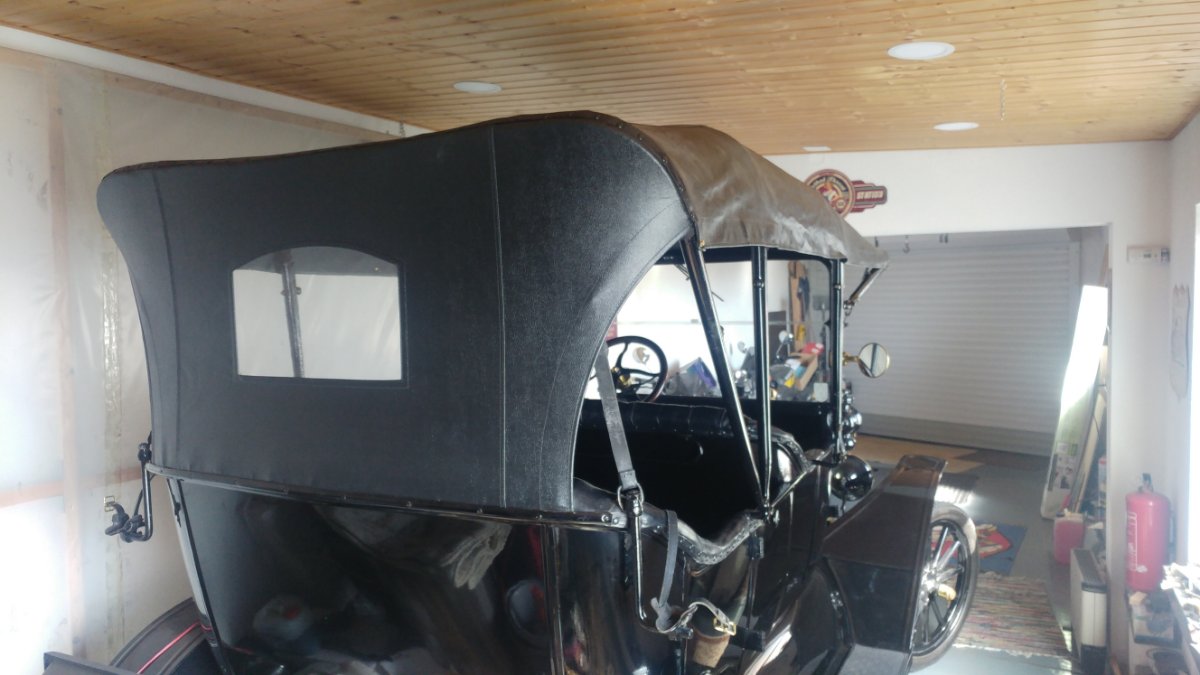

I own a 1916 Touring with Two Man Top. This top and the windshield somehow to not like each other and I want to ask what I can do.

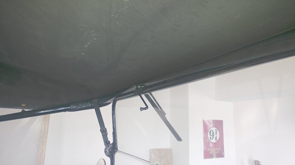

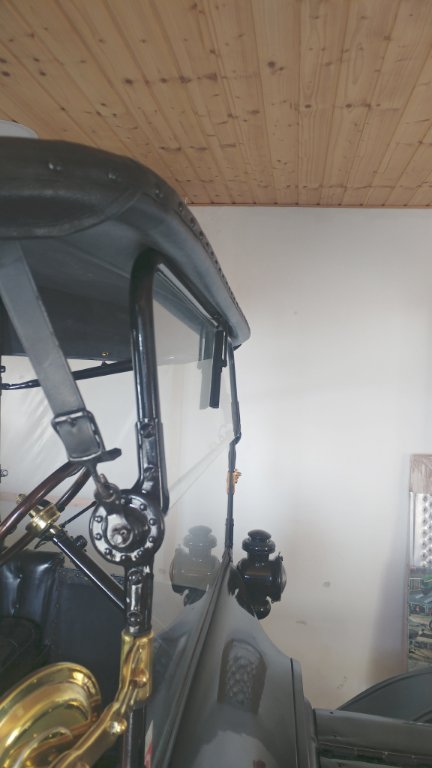

With open car, I have the windshield in uppermost position (vertical). In this position the left and right mechanism has a "snap position". There are absolutely no problems when driving, the windshield stays there.
When I close the top. situation becomes more complicated:
  • I have a clip-on wiper mounted to the windshield frame. This clip has a height of little more than 1/2".
  • With closed top I cannot get the upper windshield into vertical position any more. The windshield collides with top's front bow. So the windshield is in an intermediate position between two lock points.
  • So the windshield permanently moves back to next snap position, this gives a gap of 3" between windshield and soft flap. So much wind gets in there that it blows you the hat from your head. For sure not correct.

Uppermost position of windshield
View from inside to windshield
Rear side of Car Top

Meanwhile I had a long analysis. I checked everything multiple times and I always got the same result:
The former owner (or who restored the top) must have made it too short on rear side. It is perfectly under tension, but it does not allow the steel bows to move sufficiently to the front. This results in what you see on the previous post, the front end of the top does not reach enough over the windshield.
Sadly this is something that cannot be corrected without installing a new top.

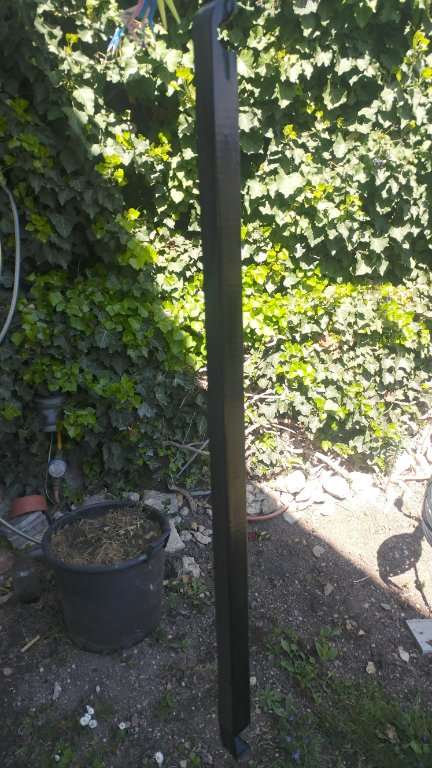

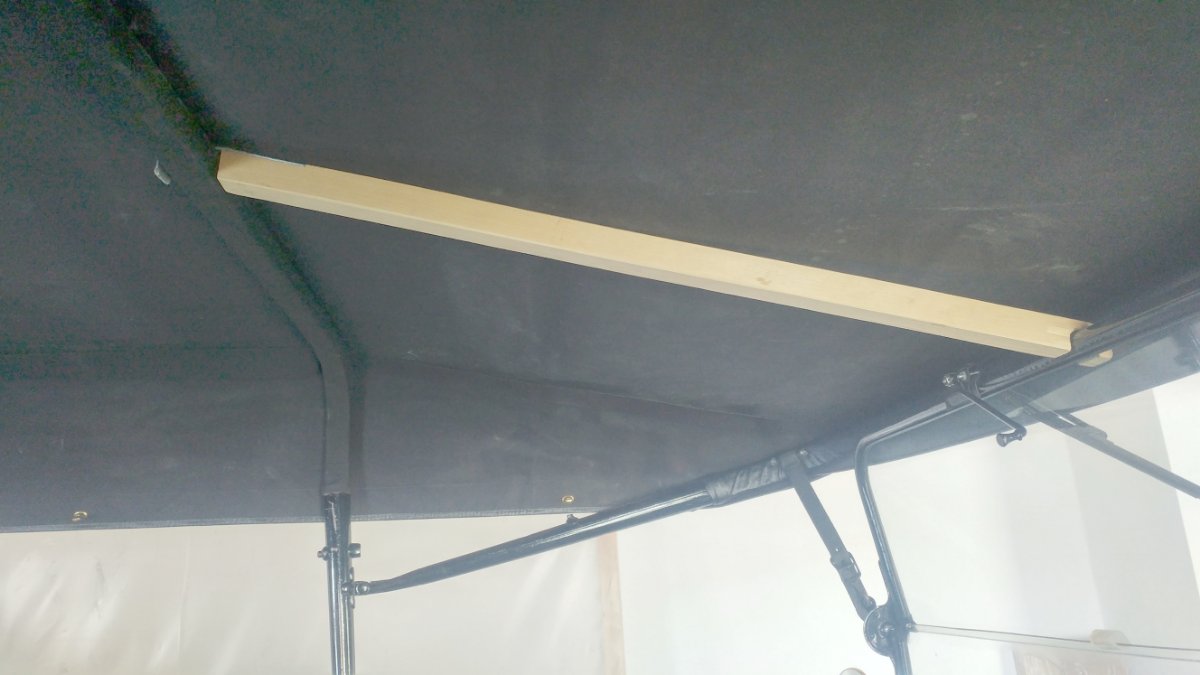

So I had to find a pragmatic solution and I found one:
Situation is: As I cannot do anything with the top, the problem is now the windshield. It cannot go into upright position and the next stable snap-position is too far backwards, therefore I get a gap of 3-4 inches between the soft flap and the windshield. So the top and the windshield act like a funnel and so much air gets in that it blows a hat from your head. I think driving in rain will make no difference to driving without top, so much rain will get in there, too.
So I made a wooden brace (approx. 1x1 inch in square). This brace has a notch at the windshield side (for the windshield frame) and a sheet steel angle on rear side (reaching over the next top bow). All I have to do is hook it in on the first top bow, then push the windshield into right position, and hook it in there with its notch.
Unpainted brace in position (for test fit)
Fresh painted brace
Fresh painted brace
Meanwhile the brace is painted black, so it will not catch your eye any more. (No pictures after install yet, paint has to dry first.)
This way the windshield is in correct position (relative to front end of the top. The soft flap can do its job, too. It is only lifted by the wiper arm a little bit from the glass, but even this will be lots better than before.
I think this is the best solution possible.

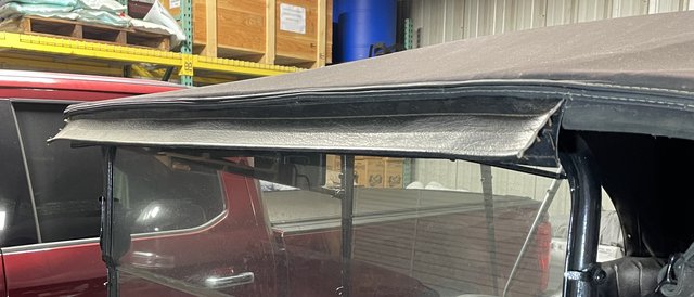

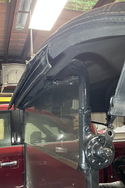

My ‘19 has a double row flap sewn across the front to keep air from entering above the windshield. I do not know if this is standard or a fix by someone in the past. It does fold flat against the windshield at road speeds.

Your top has very bad geometry and the real solution might be to start over from scratch and correctly install new top material or at least install a new rear curtain that is the correct height. Your rear bow is also missing the shim. Your third bow should be vertical, etc.
If you look at the Murray Fahnestock drawing which, according to RV Anderson, has identical measurements to the factory drawing, the first bow should hang over the front of the windshield and the bottom of the bow should line up with the brass channel. The drawing may be viewed here:

Well, I know that renewing the back curtain will solve the position of the entire top. I spent literally two hours to be absolutely sure that 1" of back curtain will move the entire top into correct position.
About the missing shim ... I know where it is -- it is inside a little box on my garage window sill. The screw did not hold, I will need a thicker one to sit well in the steel bow (which appears to have a worn out hole). I think about a Parker Screw which I electroplate first in gold (at least the head), plus drilling up the shim a little bit to fit the thicker screw. I am afraid nothing else will really work.
Starting over from scratch is currently no option to me. This is too much money and the material is almost new. Instead I think about leaving it as-is and adding side curtains in a way that they are not lost when the top needs replacement in many years.
You are absolutely right, the metal frames 2+3 should stand vertical. Now they face backwards approx 2". This is optically not too bad.
The problem with storm flap I could relax by giving the upper half of the windshield a little slant. The wooden brace I made does a good job here. Now the windshield is slanted backwards approx. 1-1/2", this is a position where the storm flap is now in touch with the windshield glass and slightly bent downwards. This appears to be good enough, additional head wind will press it to the glass even more.
