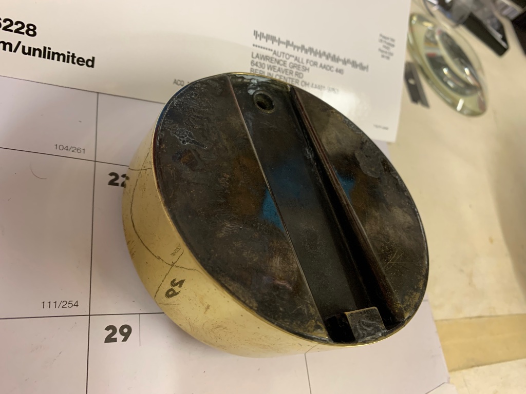

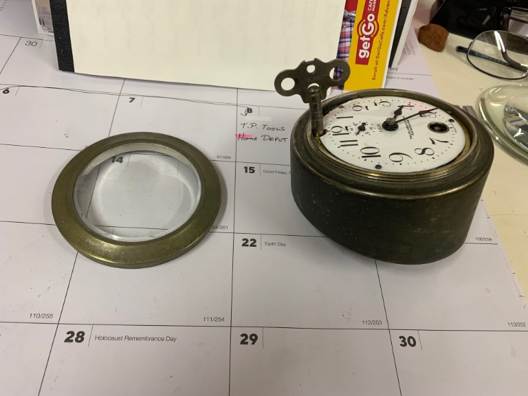

John I have the same clock and can send you a picture of the back of it if you haven’t figured it out yet.

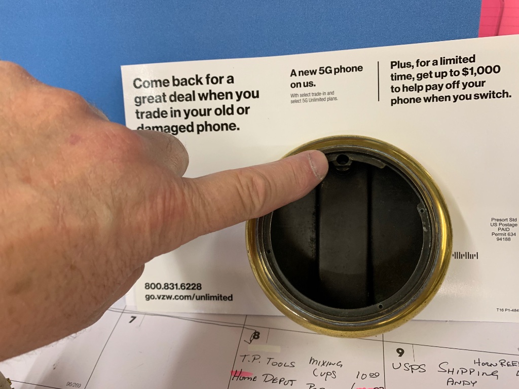

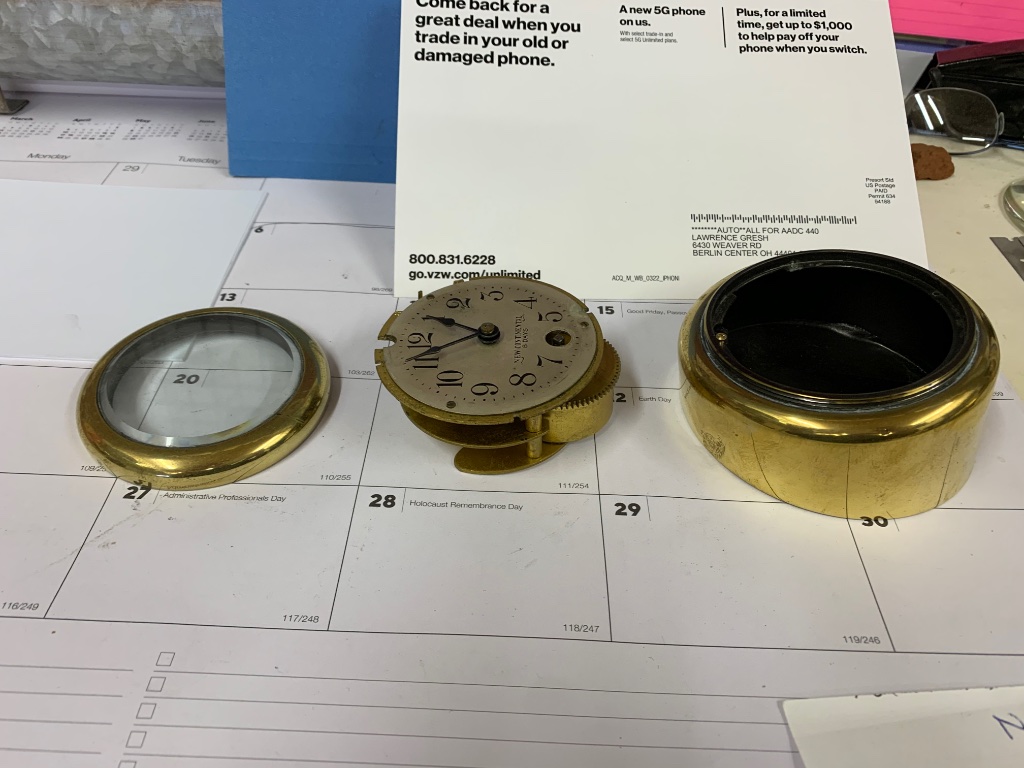

Re: Clock mount question.
Looks like you:
1. turn the bezel off counterclockwise
2Remove the four small brass screws holding the works in the case.
3. Remove the screw at the 12 o’clock position in the case which is probably holding it to the wood. Then push down on the case as it attaches to a clip on the bottom.

Larry, l can’t thank you enough for your explanation and taking the time to photograph your clock! It’s a breeze with your information! Thanks again!! John

Wonderful pics, Larry. Nice accessory clock ! I’m going back in my memory brain, and I had one years ago just like it. I remember now making the mounting strip and the mounting screw before I sold it. I’ll bet originally it had a special mounting screw that would have a square drive, same as the winding stem. It likely would have had a shoulder near the threads of the screw that would have held it to the bracket. I doubt originally you would have had to remove the movement to install. I could see that as problematic for the original buyer. JMHO

You have a good memory! And I think you are right about the screw at the top. I never even thought about that or looked close enough to see that you could access the screw without removing the works since mine is missing that screw.
I hope John sees this as he will not have to remove the works to access that screw. If it is a square head, he will certainly need the key to remove it or a very small socket will work.

Found another one of these clocks sitting on the shelf this afternoon and wanted to confirm what Tim said. The screw has a hex head and the key removes it.
