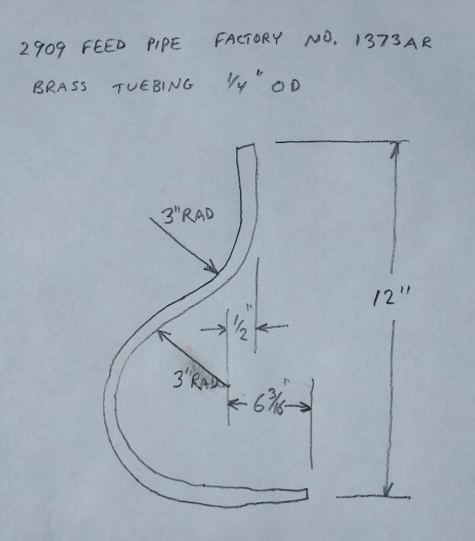

I looked this part up at the Benson Ford Research Center and sketched the shape and dimensions from the drawing. I made my fuel line out of automotive brake line. Do not use soft copper tubing.

I second what Jeff said....also avoid the Copper-Nickel lines - I've seen them do this where they go into the carb or sediment bowl.

Thanks! That's what I was needing. I'll definitely be going with steel! Also.....does anyone still use the felt seal or have you gone to the neoprene one?
