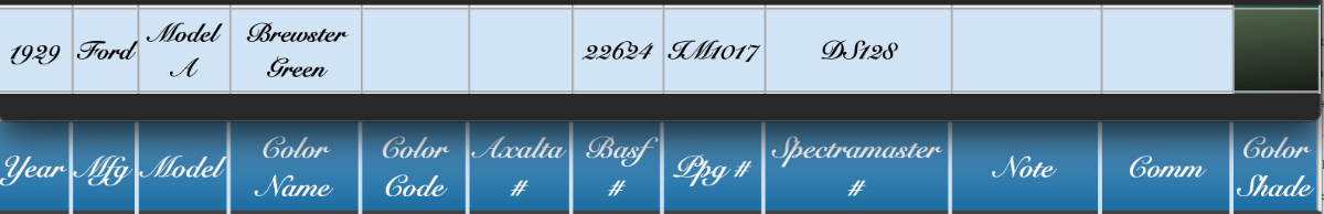

Not sure if it is the same shade as 1909-10, but the Model A people give three choices for Brewster green. The color is a beautiful dark shade.
PPG JM1017 or IM1017 (depending on how the font in the Model A list is interpreted)
Spectramaster DS128
BASF 22624

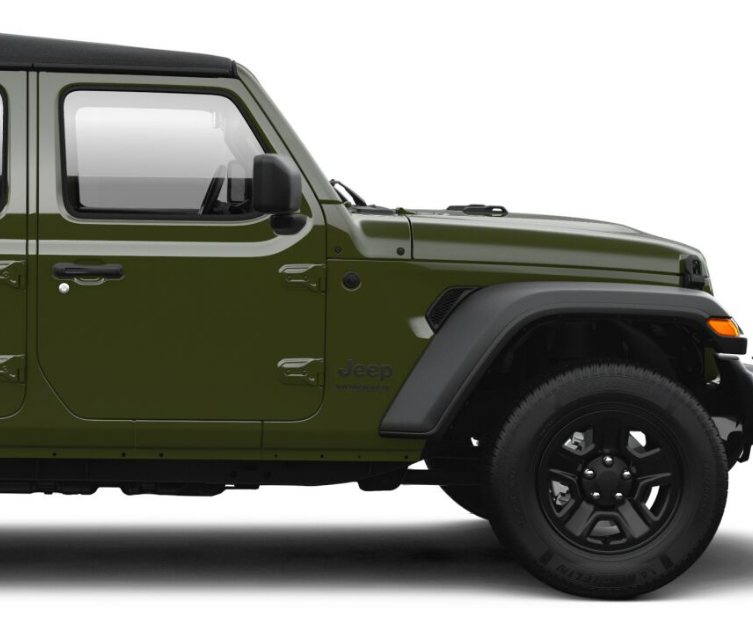

I have recently spotted a few new Jeep Wranglers that seem to have, in my opinion, a really nice Brewster Green paint job. They call it "Sarge Green". Check out the offerings at your local Jeep dealer. It's always nice if you can use a modern color code on a current production vehicle.

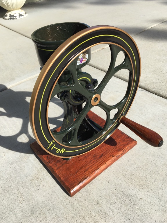

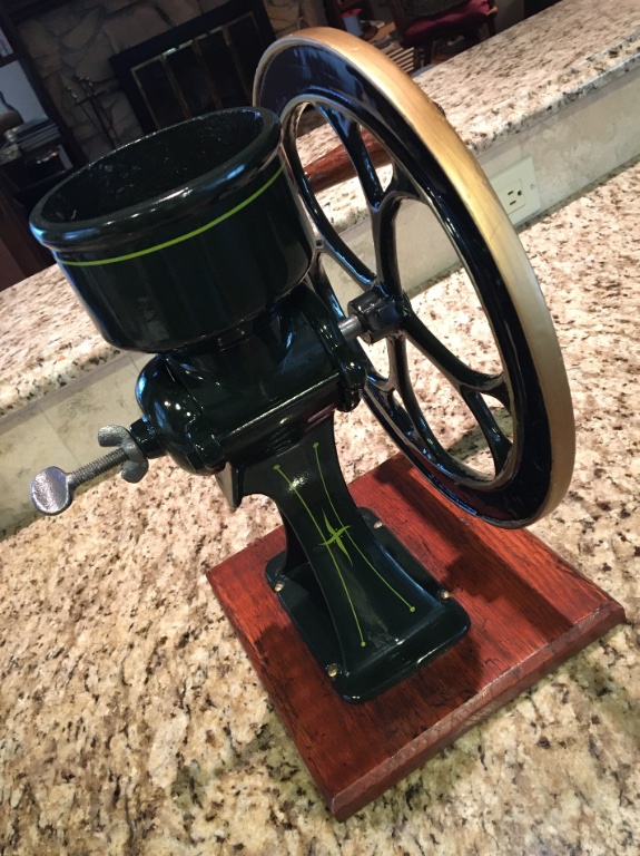

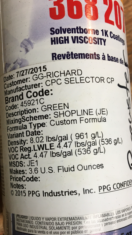

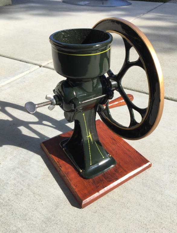

I painted this old mill with Model A Brewster Green. It is an absolutely, positively, gorgeous color. It usually shows very dark in all but direct sunlight. Apple green pinstripes.
The Brewster Green paint code used: #1247
Dal 46=22-49=166-2=346-4=476-17=892-27=1082

Re: Any pictures of Brewster Green Paint for 1909-10
The mill Richard just posted is really good, a beautiful Brewster green.

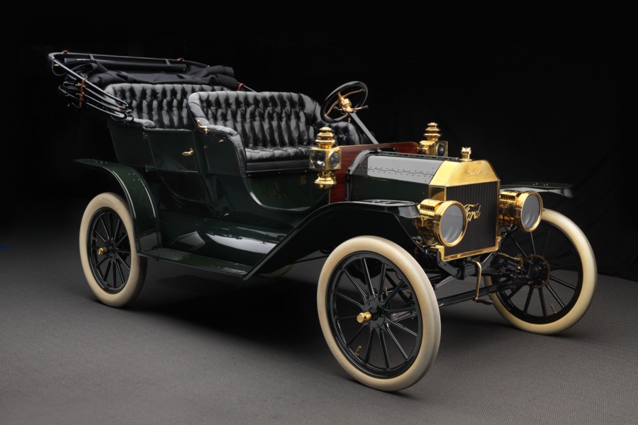

The best image of a car finished like this that I know of is the Rev Institute Ford:
https://revsinstitute.org/the-collectio ... t-touring/
I've seen an original 1910 in a collection that is very close to this, but with Brewster green axles and run gear rather than black. The body and axles on that car were striped vermilion (a warm red) but the wheels had no evidence of striping. Can't recall the fenders. The molding on the body was not picked out with black save for the lower sill on the front seat.
I restored the car pictured in slim howards post. It resides in the colliers museum in naples fl. I used the brewster green formula outlined in the mtfci judging guidelines. I had the old ppg codes converted to the modern equivalent. I was pleased with the results. I agree that railroad coach brewster green is the standard for what this color should look like. This car had excellent original paint and striping under a 1960s era repaint. This color was an excellent match to that as well.
