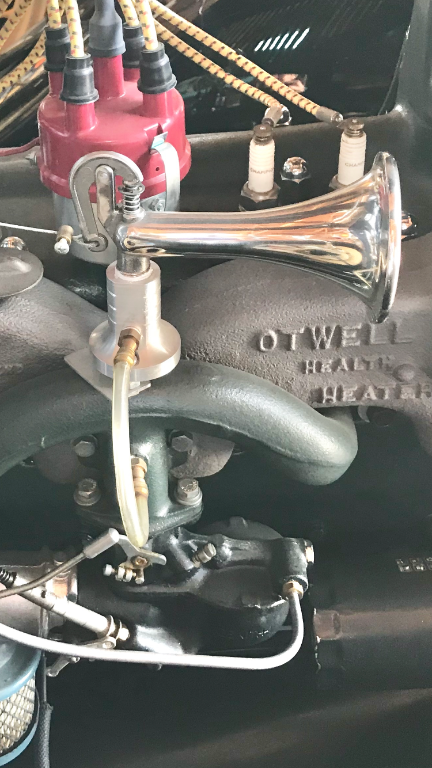

This one is on our A, but same concept.
Wolf whistle A
Wolf whistle A

What is that circled piece that let's it turn 90degrees?

Don’t know where that mount came from. Possibly a marine catalog. It just made the install look better I thought.

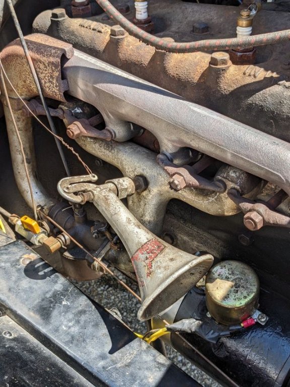

Post by cslandry » Wed Jun 08, 2022 9:17 am
