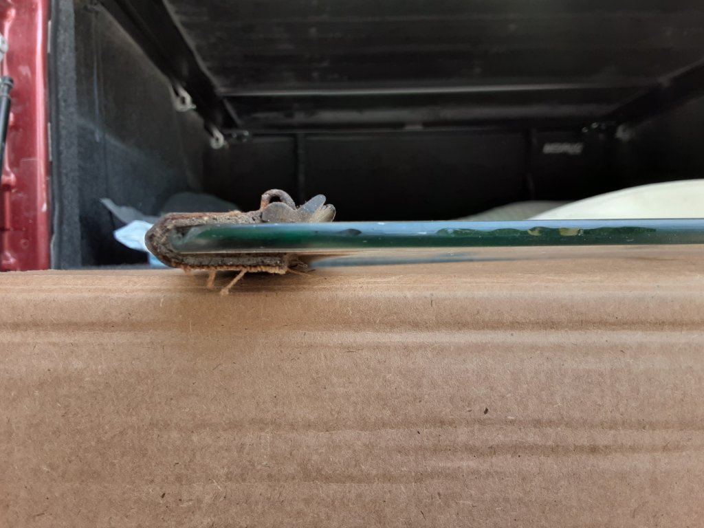

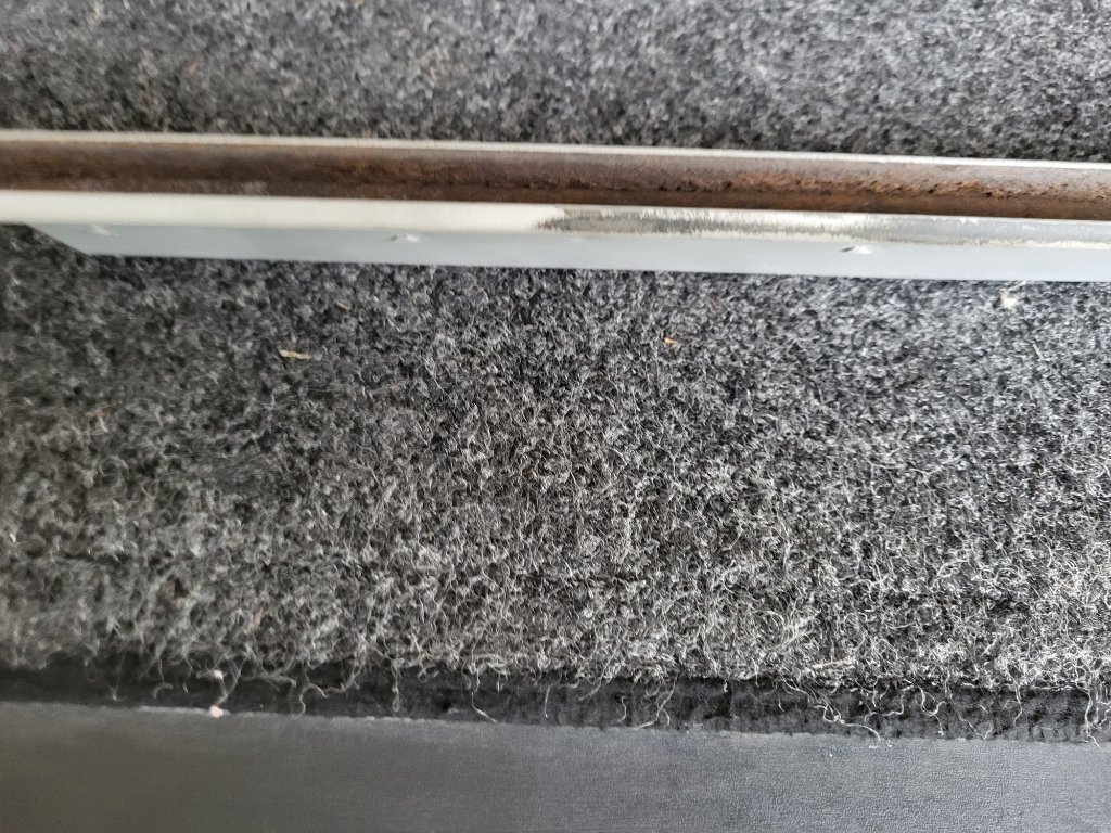

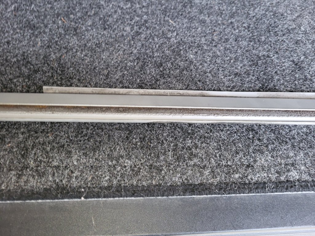

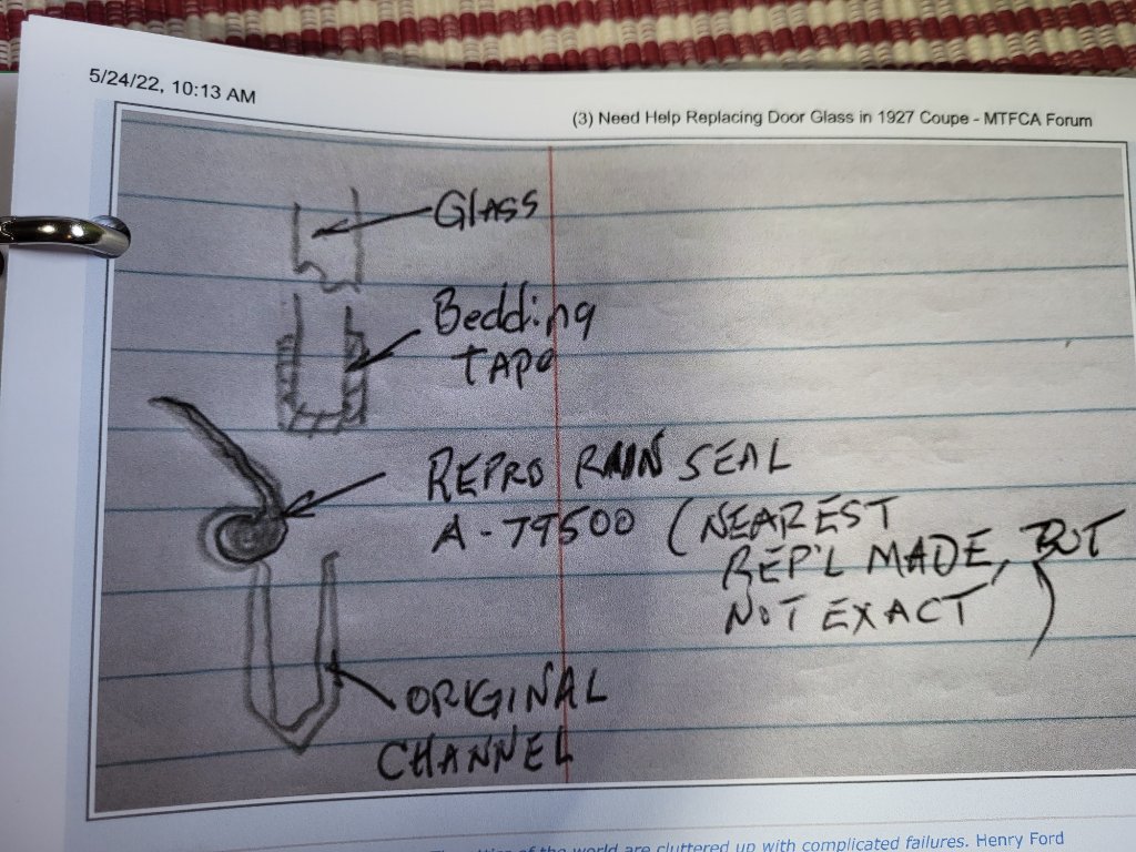

The glass channels shown in the three photos in my May 23 post have been sandblasted as shown in the attached photos. I plan to install the glass into the channels as shown in Dan Treace's February 4 sketch attached, after priming them with Rust-Oleum.
The last photo here shows how the glass was originally installed which is basically what is in Dan's sketch. My question is: What is the proper material to use to bed the glass into the groove?
Is it A-3401-X on page A-199 in Snyder's catalog? Is it 78500FT on page 178 in Lang's catalog? Is it A45963X on Mac's catalog? I am leaning toward Mac's product.
If I use Mac's tape, do I use the 8399A adhesive on page 205 of Lang's catalog?
