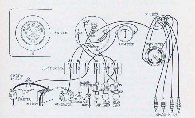

Like Scott says, the forum is great for new owners to learn about their Ts and helps chaps like me to learn more and correct some mis-understood things too. In that spirit, instead of saying why something is wrong, here is an attempt to explain how it is for new owners:
As explained above, the starter circuit is independent from the charging circuit, and starter current does not go near the ammeter or generator wiring.
What MAY cause some confusion is that there is actually a physical interface between the starter and charging circuits. Yes, indeed.
The power comes from the battery to the starter switch by way of the heavy cable.
The wiring for the ammeter 'live' side does go directly right to the battery as shown in the simplified diagrams posted above, but in physical terms, it does so through being connected to the post on the 'live' side' of the starter switch.
While this may appear to connect the starter and charging system physically, in electrical terms, they remain separate. Ford probably used this hook up as it meant only 1 wire had to go right back to the battery, and shortened the ammeter 'live' wire by a couple of feet. That would add up to a lot of wire over the production life of the T. (pennies saved here and there helped lower the price).
Sometimes simplified drawings are good to get an idea across, but should not be relied upon for 'accuracy'. Looking at the above diagram that shows the starter and charging systems, you can see that the starter wires (thick black lines lower left) go from battery to the starter switch to the starter motor and back to ground only. They don't carry current with the charging circuit.
In the drawing you can see where the charging circuit draws its 'live' side from the starter switch 'live' post, which is in electrical terms is the same as carrying the wire right to the battery even though in physical terms it shares a common live cable with the starter - ONLY as far as the starter switch. Pushing the starter switch does not affect the circuit to the generator in any way, nor can the generator circuit affect the starter in any way.
Hope this is helpful to anyone not familiar with the topic..
As an afterthought, if you want to install a fuse in the T wiring, then the ammeter lead from the starter switch to the 'live' side of the ammeter is the place to do so, as it covers the complete electrical system with one fuse (except the starter!). You can put the fuse near the starter switch so it can be easily got to under the floor board.
