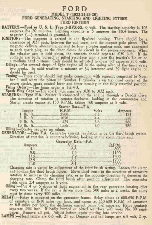

The article cited is a good read for background knowledge and it presents correct information in a straight-forward manner. While the principles are applicable, some important 'details' are different in the Model T. Model T is (-) ground with 3rd brush grounded inside the generator (the top figure) but with (-) battery ground.
Note that in the mtfca Electrical System handbook (pg 17-18), reference is made to a generator circuit modification that allows the driver to vary generator output by varying the resistance in the 3rd brush connection. The mtfca author suggests installing a 25W, 25 Ohm Potentiometer in the 3rd brush circuit to permit adjusting charging rate externally, without adjusting the position of the 3rd brush. This modification replaces the 'light switch' resistor circuit shown in the bottom figure, with a variable resistor (rheostat). I'm not recommending such a modification, would NEVER do it to my T, just reporting. YMMV, jb

Post by John kuehn » Sat Jun 18, 2022 4:28 pm
My 54 NAA Ford tractor is a positive ground system sort of what is being shown.
Model T’s have a negative grounded system like is mentioned in the article.
It would be a good idea to read the Ford brochure that in the post that states Model T’s have a negative grounded system. When in doubt always read the instructions.
