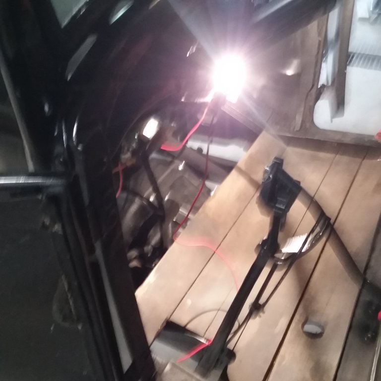

Along with everything else, (clearly I should have picked a T in better shape) I think the generator is bad and so is the magneto. The other day I turned the lights on and the Amps Gauge dropped as it should, but no amount of revving brought it back to ‘0’. I also tried running the engine on magneto and it quickly died. I thought for sure it ran on it before. Did they just go bad one day? I haven’t ran a test on it yet, though.

It's as likely that your generator cutout is bad, or the wiring, as the generator itself. As for the magneto, The same is true as far as wiring, and there could also be a problem at the magneto post. Since it at least appeared to run on both magneto and battery recently, as I recall, I'd check the wiring and perhaps the ignition switch. First of all, I'd fully charge the battery, then look the wiring over. It should not be necessary to rev the engine beyond a fast idle to tell if the generator or magneto is working.

Could be a number of things. First unless you have the 3rd brush set up to 6-8 amps your generator probably won’t go to 0 with bright lights on. If lights are off does it show a positive amperage? If so it’s probably ok just not set high enough. Magneto not working- could be as simple as a bad contact in the switch or lent on the point of the magneto post. Address those things first before further steps. I’m sure others will have better solutions. Best John

As I’m thinking about it, it never shows a charge, but the battery always cranks the starter easy.

The ammeter may be bad or hooked up backward. If the battery is staying charged, it suggests that the generator is working, more or less, assuming you've started the car a good number of times without charging the battery. Failing to run on magneto could easily be a switch or wiring issue, or a problem at the mag post contact.

Make up a test bulb rig using a headlight socket and an 1156 bulb. One lead to mag post. One lead to ground. The bulb should light just by cranking the motor over. It should glow brightly at idle. And glow brilliantly at at very fast idle, to a point where the bulb burns out.

Notice the ammeter needle location @ rest. Start it up, vary the rpms. Does the needle move? If so The generator does. If it moves negative with higher rpms, the ammeter is wired back wards. Check generator output @ the gen terminal with an analog volt meter. You should read voltage running. If not gen is dead. If so run a wire from the gen output terminal to ground to potentially keep it from damaging itself further.

Hopefully you haven't changed anything with the wiring. If you accidently hook a hot wire from the generator to the magneto post, you will ground the generator and at the same time de-magnetize the magneto. It could also be a problem with the ignition switch. One side goes to the ammeter and the other side goes to the magneto. When you turn on the key to the left it should connect to the battery, and if you turn it to the right it would connect to the magneto. If somehow you have it wired wrong, or if there is a problem with the switch, it could accidentally connect the battery to the magneto.
So check it all out carefully.
