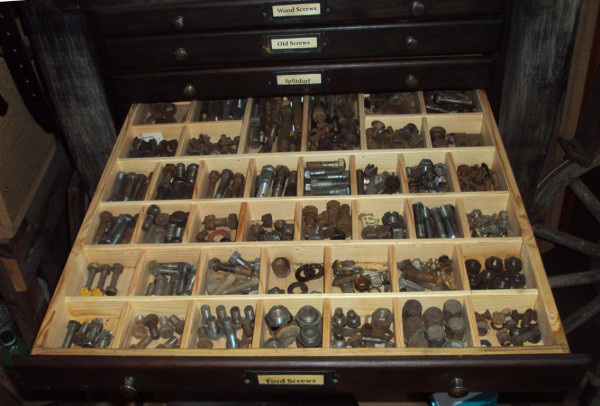

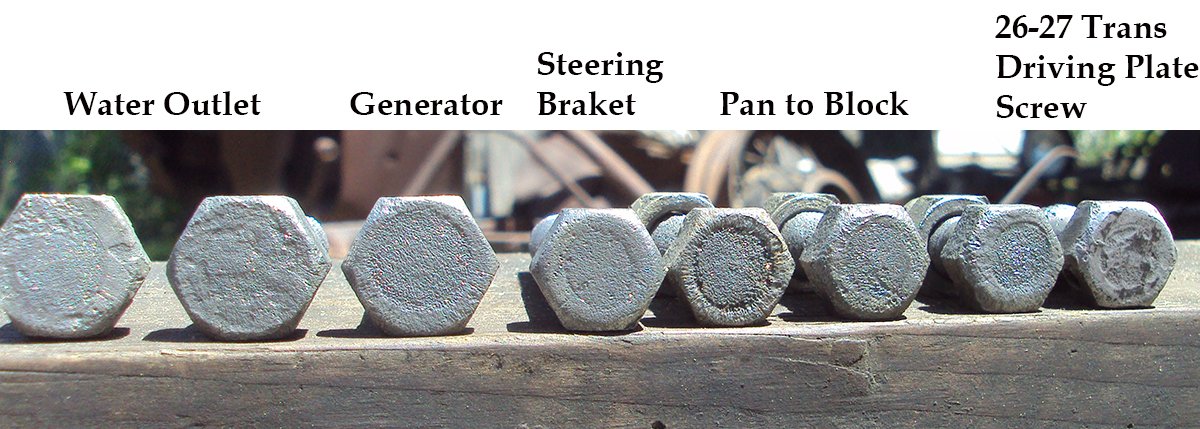

Cap screw heads that is. The trouble with cleaning parts hour after hour is that my mind wanders to the land of Oz, Kalamity Dick and questions about how the parts were made and when. Many of the Ford bolts in this batch appear to be from one car and have a round depression in the middle of the head. I have other original Ford bolts without that depression and a few that do. While this may not be an important detail to most, I still wonder what era or plant these might be from. Was the depression part of forming the head of the bolt? Have others noticed bolts like this or know what era they were used?
I have found cleaning bolts and building drawers for them a pleasant past time. Perhaps studying the differences in the bolt shapes and dimensions is too trivial but these things do cross my mind.

Here's my take on it. I believe that when the bolt head was formed, it created a grain flow that, when exposed to corrosion, created a unique pattern on the top face. Even before corrosion, there may have been a slight concavity inherent to the forming process. Extra force may have been exerted in the center area to force material to flow outward, into the forming die. The process is called "cold heading".

Something that an artist with an eye for detail would notice.

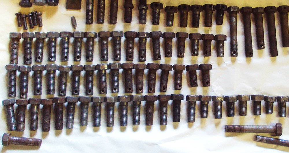

While the grandkids were in the pool I measured some 3/8-24 High head bolts. These are used to hold the block and transmission cover to the crankcase, front fender brackets, muffler and engine rear brackets to the frame. Also the steering bracket.
The heads height varied from .270 to .307 mostly .281 to .292. and 9/16 hex. An exception is the generator bolts which are .189 thk and 5/8 hex. There may be exceptions in earlier years, I don't know. Lengths from bottom of head to end were 1.34, 1.15, 1.08, .96 and .70 for ones drilled at the end of the shank. Some suppliers sell them in even lengths. I believe the longest of these would be for a 26-27 with the crankcase corner reinforcement brackets. 1.15 used for most block and trans cover to pan locations. As time permits I'll try to nail down the other lengths. The one through the steering bracket and wooden block is about 2 1/4 long and the rear engine mount through the wood block is a bit shorter.

That drawer idea is great. I only wish I had that amount of room. I've been collecting bolts since I was in my teens, so as to have enough for the future.

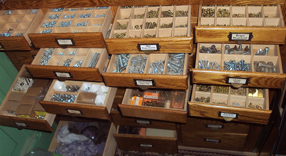

I'm sure I have saved as much time looking for bolts as it took to build the 50 or 60 drawers to put them in. I have saved a hundred trips to the hardware store to buy a little screw in a package for $3. Besides I like to work with wood. If I use 1% of the bolts I have sorted out it will have been worth while. All we can do is try.

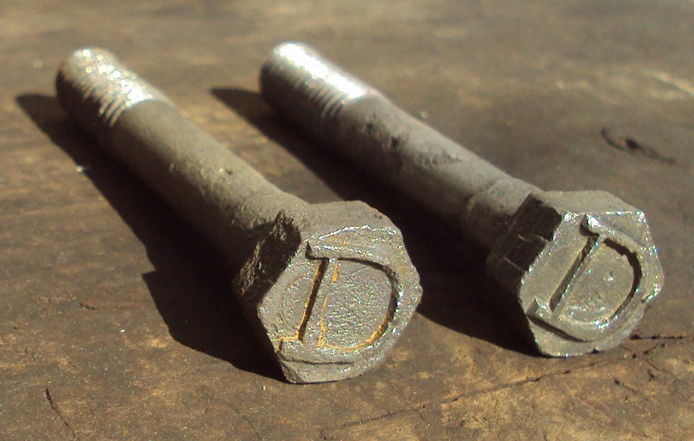

Speaking of which, can anyone tell me what these 3/8-16 x 2 5/8 bolts would have gone to? Is it a 'D' or an 'A' on the head?
More handy drawers. Plus, you can pull out a couple drawers, put a board across them and use it for another work bench.
