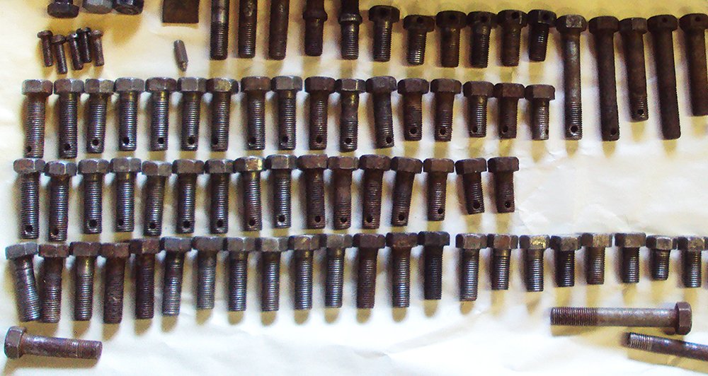

While the grandkids were in the pool I measured some 3/8-24 High head bolts. These are used to hold the block and transmission cover to the crankcase, front fender brackets, muffler and engine rear brackets to the frame. Also the steering bracket.
The heads height varied from .270 to .307 mostly .281 to .292. and 9/16 hex. An exception is the generator bolts which are .189 thk and 5/8 hex. There may be exceptions in earlier years, I don't know. Lengths from bottom of head to end were 1.34, 1.15, 1.08, .96 and .70 for ones drilled at the end of the shank. Some suppliers sell them in even lengths. I believe the longest of these would be for a 26-27 with the crankcase corner reinforcement brackets. 1.15 used for most block and trans cover to pan locations. As time permits I'll try to nail down the other lengths. The one through the steering bracket and wooden block is about 2 1/4 long and the rear engine mount through the wood block is a bit shorter.
