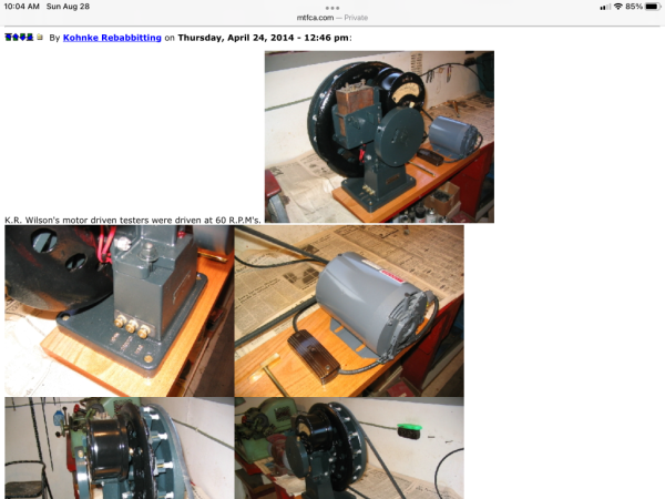

Bob.. I miss him too.. I believe he was noted saying hand crank coil tester should not be faster than 80 revolutions per minute.... the same speed as a Edison diamond disc record.

The main advantage of the constant speed voltage is the points can be more accurately set to have the spark happen at the same voltage level and time for a smoother running engine.
You can start slowly cranking an HCCT while watching the voltage meter, if there is one, and slowly increase the speed until sparks appear.
You will notice sparks will happen at 2 AC Volts on some coils and up to 4 or 4 1/2 AC Volts on other coils.
The points can be adjusted to make them all happen at the same voltage level.
The coils that spark at the lower level are great for hand crank early Model Ts to start easier.

James..... HCCT's set coil output in amps..... 1.3 steady average..... Rare testing units have an ampmeter and a/c voltage meters. Turning a HCCT at 80 rpms may produce 2 to 4 volts ac., and will activate coil function enough to set points for 1.3 amp function.

Robert, you got part of the picture correct.
The voltage required to set the 1.3 amps can vary from 2 to 4.5 volts.
That also determines when the spark happens and a different piston position when that spark does happen.

James.., coils are set by AMPERAGE....., not voltage, on a hand cranked coil tester with magnets and a coil ring as used in the engine . Spark is determined by the position of the commutator and is adjusted by lengthening or shortening the control rod.
