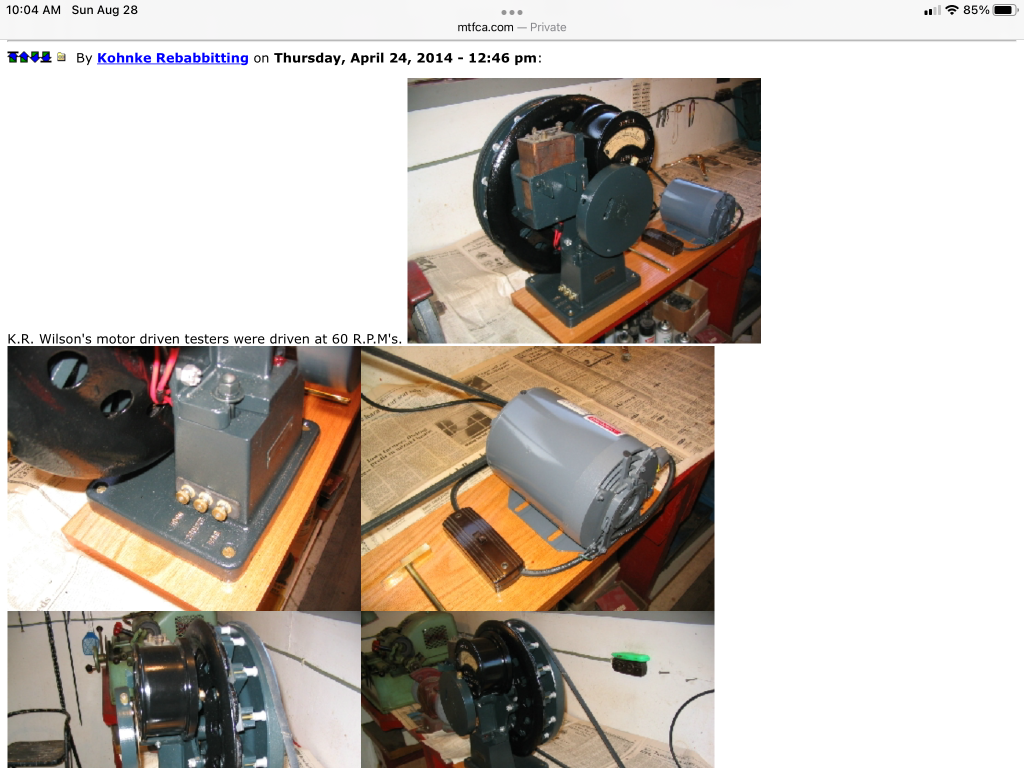

Post by BobShirleyAtlantaTx » Sun Aug 28, 2022 11:09 am
Herm posted ;
. Sure miss the Old Grump, he was wonderful asset to the hobby.
