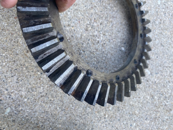

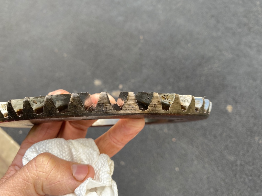

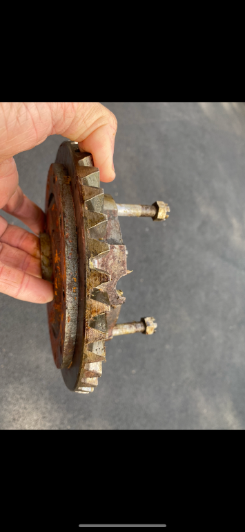

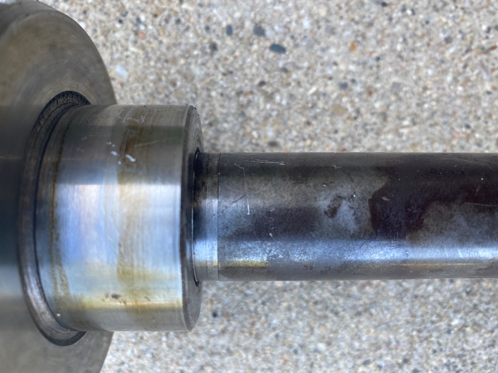

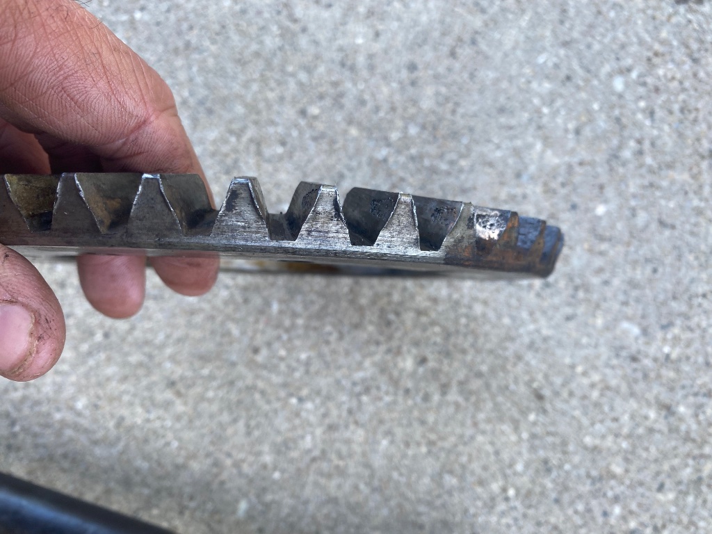

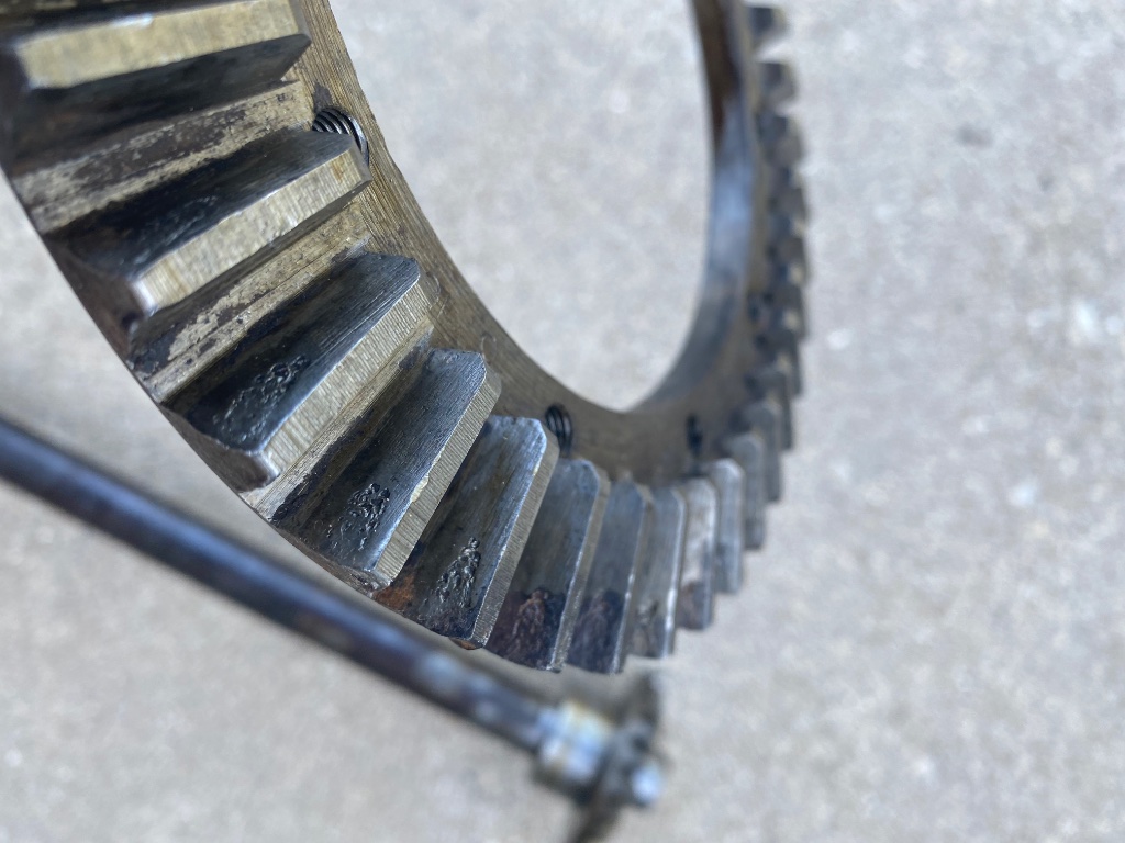

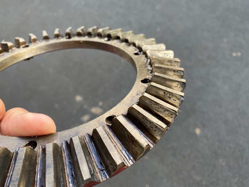

Have a speedster build and tearing apart a rear axle I’ve got. Looking for input on whether new ring and pinion is warranted. Also I see some wear on axle, Babbitt thrust washer was broken when I tore apart so assuming it caused the wear?
Posts: 8433
Re: Time for new ring and pinion?
Post by TXGOAT2 » Sun Sep 18, 2022 10:20 pm
That ring & pinion need replaced. All other parts need to be carefully checked. The gears have been shedding metal particles, and all metal debris needs to be cleaned out of the housings.
Post by speedytinc » Sun Sep 18, 2022 10:39 pm
The wear on the axle doesnt bother me if the bearing surface is close to standard. 1.062". measure the gear & differential housing for wear. You should see 1.807" & 1.812" respectively if not worn.
I would also change the gears. Do it right one time.

Posts: 7139
Post by Allan » Mon Sep 19, 2022 6:54 am
The wear in that crown wheel indicates that there was too much backlash, possibly contributed to by the failing thrust washer. The gears need TO BE replaced.

Posts: 4393
Post by Jerry VanOoteghem » Mon Sep 19, 2022 12:02 pm
Not sure how you're able to determine excessive backlash from that wear pattern. What I see, is evidence of a poorly aligned ring & pinion gear, regardless of what the backlash condition might have been. Honestly, if it were re-used, with a proper mesh adjustment, that gear would probably be fine. I say that however without seeing a picture of the pinion gear. That's only if you need to save some $$$ however. Since you've got everything apart right now, it would the right time to use new gears.

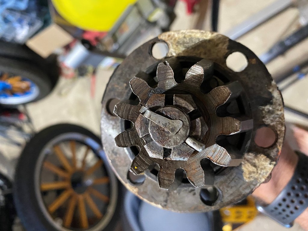

Post by pedechad » Mon Sep 19, 2022 4:10 pm

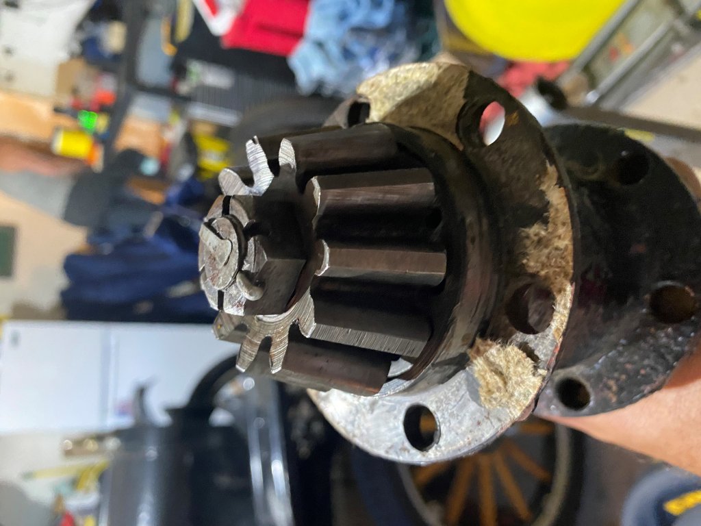

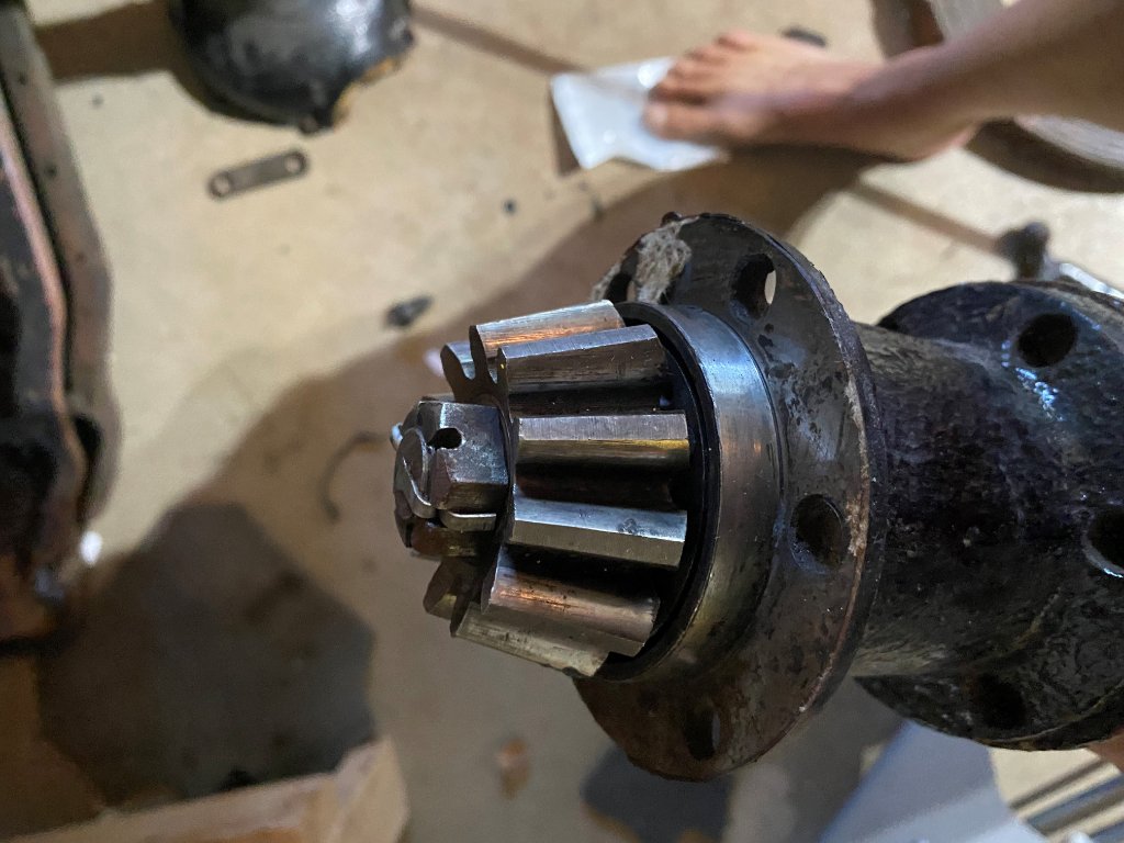

Here's pics of the pinion gear
Posts: 8433
Post by TXGOAT2 » Mon Sep 19, 2022 4:50 pm
The pinion gear looks too good. I wonder if someone replaced the pinion just to get the car mobile again. I'd replace the ring and pinion, and any other worn parts.
Post by Norman Kling » Mon Sep 19, 2022 5:03 pm
The case hardening is worn through. Also very rough surface, so the wear in the future will be excessive. Time to replace. While you are at it, go through the entire rear axle and rebuild it. If you don't have one, the booklet distributed by the club, and sold at many vendors, "Front and Rear Axles" or "Ruckstell Axle" are excellent step by step descriptions of how to do the work and adjustments.

I hate to pass judgement on a pinion gear that I dont have in hand for a close inspection. That being said, the gear looks good. If its ford script, you
could use it with a very good used ford script ring gear. I believe ford's gear manufacturing consistency was exceptional, so mixing used gears with minimal wear doesnt bother me.
But do not replace the ring gear only with a non ford gear of the period or new today. Chances are high that the gear teeth will be slightly to significantly different.

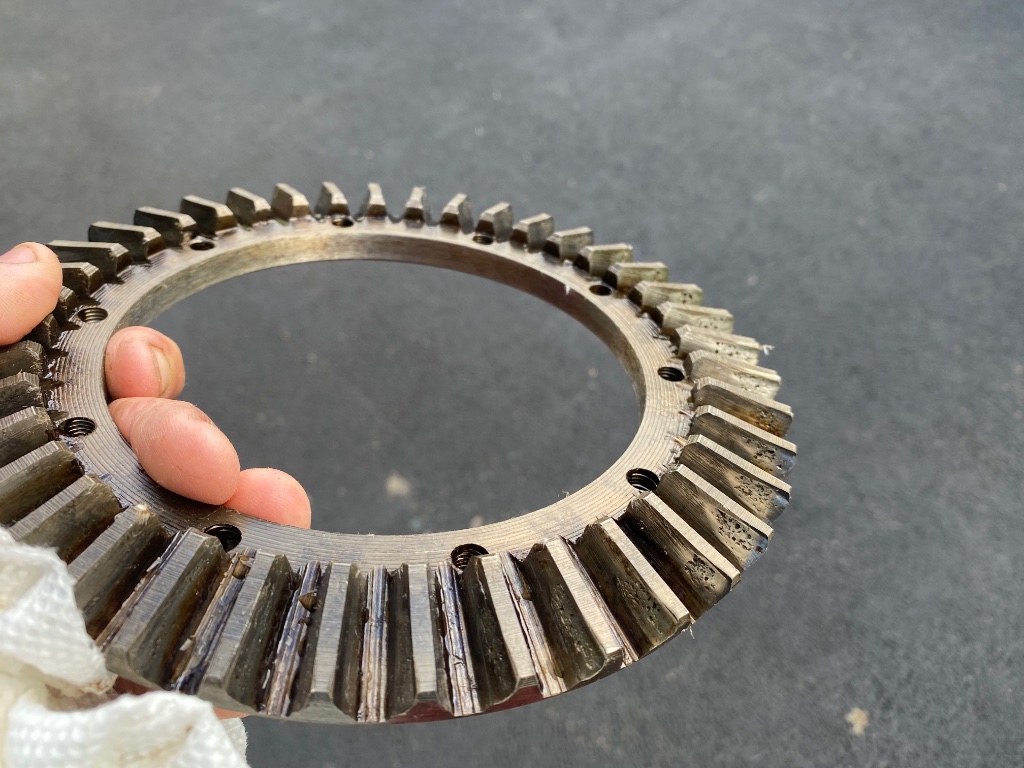

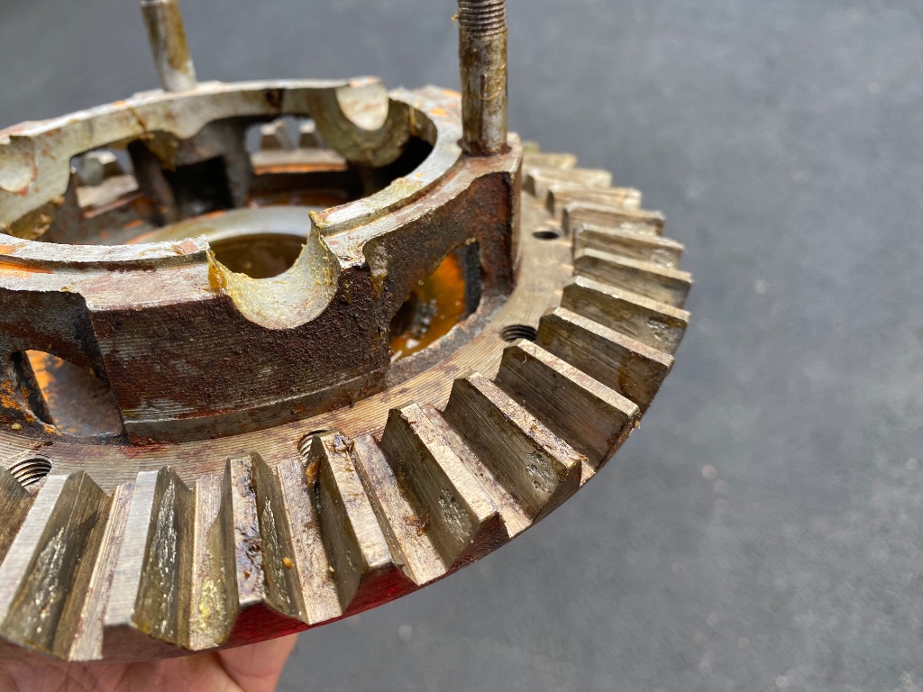

Post by pedechad » Sun Oct 02, 2022 10:48 am

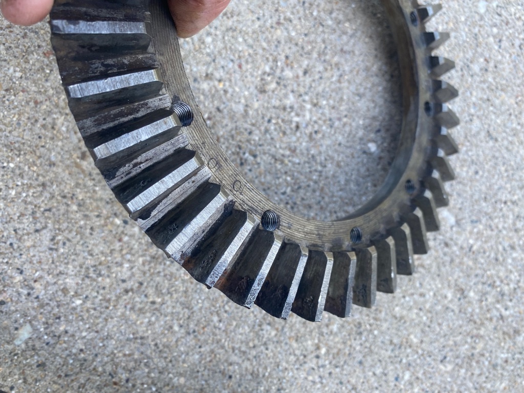

Ok I tore apart the other two axles I had. One had bronze washers while other was still Babbitt. These might be in a little better shape. One of the diff housing is different, has studs rather than bolts.
Post by pedechad » Sun Oct 02, 2022 10:49 am
Here’s the other one

Post by pedechad » Sun Oct 02, 2022 10:51 am
Another shot
Posts: 8433
Post by TXGOAT2 » Sun Oct 02, 2022 10:52 am
Replace worn parts.
Posts: 6710
Post by Scott_Conger » Sun Oct 02, 2022 11:06 am
Nothing you've shown is worthy of re-using...listen to Pat.
Post by speedytinc » Sun Oct 02, 2022 11:48 am
I wouldnt use either of your ring gears.
Do the job right once.
