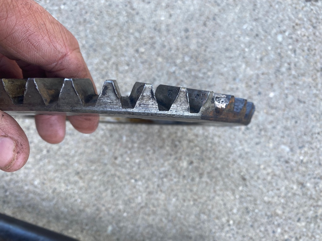

Have a speedster build and tearing apart a rear axle I’ve got. Looking for input on whether new ring and pinion is warranted. Also I see some wear on axle, Babbitt thrust washer was broken when I tore apart so assuming it caused the wear?

That ring & pinion need replaced. All other parts need to be carefully checked. The gears have been shedding metal particles, and all metal debris needs to be cleaned out of the housings.

The wear in that crown wheel indicates that there was too much backlash, possibly contributed to by the failing thrust washer. The gears need TO BE replaced.

Not sure how you're able to determine excessive backlash from that wear pattern. What I see, is evidence of a poorly aligned ring & pinion gear, regardless of what the backlash condition might have been. Honestly, if it were re-used, with a proper mesh adjustment, that gear would probably be fine. I say that however without seeing a picture of the pinion gear. That's only if you need to save some $$$ however. Since you've got everything apart right now, it would the right time to use new gears.

The pinion gear looks too good. I wonder if someone replaced the pinion just to get the car mobile again. I'd replace the ring and pinion, and any other worn parts.

The case hardening is worn through. Also very rough surface, so the wear in the future will be excessive. Time to replace. While you are at it, go through the entire rear axle and rebuild it. If you don't have one, the booklet distributed by the club, and sold at many vendors, "Front and Rear Axles" or "Ruckstell Axle" are excellent step by step descriptions of how to do the work and adjustments.

I hate to pass judgement on a pinion gear that I dont have in hand for a close inspection. That being said, the gear looks good. If its ford script, you
could use it with a very good used ford script ring gear. I believe ford's gear manufacturing consistency was exceptional, so mixing used gears with minimal wear doesnt bother me.
But do not replace the ring gear only with a non ford gear of the period or new today. Chances are high that the gear teeth will be slightly to significantly different.

Jerry, if you can get hold of a copy of Ted Aschman's "Tinkerin Tips, volume two", there is a section on setting up the crownwheel and pinion mesh correctly. Part of the article shows a set of drawings indicating various wear patterns and how to make adjustments to achieve the correct rolling fit for straight cut gears. Excessive wear on the heel of the gear teeth, as shown in the photos, is due to too much backlash.
