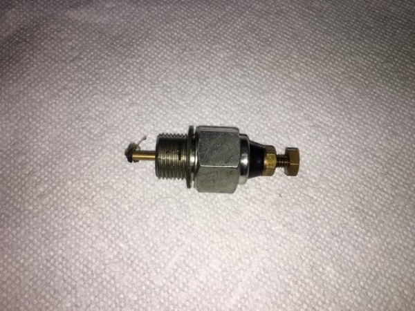

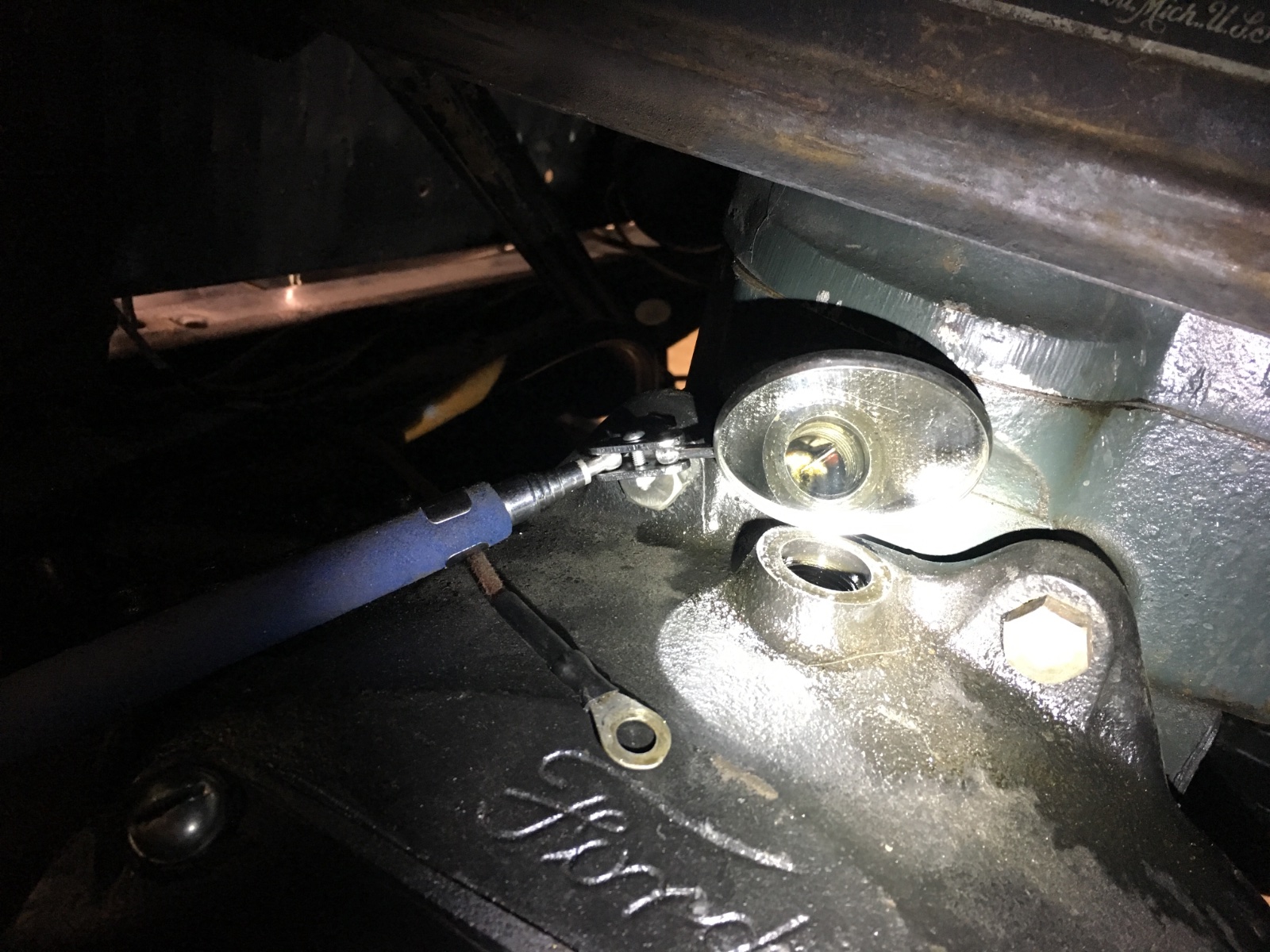

Re: mag ignition
Don’t look at the mag post hole. Instead look in the round mirror. It’s hard to see, but there is a piece of band lint about the size of a short piece of dental floss on top of the blob of solder. The lint got stuck between the solder blob and the brass contact of the mag post. Thus lifting the contact enough to break contact. This lint caused me the exact symptoms that you described.
- Posts: 310
- First Name: Bill
- Last Name: Robinson
- * REQUIRED* Type and Year of Model Ts owned: '21 Depot Hack, '25 Touring Car, '26 Roadster Pickup, '27 Tudor, & another '27 Tudor
- Location: Salty Bottom, ALABAMA AL
Re: mag ignition
Another picture, a different incident. Lint interfering with my magneto.
