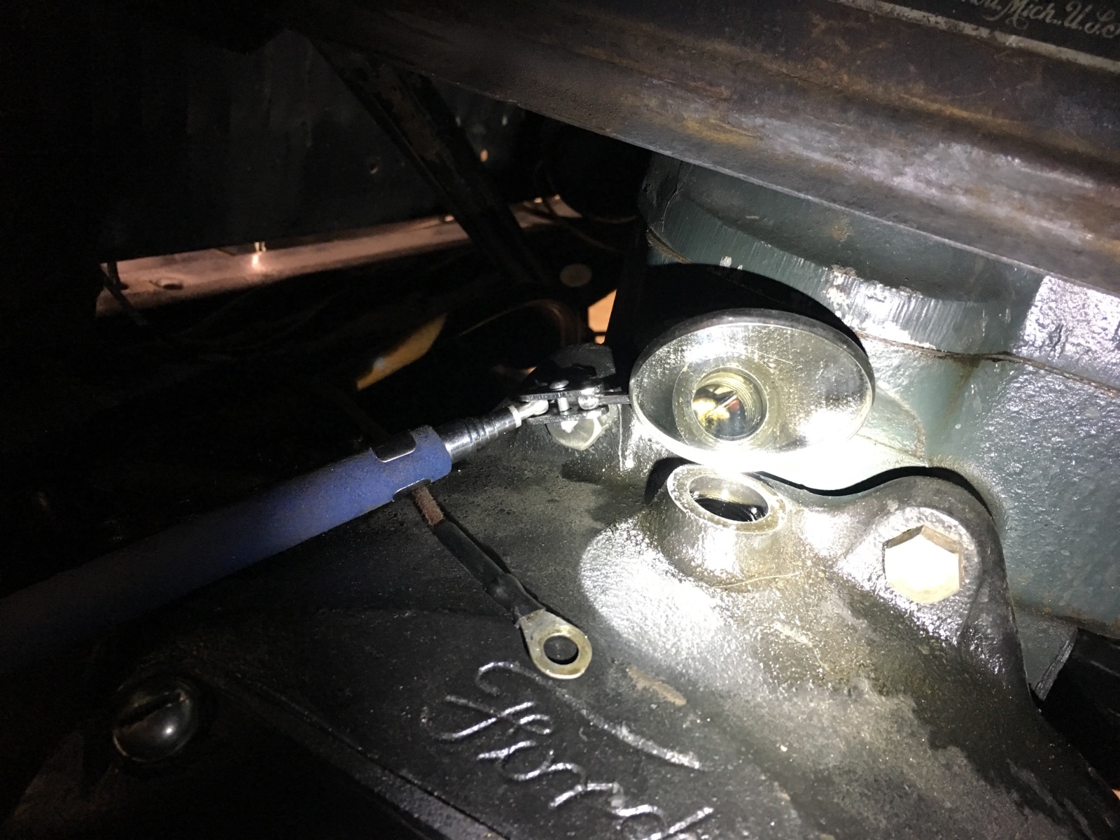

Post by Bill Robinson » Tue Apr 23, 2019 7:47 pm
Don’t look at the mag post hole. Instead look in the round mirror. It’s hard to see, but there is a piece of band lint about the size of a short piece of dental floss on top of the blob of solder. The lint got stuck between the solder blob and the brass contact of the mag post. Thus lifting the contact enough to break contact. This lint caused me the exact symptoms that you described.
Look at the mirror! Not the hole.

Re: mag ignition
Post by Bill Robinson » Tue Apr 23, 2019 10:11 pm
Another picture, a different incident. Lint interfering with my magneto.
