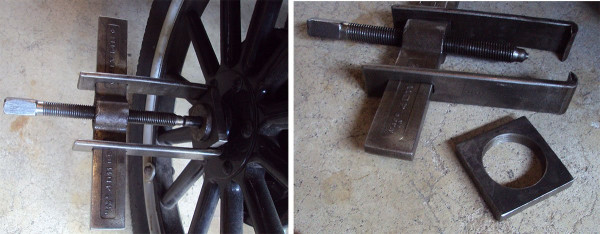

Post by Rich Eagle » Mon Oct 31, 2022 1:16 pm
You will probably need one again someday. I threaded a plate to use with a standard puller I use a lot. A machine shop should be able to make one fairly reasonably. Mine has worked very well for a long time.

RajoRacer wrote:
Mon Oct 31, 2022 3:13 pm
Rich - is that flat plate threaded as the hub ?
Yes, it is threaded to fit the hub threads. I forget the size. I cut the threads on my lathe and left it a bit tight but now is spins on and off very nicely. I have used it more than a dozen times and is the only way I do it now.

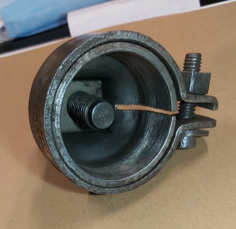

Post by Allan » Tue Nov 01, 2022 4:19 am
There are pullers and there at good pullers. A good puller has good threads and a pinch bolt to lock the puller on the thread. Those fine threads will not take much load if you rely on the thread only. It is easy to strip out the thread under heavy load.
Rich's puller relies on just the thread, but it is formed in steel. Most pullers are castings, and these do not perform as well. Perhaps the best one I have found is a Mosberg aftermarket item made of steel, and having a pinch bolt.

Posts: 5594
Re: Rear Hub Puller for Roadster
Post by RajoRacer » Tue Nov 01, 2022 11:12 am
That's a direct copy of the Ford puller - pretty tough to beat ! I have to agree with Allan regarding the pinch bolt - I've seen good pullers have their threads and/or the Ford hub threads ruined.

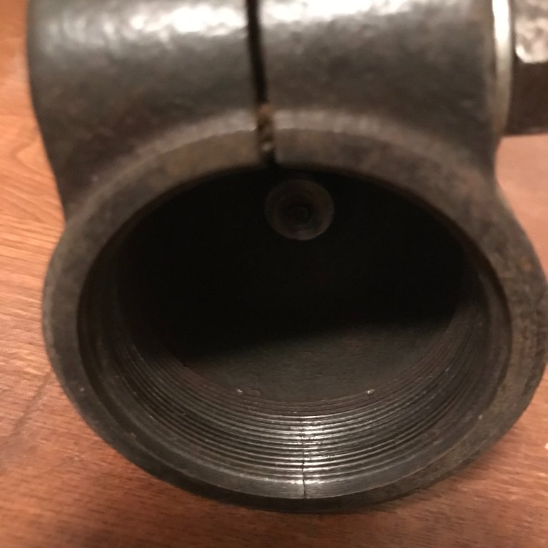

Post by Nathan Pederson » Wed Nov 02, 2022 6:25 pm
As pointed out, the Ford type pullers work well. Unfortunately, they can be cracked as shown in the picture if
the pinch bolt is overtightened. That's why I like Rich Eagle's use of a flat thick steel plate to make one.
And, with a slot and a pinch bolt added to it, that steel plate would pull even the toughest hub with no
damage. The ultimate wheel puller.

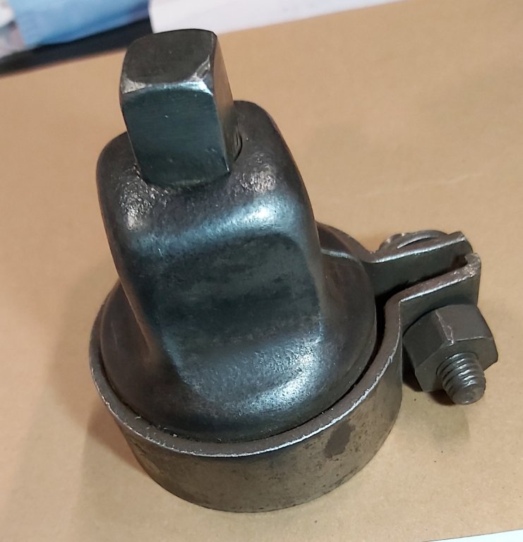

Post by Allan » Thu Nov 03, 2022 8:19 am
This is perhaps the best one I have had. It's a Mosberg tool no 660. It is all steel so the thread is robust. There is no chance of it cracking. The pinch bolt/ ring has built in measures against over tightening.
Best of all, the large square not captive in the housing, is actually free within, to move in and out with the driving bolt. This means that once the drive bolt is put under tension, a smart whack with a heavy hammer will allow it to shock the axle independently of the puller body. This is how the Ford pullers for wire wheel hubs workd.
Post by Nathan Pederson » Thu Nov 03, 2022 10:45 am
Allan, that puller is one well designed tool!
Interesting to see it.
