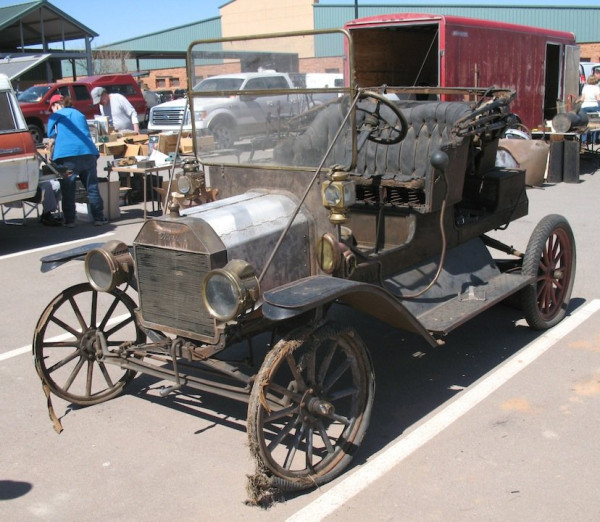

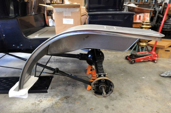

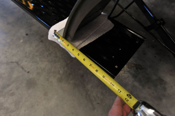

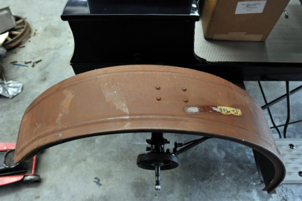

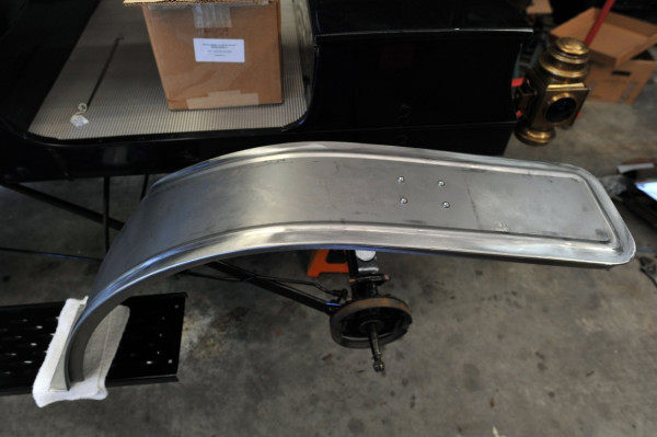

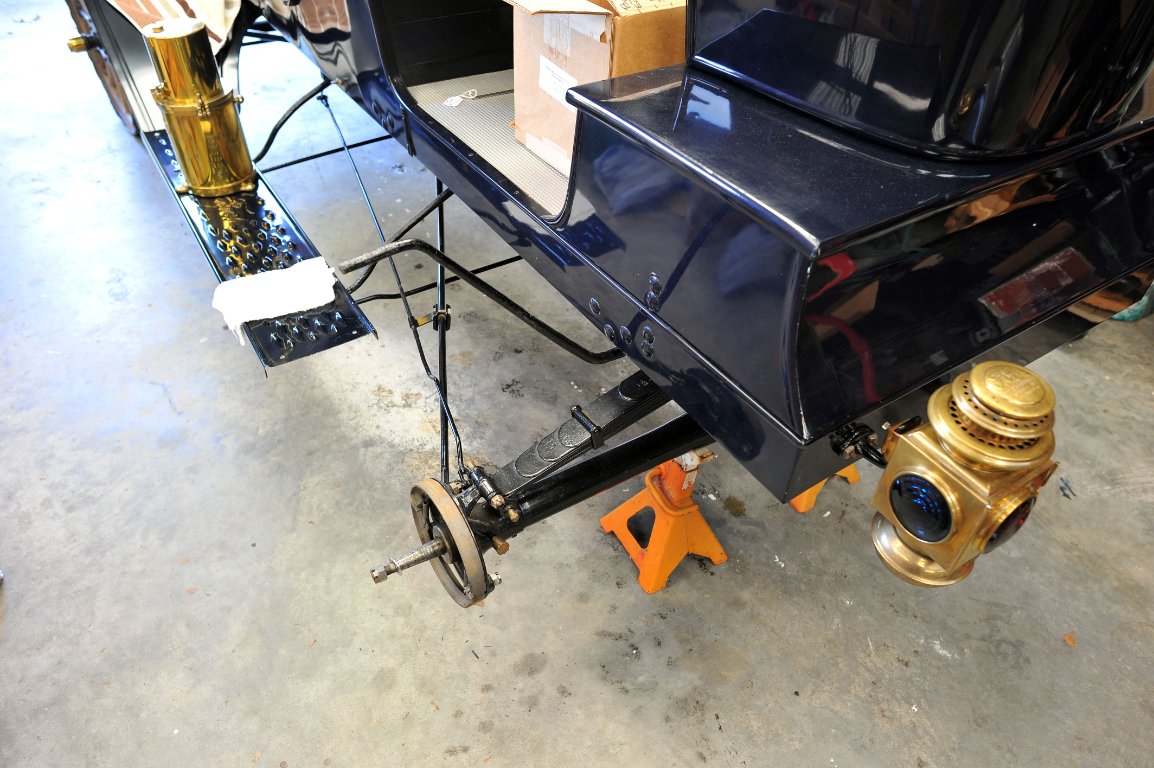

I am re-restoring a 1912 Commercial Roadster and the previous owner used Torpedo rear fenders rather than the “flat-top” rear fenders such as was used on the 1912 Touring. Supposedly, the 1912 Touring and Roadster rear fenders are the same. Well, I prefer the “flat-top” fenders over the curvey Torpedo fenders. So…I purchased rear fenders from Rootlieb (nice product!) and found they don’t mount with my current fender iron setup. The rear fender irons I have on the car (see picture) protrude in-line with the rear cross member. This doesn’t work on mounting the Rootlieb flat-top fenders. One way to describe it is that the inner mounting bracket is about 8” too far back on the fender (see picture). My question is, are there other rear fender irons that I should be trying to find? If so, they would have to mount to the body itself (a la Touring) or maybe there is some special iron they used that I am unaware of. Hopefully this question is clear. The first picture is a Torpedo fender, by the way, which mounts OK to my existing fendor irons.

I am all but certain that by 1912, the iron was bolted to the outside of the sill, and directly to the body bracket (and I'm pretty sure that is for all cars and not unique to the Commercial).
Regardless of my opinion, the question intrigues me and like you, I am waiting for a definitive answer.

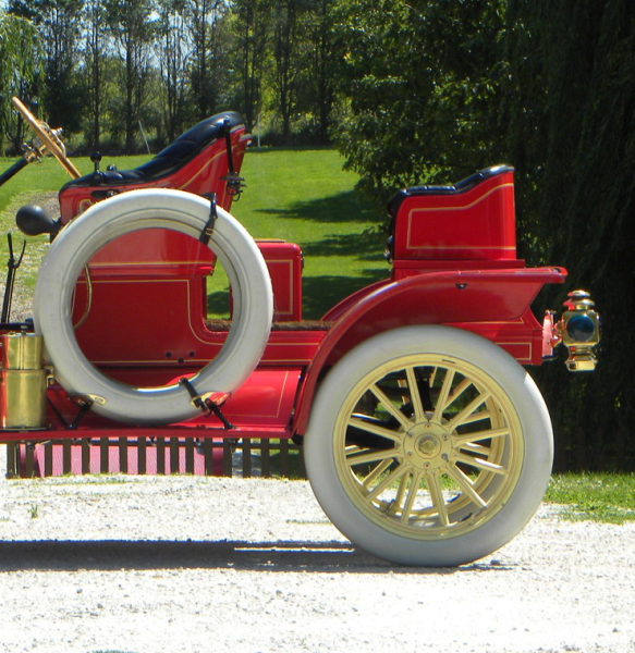

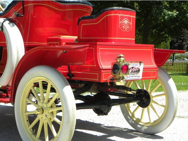

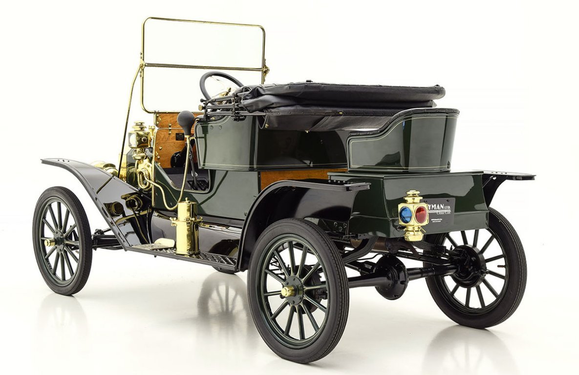

Well, I have just quickly shown myself to be wrong. Is this iron longer/higher than yours?? Here is what I think you're looking for:

The rear fender irons on that beautiful survivor look to be pretty much the same as the ones on my car now, although they do appear to have been tweaked a bit. I think I need some fender irons that bolt to the body part that protrudes past the rear crossmember of the frame. Give or take......

I may be wrong, but the rivet position of mounting bracket appears to be too far back on the top of the fender as compared to the curved fenders. Could this be part of the problem? -- Kevin Klein

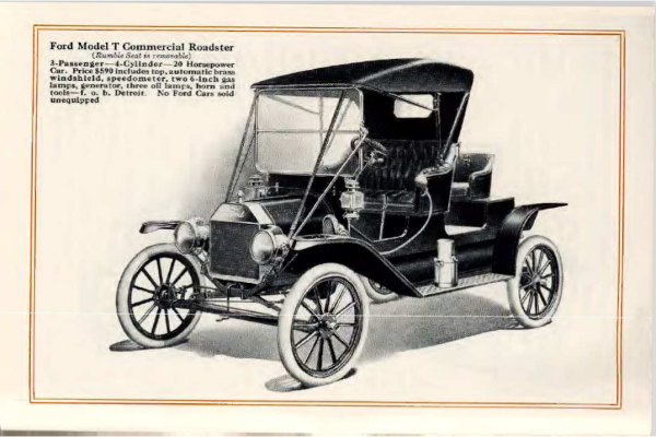

Here is two 1912 adverts from Ford.
I also remember George saying something about some cars with the butterfly brackets were used as well but I cannot remember if that was for 1911 or 1912 as well. They took a flat top fender with two fender eye bolts on each fender.

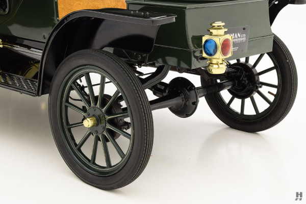

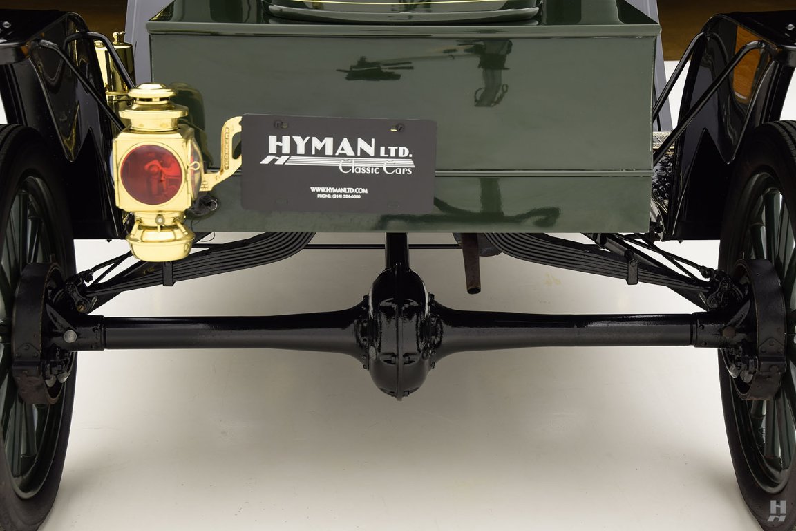

Courtesy: Hyman - advertised as a 1912, but with butterfly fender irons, should be earlier, I think

If you do go with the butterfly fender irons you will either need to add an extra fender bracket on your fenders or get the correct 09-10 fenders that has the two brackets. When researching the correct rear fender brackets for my Delivery car I found that the Delivery car used the 1910 rear Fender but with only one bracket.

Yeah, your picture shows what I originally thought belonged there and then faltered in my certainty. It's nice that you have a good clear photo of that and bad for the poster who has already (gorgeously) painted his car! Thank you for posting it for us to see.
I recently finished wrestling with that type iron on my '23 and am embarrassed to even hint at the time it took me to bend/tweak it to get nice level and square rear fenders which still lined up with the dust aprons and running boards...! What a chore! (maybe I'm just slow-witted)
Even those on the Volo car really could have used a little more time spent on them for better alignment/level.
