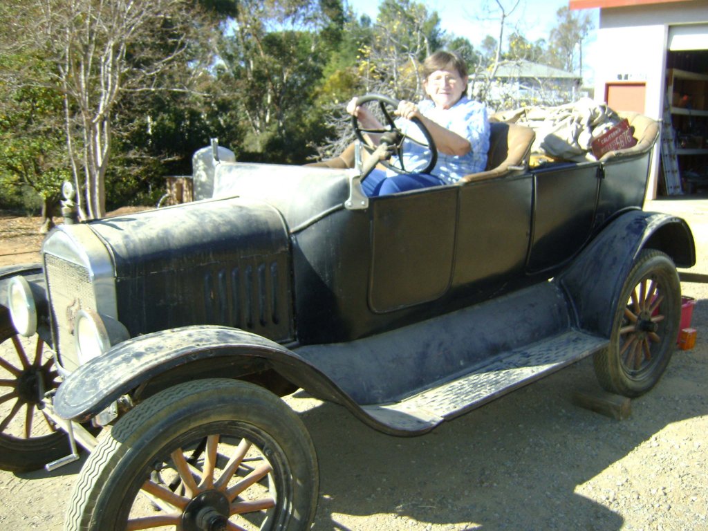

Post by Norman Kling » Tue Nov 08, 2022 11:07 am
Only a few cars still have the original engine block. There were also aftermarket blocks sold without a number and the purchaser would stamp the original engine number on it. There might also be some engines out there with identical numbers if someone had later rebuilt the old engine and re-used it. And others have changed the vin number of the car to the number stamped on a replacement engine.
So you cannot rely on the engine number to be sure what year the car is. The car looks in the picture on the trailer to be in good condition. Very important to the body is also the condition of the wood. The body is sheet metal tacked onto a wood skeleton. So if the wood is rotted or termite infested the body will sag in various places and the doors and hood might not fit correctly. If the car has been in Cathedral City or in that vicinity most of it's life, especially if stored indoors, There is less likelihood of rot or rust, but I'm not sure whether or not there are termites in an area with hot summers.
also the condition of the frame could also cause things to sag. So,anyway, check out the body and if good, you might just concentrate on the mechanical parts and drive it as, "unrestored".
Depending on how the car was stored, will make a big difference on how easy it will be to get it running. The original pistons were cast iron, so if there was any dampness in the cyllinders, they might be rusted in place. If the engine will turn over with the crank, you are lucky. You could have stuck valves, so check them out too. Old oil should at least be changed and if you get it running, run a short distance and change again. One area of concern is the fuel system. If it was not completely drained and the fuel line blown out before storage, you might need to replace the tank and fuel line. Some good radiator shops can boil out the tank and save it, but it might cost as much as a new tank, however, new tanks might be backordered, so you might need to save the old one if you can't find a new one. The carburetor will also need to be completely cleaned and all the passages blown out. If the fluid is still in the cooling system, some might have seeped into the engine which would settle to the bottom of the oil sump.. Or if not treated with rust inhibitor, it might have rusted the head and block so be sure to flush things out and if it overheats, you might need to remove the head and clean out the water passages in the engine. The radiator may or may not need to be replaced or rodded. Anyway, if it were mine I would work on the mechanical parts first to get it running and to find out the extent of repairs they will need. See picture of a 20 which I spent several years getting to run for a friend. We did not do any body work except to put on a new top. We replaced the gas tank and fuel line and while I had it replaced the wood wheels and installed a Ruckstell axle and Rocky Mountain brakes. Also replaced the shaft in the steering column. It ran when I returned it. I'm now very good at taking pictures. Wish I had taken some after the top and windshield were on.

Note the low steel firewall. Offered briefly on late 22 to 23 ...
Even more briefly than that. According to the encyclopedia the steel firewall was introduced in January 1923. Both steel and wood firewalls were used for a couple of months, then only steel. The 1923 steel firewall was used only about seven months until the 1924 model year arrived. Identifying the two different steel firewalls is easy. 1923 has a large hole for wiring under the terminal block. 1924-25 has it above the terminal block.
