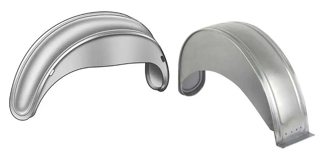

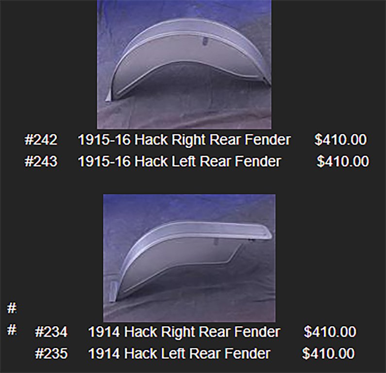

Re: Depot Hack rear fender differences.
This is what Rootlieb offers.
I hope he doesn't mind me posting this.

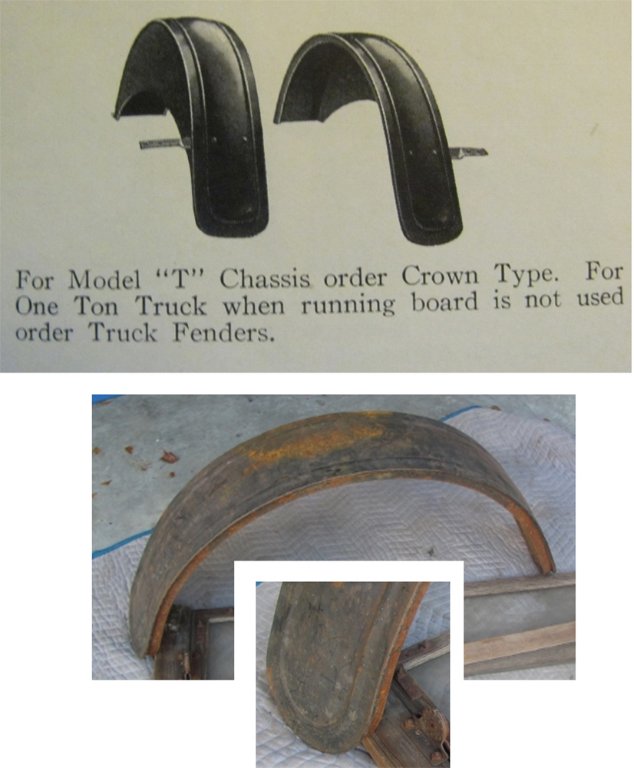

Mac's offers these with the hump. '17 and later. (Mac's?)
These are nice for trucks. I had a set on my C-cab with both ends rounded.
