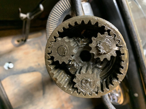

Since it's too cold to work in the garage and the car is in a really inconvenient spot in the garage, I'm stockpiling parts for warmer weather. I have new coils now! Anyway, when I bought this car, '26 Roadster, I've noticed that the steering wheel is....wiggly. I bought a stock steering wheel and braved the cold last week (sub zero) enough to see how it would look and disassemble the steering gears. I really can't tell much. There is some grease in there. A couple times when I was driving it if I turned the wheel while stopped I would hear a popping sound. Just a single pop. The car steers pretty good and isn't hard to handle. I see some new gears online. Would I just go with a new set of 'oversized' gears to make up the 'slop'?

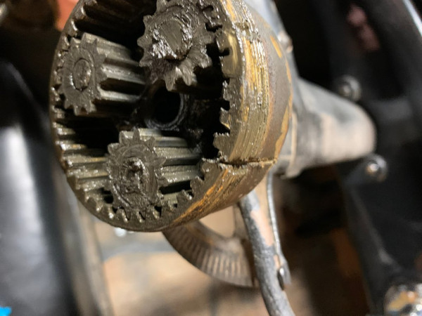

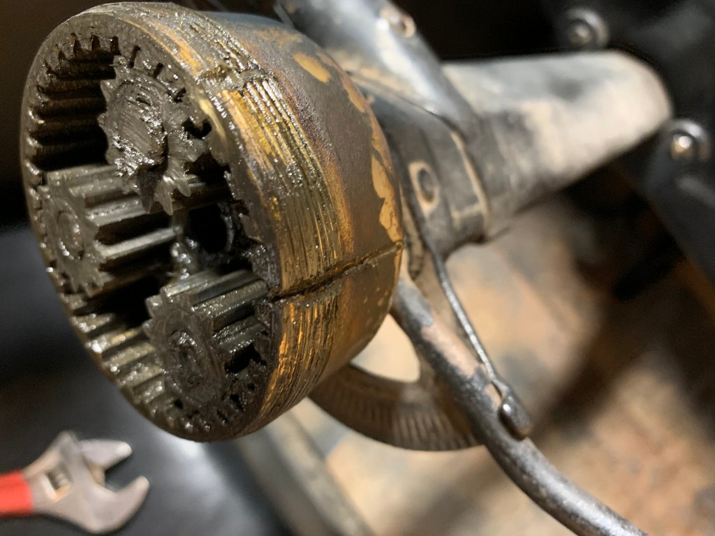

I’ll have to try to post pictures later, but I checked on it again tonight. It appears the threads on the gear cover and case are just worn out. If that little screw didn’t hold….I suppose the wheel would come right off? Is there any fix for this? I see new steering gear covers (3504B) are available, but what about the case?

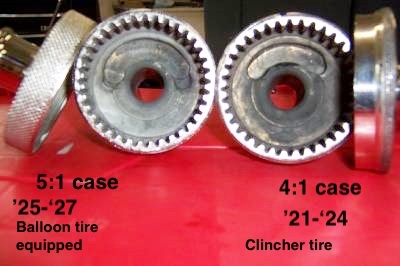

I think this is the oversize 5 to 1 steering box gear set Scott C. is referring to.
It’s sold by Lang’s and maybe others. I think Texas T came out with it several years ago before they sold the company. But I’m not to sure Ford had the oversize set in the model T era. It was an aftermarket product. I can remember people wanting the 5 to 1 26-27 gears and box to use in their earlier T’s years ago. Then Texas T came out with one.
BUT I could be mistaken about when the oversize set came out and if Ford did it first. But I bet Scott C might know or others.

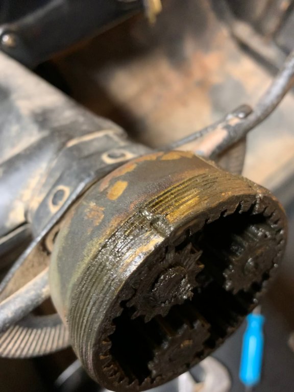

The bad news is that you need another steering gear case. Yours is badly split and somewhat dangerous as it might cause the steering to lock up on you. Others here might encourage you to repair it. My sincere hope is that you find a good used one. Do they make these new??

I wondered if I was seeing a split there. I might know of someone that has another one. It appears that the threads are so bad that the only thing holding it together is that little screw.Jerry VanOoteghem wrote: ↑Fri Dec 30, 2022 8:53 amThe bad news is that you need another steering gear case. Yours is badly split and somewhat dangerous as it might cause the steering to lock up on you. Others here might encourage you to repair it. My sincere hope is that you find a good used one. Do they make these new??

I would degrease , clean , and then braze that crack in the steering case. Reinstall regrease, put a new cover on that would compensate wear on the center gear that the steering wheel attaches. Replacing the case requires drilling out the old rivets and then installing the replacement case with new rivets. That would be the next step if you could find out who can do your rivet work

Since you have a 26 T make sure you get a 26-27 column or gear case. It will fit your car. The earlier columns and gears are different in ratio. Your is 5 to 1 whereas the earlier ones are 4 to 1. The way they mount is some what different also.

You're assuming he can't install two small rivets, but also assuming he can braze the case back together safely? That case is toast. The threads are shot to the point that the cover falls off without the retaining screw in place.Moxie26 wrote: ↑Fri Dec 30, 2022 9:47 amI would degrease , clean , and then braze that crack in the steering case. Reinstall regrease, put a new cover on that would compensate wear on the center gear that the steering wheel attaches. Replacing the case requires drilling out the old rivets and then installing the replacement case with new rivets. That would be the next step if you could find out who can do your rivet work

I would not even try to repair that steering box. It is very important for your safety to have a good one. I can't say why or how that happened, but you could lose all control of steering if you drive it that way. imagine going around a corner and not being able to straighten out.

Exactly, Jerry. I can push the cover on the case without threading it on. The threads are gone. The only thing that is holding the cover on is that screw!Jerry VanOoteghem wrote: ↑Fri Dec 30, 2022 10:57 amYou're assuming he can't install two small rivets, but also assuming he can braze the case back together safely? That case is toast. The threads are shot to the point that the cover falls off without the retaining screw in place.Moxie26 wrote: ↑Fri Dec 30, 2022 9:47 amI would degrease , clean , and then braze that crack in the steering case. Reinstall regrease, put a new cover on that would compensate wear on the center gear that the steering wheel attaches. Replacing the case requires drilling out the old rivets and then installing the replacement case with new rivets. That would be the next step if you could find out who can do your rivet work

As noted in the previous replies, do get the proper '25-'27 steering case for your '27 with balloon tires, the ratio of the cluster gears will be the later 5:1 and that steering case to use is the one with the wider groove for the stop pinion.
And find a good used one with good gear teeth too, you can then use the reproduction 5:1 gear sets, and change out your pinion posts on the steering shaft too. Makes for proper repair to use good used parts or new parts.

As of noon today, we found out the threads on the case are shot. Pictures did not show that, and some had assumed that the grease on the threads was blocking the condition of the threads. Having something in front of us to observe in person is a lot better than unclear pictures and comments, pro or con.... Cat Guy., Keep us informed of your progress,

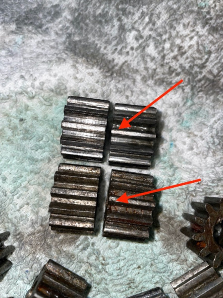

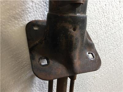

I've been playing with T's for over 50 years and have never seen a more worn out steering box than this before. Why would anyone waste 10 seconds thinking about any sort of repair? It's a '26-'27 column (not 1909) and there has to be hundreds if not thousands of decent used ones around (I must have seen 30-40 at Hershey 2022 and I wasn't looking for one). As well, after seeing this totally worn out steering box still in use, a great big red flag would go up about the condition of the rest of the steering system along with all other mechanical components of this car. Model T steering is just one step above go-cart steering to begin with so don't take chances or settle for any quick patch-up fix. Sorry if I offended anyone but this is not something to take lightly as your life and the lives of others are at risk with this sort of stuff on the road. Good for you for questioning it and getting help.

I need to be educated here on what makes this one bad before I buy a ‘new’ one. I need to know what I’m looking for. I know that the steering wheel wobbles and the threads are bad, but beyond that what are other possible red flags?Bruce Compton wrote: ↑Fri Dec 30, 2022 9:12 pmI've been playing with T's for over 50 years and have never seen a more worn out steering box than this before. Why would anyone waste 10 seconds thinking about any sort of repair? It's a '26-'27 column (not 1909) and there has to be hundreds if not thousands of decent used ones around (I must have seen 30-40 at Hershey 2022 and I wasn't looking for one). As well, after seeing this totally worn out steering box still in use, a great big red flag would go up about the condition of the rest of the steering system along with all other mechanical components of this car. Model T steering is just one step above go-cart steering to begin with so don't take chances or settle for any quick patch-up fix. Sorry if I offended anyone but this is not something to take lightly as your life and the lives of others are at risk with this sort of stuff on the road. Good for you for questioning it and getting help.

No good reason to repair this very common, heavily damaged part.
I would expect this replacement part to cost approximately 75.00. Fair amount of work in changing this out, but no where near the work required for the earlier (2) piece style.

The steering assembly you have shows clear evidence of extreme wear and abuse. The steering gear case is actually split apart. The condition of these parts may, or may not, reflect the condition of other mechanical parts of the car, but I would expect that it might, and I would inspect the entire chassis, engine, brakes, wheels, etc, before driving the car. You're dealing with a century old car. Some people will drive a car with steering issues until something breaks, while spending time and money on cosmetics or engine issues. Your car may be in good condition overall, but the steering box certainly isn't!
- Posts: 4470
Re: Wiggly Steering Wheel
I thought we've covered that fairly well... Cracked. Worn out threads. Unsafe. What else is left to say?CatGuy wrote: ↑Sat Dec 31, 2022 7:59 amI need to be educated here on what makes this one bad before I buy a ‘new’ one. I need to know what I’m looking for. I know that the steering wheel wobbles and the threads are bad, but beyond that what are other possible red flags?Bruce Compton wrote: ↑Fri Dec 30, 2022 9:12 pmI've been playing with T's for over 50 years and have never seen a more worn out steering box than this before. Why would anyone waste 10 seconds thinking about any sort of repair? It's a '26-'27 column (not 1909) and there has to be hundreds if not thousands of decent used ones around (I must have seen 30-40 at Hershey 2022 and I wasn't looking for one). As well, after seeing this totally worn out steering box still in use, a great big red flag would go up about the condition of the rest of the steering system along with all other mechanical components of this car. Model T steering is just one step above go-cart steering to begin with so don't take chances or settle for any quick patch-up fix. Sorry if I offended anyone but this is not something to take lightly as your life and the lives of others are at risk with this sort of stuff on the road. Good for you for questioning it and getting help.

Just wanted to make sure that there wasn’t something else like the gears being bad, are there spacers or bushings in the column that need replaced? I just have lots of questions. Sorry.Jerry VanOoteghem wrote: ↑Sat Dec 31, 2022 9:56 amI thought we've covered that fairly well... Cracked. Worn out threads. Unsafe. What else is left to say?CatGuy wrote: ↑Sat Dec 31, 2022 7:59 amI need to be educated here on what makes this one bad before I buy a ‘new’ one. I need to know what I’m looking for. I know that the steering wheel wobbles and the threads are bad, but beyond that what are other possible red flags?Bruce Compton wrote: ↑Fri Dec 30, 2022 9:12 pmI've been playing with T's for over 50 years and have never seen a more worn out steering box than this before. Why would anyone waste 10 seconds thinking about any sort of repair? It's a '26-'27 column (not 1909) and there has to be hundreds if not thousands of decent used ones around (I must have seen 30-40 at Hershey 2022 and I wasn't looking for one). As well, after seeing this totally worn out steering box still in use, a great big red flag would go up about the condition of the rest of the steering system along with all other mechanical components of this car. Model T steering is just one step above go-cart steering to begin with so don't take chances or settle for any quick patch-up fix. Sorry if I offended anyone but this is not something to take lightly as your life and the lives of others are at risk with this sort of stuff on the road. Good for you for questioning it and getting help.
- Posts: 4470
Nothing to be sorry about. The gears do appear to be fairly well worn also. At this point, every piece needs to be inspected for wear. Also, the 3 pins that the gears roll on. Are they tight in the steering shaft? What is the condition of the steering box cap? Are its threads also very worn? How well does the steering wheel shaft fit in the cap? If you end up buying 3 new gears, you should also buy a new steering wheel shaft.
First however, see what you can come up with as a replacement for your gearbox. Maybe you'll end up with a complete replacement column that will also address any other issues.
- Posts: 4694
I would suspect that the pinion (the gear in the middle was being pushed very hard against the planetary gears(the three which rotate around it) into the ring gear (in the case) and pulling very hard on the steering wheel over the years caused the bronze to crack. The whole thing should be replaced with a better one. The big swap meet I was thinking about is in Chickasha Oklahoma in the spring. Someone who regularly attends it would know the date and location.

Will only 26-27 steering columns work in my '26 Roadster or will other years? How do I tell these apart?
- Posts: 4681
Since you have a 26 Roadster your steering column should have a rectangular mounting bracket.
All other earlier Model T steering columns have a round mounting bracket.
If you try to use an earlier one THEY WONT FIT to your firewall and it will make things more difficult for you.
The steering column mounting bracket is the one that mounts directly on the firewall.
If you going to a swap meet this is what you look for and the easiest way to tell the difference.

As John described, your steering column mounting flange should look like this...

First thing I would do is disassemble the column and see just what is needed. You may only need the case and tube. Get the Service Manual if you don’t have it. Shipping on tube and case will not be that high compared to a whole column.

Thanks! I looked at mine again and it looks like that, as we'd expect. I'm checking around and will contact Lang's.Jerry VanOoteghem wrote: ↑Tue Jan 03, 2023 4:09 pmAs John described, your steering column mounting flange should look like this...

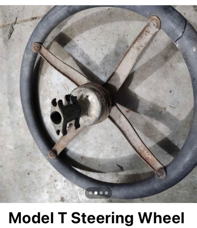

I’m still searching for a complete column, but I found this. Would it fit mine? It looks like it.

To see if it’s a 26-27 case you need to remove the steering wheel nut and take off the steering wheel. You cant tell from the outside as far as the gear case is concerned. The gears inside will be the determining factor along with the groove inside the case. Once the wheel is off remove the small screw that holds the cover in place and look at the gears and case groove. There are some comparison pictures on this thread that show the gear differences and the differences in the grooves in the bottom of the case.

That looks like a 15" or 16" wheel and '26-'27 were 17" diameter. You don't need to remove the steering wheel from the main shaft, just remove the locating screw and unscrew the cover. The 4:1ratio planetary gears are the same size as the drive gear and with the 5:1 ratio, the drive gear is smaller than the planetary gears. BTW, you should also check the "bushing" at the bottom of the column where the main shaft exits, as well as the support box (at the frame) for wear on the shaft and the bushing(s) if you're thinking of re-using your original column..

Looking at your pictures, and the markings on the steering case cover, I would say it has the 4 to 1 gearing.
- Posts: 5591
Steering gear covers are a "fit all" on any gear case - although the '26 - '27 5-1 cover has full knurling whereas the earlier cover appears partially knurled at the top as shown in the photos.
