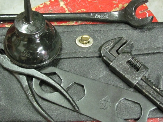

Any T tools with "Made in USA" are Model A versions, T tools don't have that.
The Ford script should be on the upper face jaw for that adj. wrench.

Not all provided tools had script.
Auto wrenches & pliers can be found with a M in a circle.
I believe produced by Mossberg.

Some even have the Ford part number in them. The adjustable wrenches for our Canadian cars were produced by more than one manufacturer, their brand often part of the handle forging. I believe the M in a circle brand is one of them. but not Mossberg. Those aftermarket Mosberg tools I have seen have the M stamped in a laid over diamond.

I was to understand the M in a circle was for Moore Forging.
