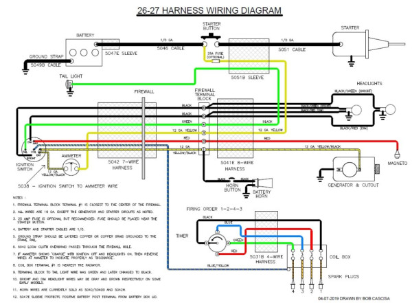

What is the size of the generator wire?
Posts: 6588
Re: Generator Wire
Post by TRDxB2 » Wed Apr 26, 2023 12:46 am
BLB27 wrote:
Tue Apr 25, 2023 11:44 pm
12ga click on image to make it larger & less blurry

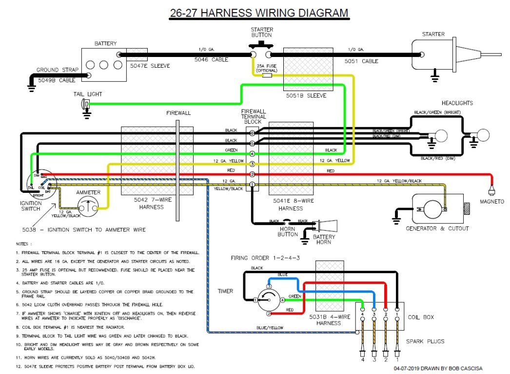

I "think" I found it in Frank's April 17 post responding to my April 15 Horning Wiring post. It is a #16, unless it is one of the exceptions noted. I can't find where the exceptions are "T-1, 1-K, K-U etc." are identified.
Thanks, Frank.

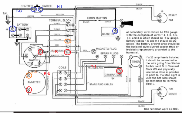

I was looking at the paragraph in the upper right hand corner of the diagram above the one you just referred to. Where are the T-1, 1-K, etc. shown?
Posts: 6588
Re: Generator Wire
Post by TRDxB2 » Wed Apr 26, 2023 1:58 am
BLB27 wrote:
Wed Apr 26, 2023 1:04 am
Frank, I sent my last note before I saw yours!
They are not exceptions - just hard to see click on the image to enlarge The H-I makes the capital I look like a 1
