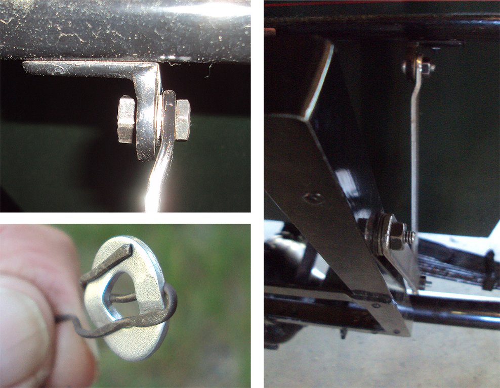

Post by Rich Eagle » Sat Jul 01, 2023 12:37 pm

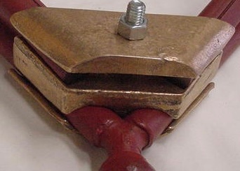

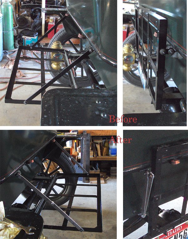

When I built the trunk rack for the '09, I wasn't ready to develop the hinged links for raising and lowering it. I got tired of changing separate links for Up and Down. This design has an offset in the upper link which provides for a better-looking arrangement when up. The different distances between holes of individual links keeps them from interfering with each other or the trunk frame.
I distorted flat washer to have some spring to reduce vibration and staked the bolts so the nuts would stay put.
By tightening nuts, the rack should stay in place either way.
This shows more of the rack as first built.
http://www.mtfca.com/discus/messages/50 ... 1421195620

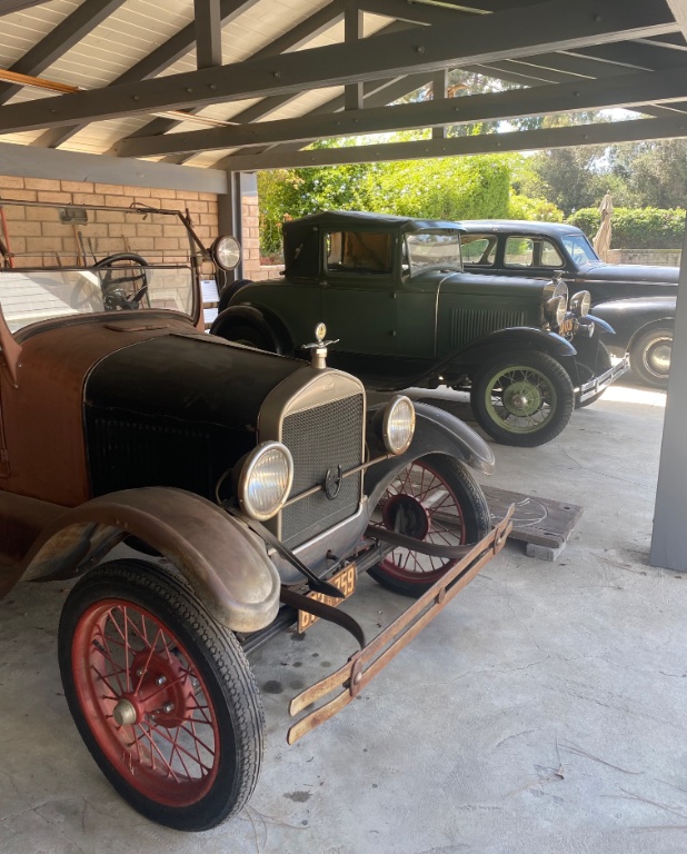

Post by Sean Butler » Sun Jul 02, 2023 11:01 am

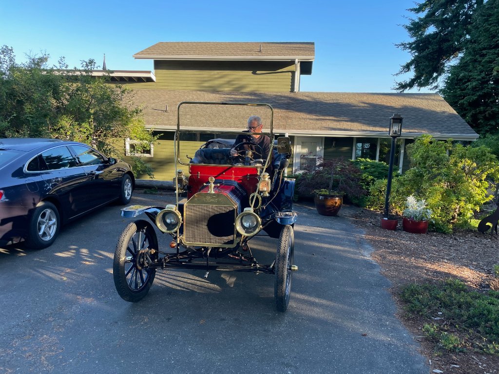

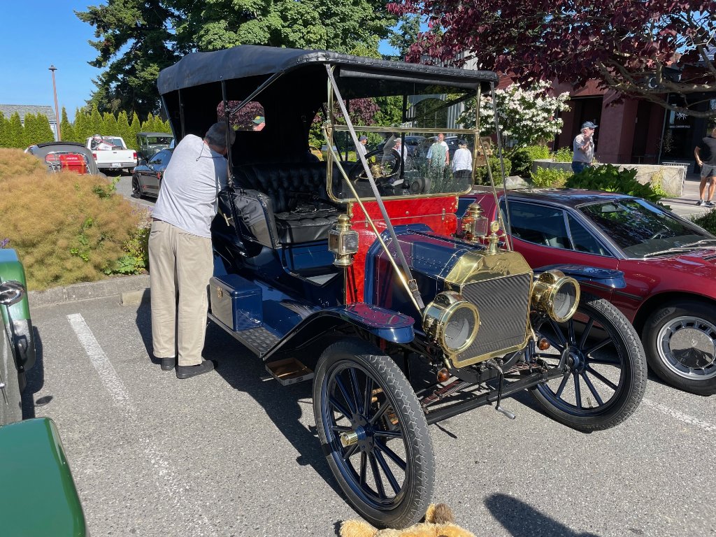

The weather finally made a change for the better. First true outing in newly acquired '11 Touring. Cars & Coffee in Freeland, Washington.

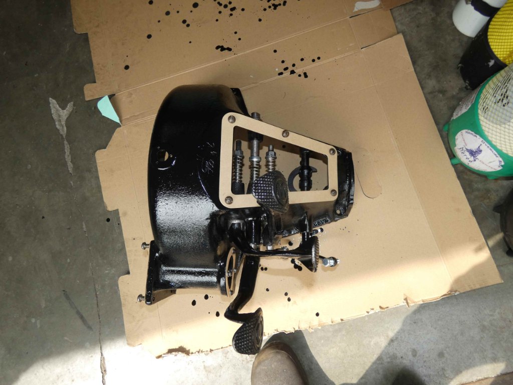

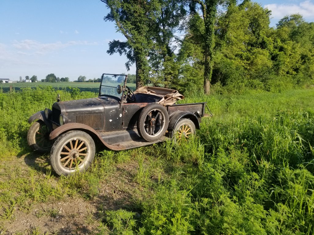

Well. I was just going to change the bands on my 22 touring when we ended up having to remove the hogshead because we thought only 2 of the 3 bands were demountable. Turns out the 3rd band was demountable only a different design. Then I found out I have 2 cracks in my brake drum. So it looks like were gonna pull the engine. Id be a good time to possibly tebuild the transmission and take a good look at the engine. It runs hot. Guess I'll be learning a lot about the Model T real quick! Haha!

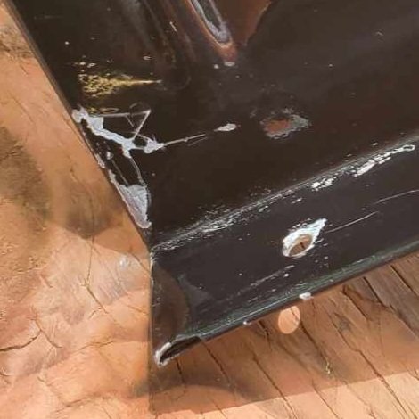

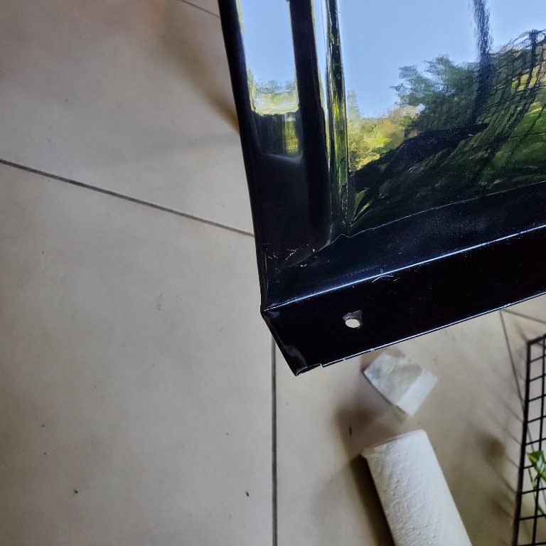

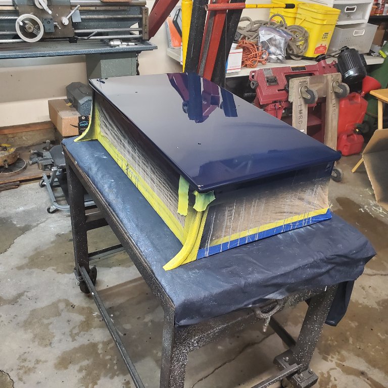

I've been busy repainting the rear seat riser on my 1912 roadster and doing some touch up on a rear fender I scraped struggling to get it installed.
By the way, I like the Nason single stage paint I'm using. Being an old school guy, I use a siphon cup gun and the paint flows nicely and is relatively inexpensive.
Were it not for the dust specs I would use it without color sanding or buffing

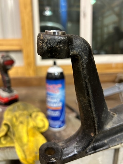

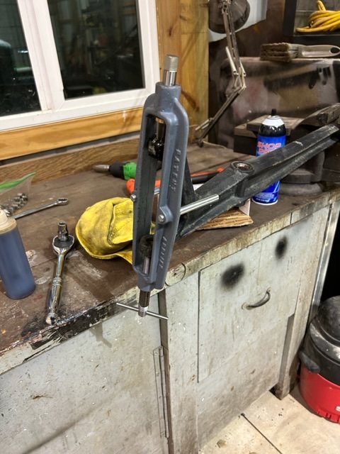

Post by Jeepbone1 » Wed Jul 05, 2023 7:28 am

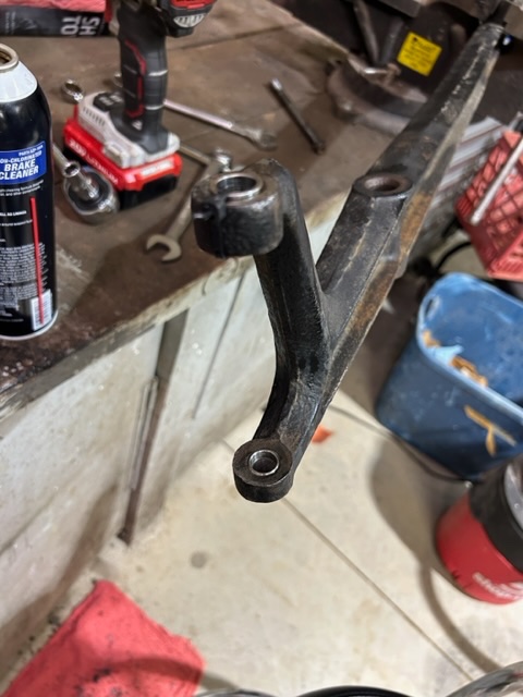

Finished installing stevens bushings on one front axle. I have a few more to go to have replacements ready to go on the shelf. Reaming takes a hot minute but it’s one of the best tools I’ve bought in a while.

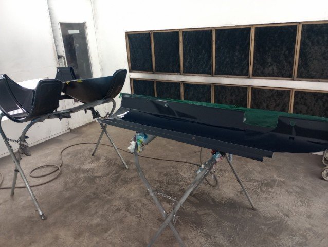

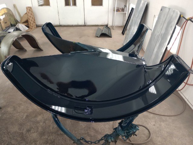

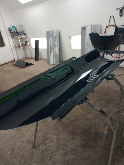

Pictures from my painter of splash aprons and rear fenders for my 1912 Roadster. Slowly but surely, stuff is getting done.....

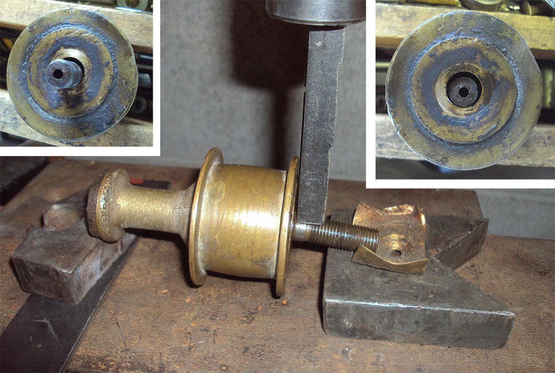

Some fan shaft work today. This end had been ravaged by some wrenches. I was able to pound back most of the damage to a size that the wrench would work on now.
I found this shaft was bent when trying to remove it. It wouldn't come out of the pulley. It was easy to straighten enough so it slid out smoothly without damaging the bore any further. I suspect something big "hit the fan", perhaps in removing the engine or after. A little more careful straightening and it could be reused.

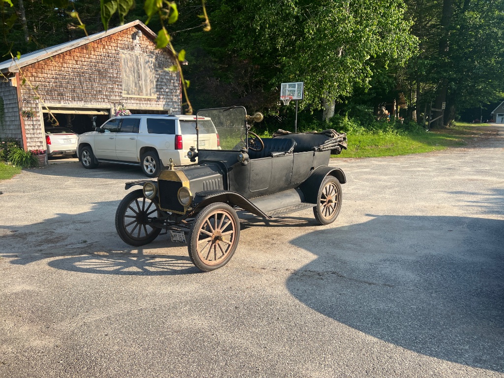

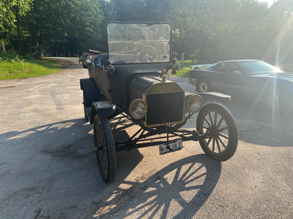

A little late, but today is Henry’s first drive this year!

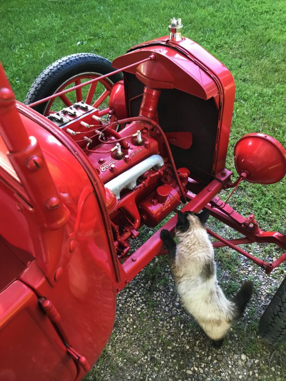

Did some generator repair. Then painted it and put it back on.
Cat inspected the work.

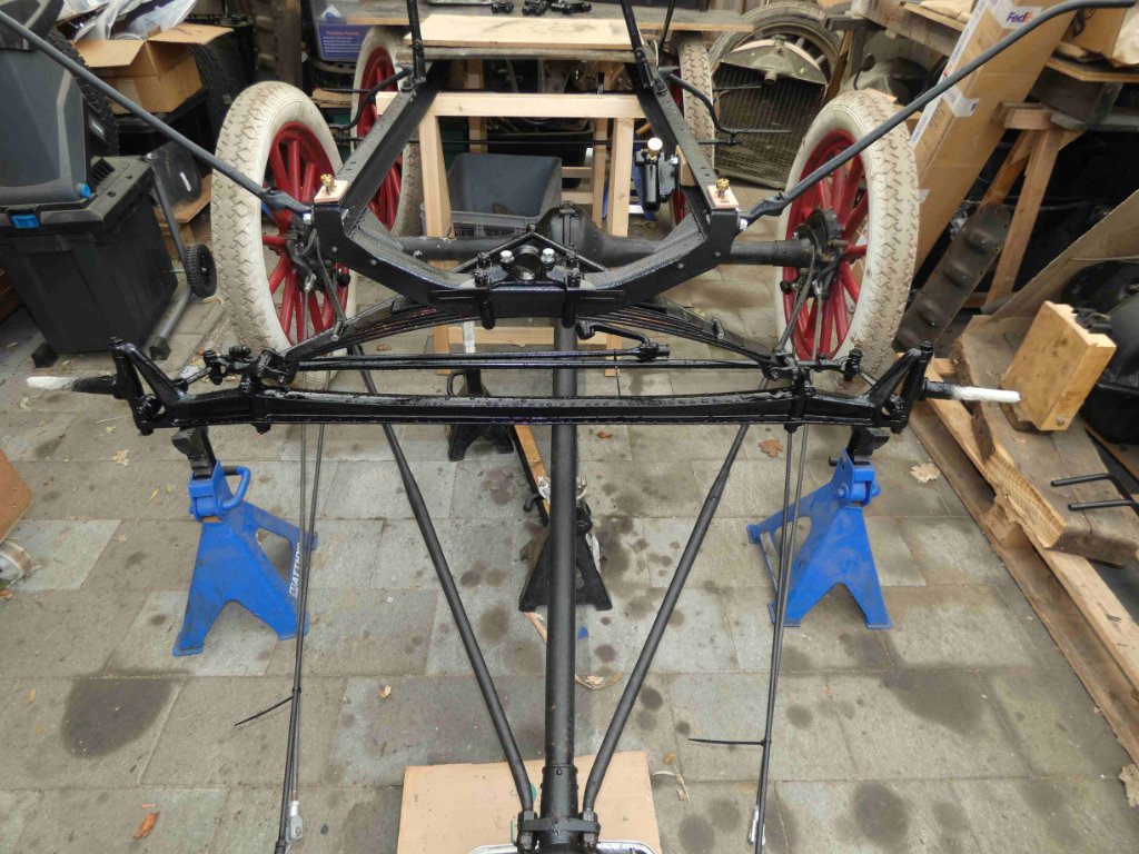

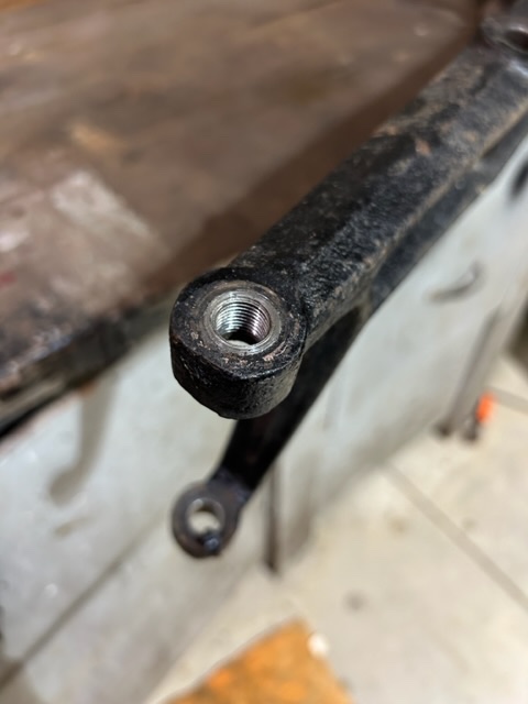

For the past week I’ve butchered a later wishbone (had a squared off ball) and machined down to .25” the wishbone under axle contacts and mated the 2 pieces to this $105 three part brass accy. Did this for safety’s sake on my 2nd runabout. Many of y’all know of Henry Ford being thrown out of the back seat of his chauffeur driven ‘15 touring when it flipped after the front axle buckled under due to a poor wishbone design. Now both ‘14 runabouts have this safety precaution. I also installed a transmission screen and mag post outside oil line 😎😎

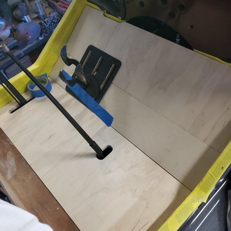

Post by RGould1910 » Wed Jul 19, 2023 5:18 pm

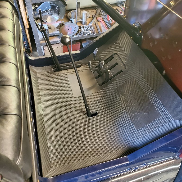

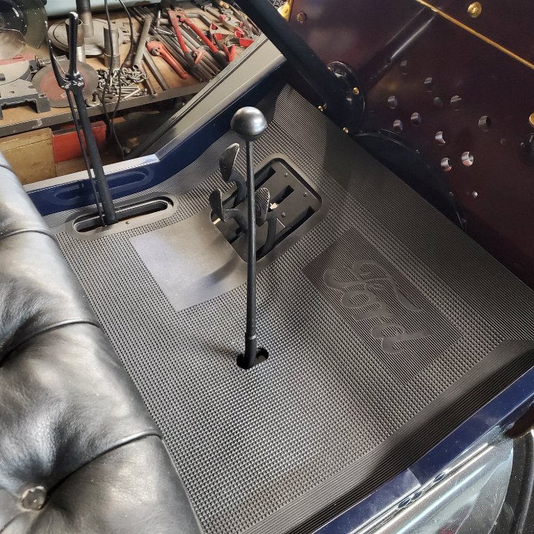

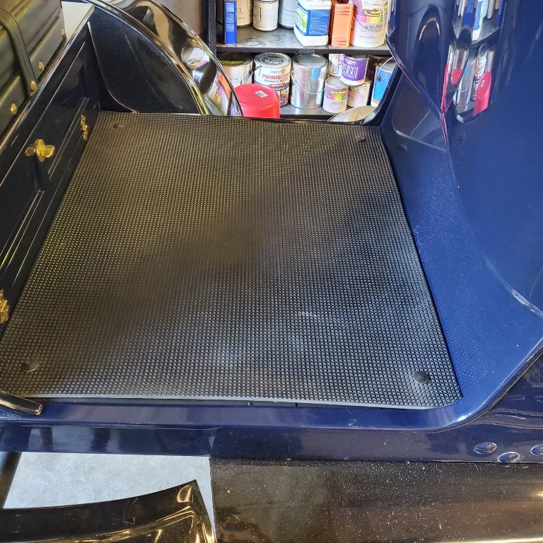

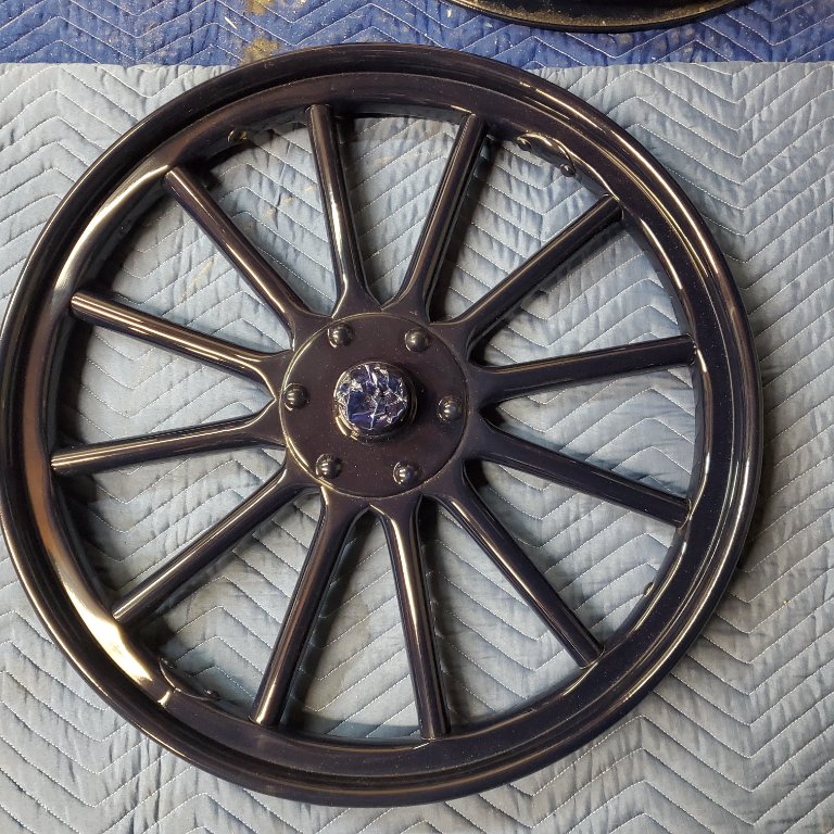

Got the wheels back from the painter. Getting ready to mount new tubes and tires.
Also finished making floorboards.

Looking good Richard!

Richard, your 12 Roadster is really coming along nicely! It's looking fabulous. I am behind you in my progress but made some today, picked up splash aprons and rear fenders from the painter. Going to focus on engine pan (taking to Brent Terry on Friday to straighten and thoroughly check out), recharge magnets, and make repairs to stripped magneto contact screw holes in the aluminum hogshead. It's a process, and it demands patience.

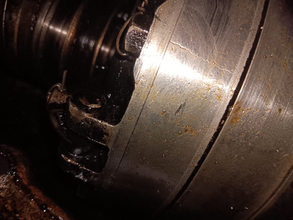

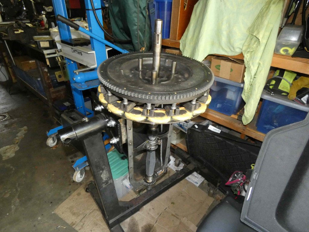

Post by DaveBarker » Wed Jul 19, 2023 11:03 pm

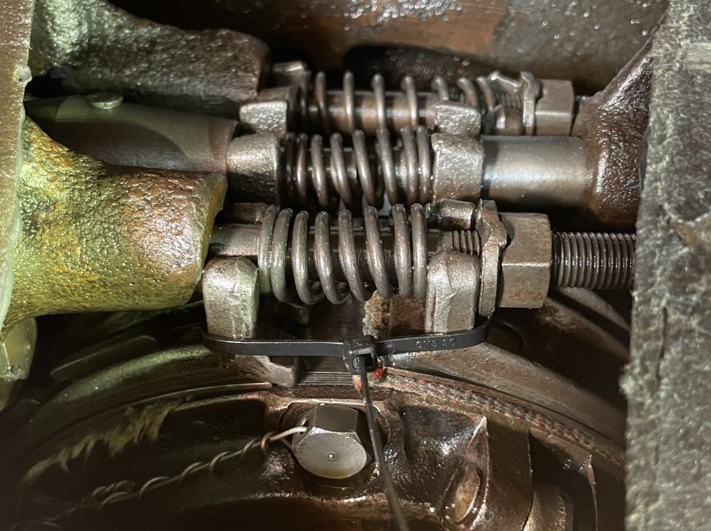

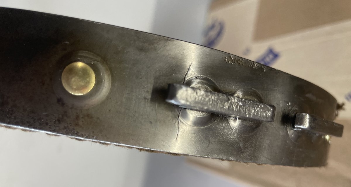

Checking my bands a few weeks ago, I found the brake lining badly worn on the left side; the right side looked great.
Decided to attempt the change through the inspection cover. :shock: Getting it out wasn't bad. Once removed, I found the reason the left side was worn so badly:
Had to take the cowl off the Speedster to get the new band with new lining pulled around the drum, but that gave me the room to pull it around.
Now all good and ready to run!

Thats typical wear. Nothing to do with the crack.
I hope you didnt repair that band. It needs pitching.

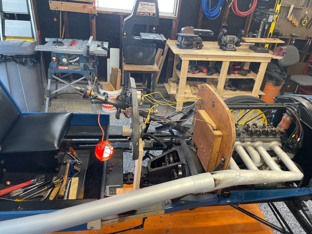

I removed the exhaust pipe, wrapped it with exhaust pipe wrap and reinstalled the pipe. I fabricated a heat shield and installed it. Now, I hope to prevent roasting my wife when she rides along.

Post by DaveBarker » Thu Jul 20, 2023 6:48 pm
John - I pitched the cracked band, as you mentioned. I had purchased three refurbished bands from a vendor in anticipation of possibly replacing all three with Kevlar if I had to remove the hogshead. Next time, for sure. Not a job I want to do more than necessary.

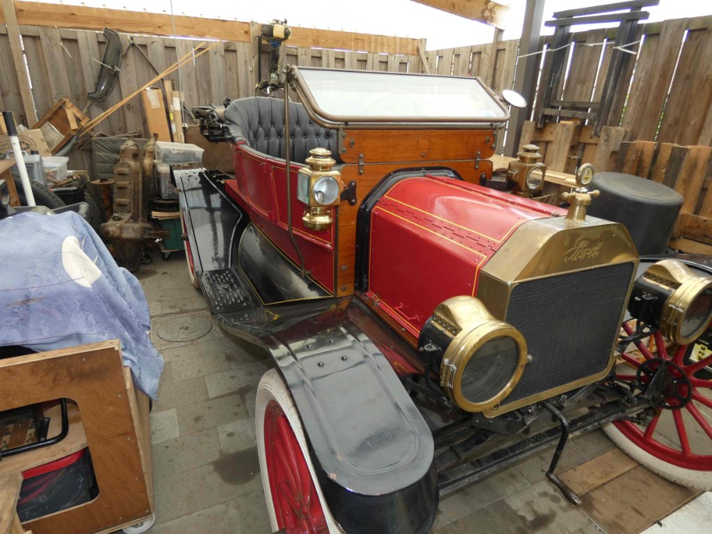

hello all,
In June I started the rebuild of a 1911 Torpedo.
Today I installed the rebuild front axle on the cleaned up frame.
The engine will be in at end of next week.
Leaving for a short hollyday tomorrow.
Andre

Post by Dallas Landers » Sun Jul 30, 2023 8:50 am
Nothing big. Stopped for a photo on the way home from town this morning.

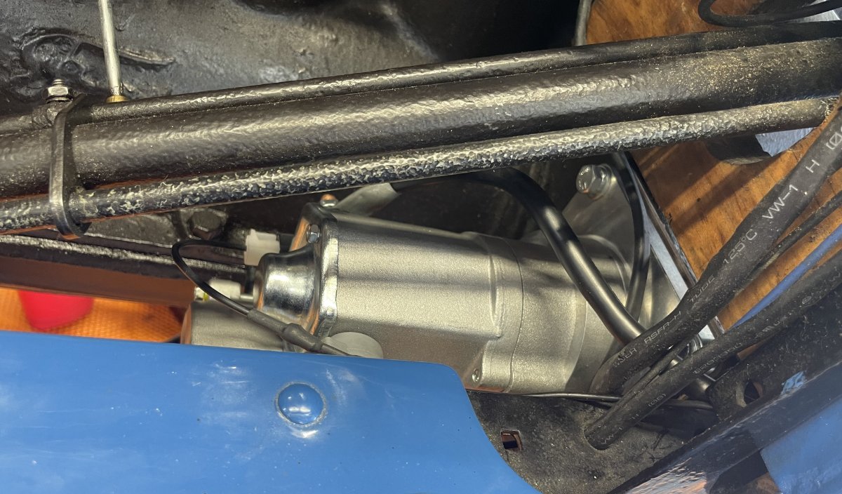

Post by DaveBarker » Sun Jul 30, 2023 9:20 am
Got my WOSP starter installed (bought it here on from the Classifieds) in the Speedster! Works great. Just thinking ahead to when I might not be able to hand-crank it over (extra compression with the RAJO head). Thanks to everyone here on the forum that provided feedback, advice, and guidance through the installation. Much appreciated!
Here's a link to a short video I made of the first start.
https://youtu.be/w-bzcBVsv4E

Post by RGould1910 » Sun Jul 30, 2023 3:24 pm

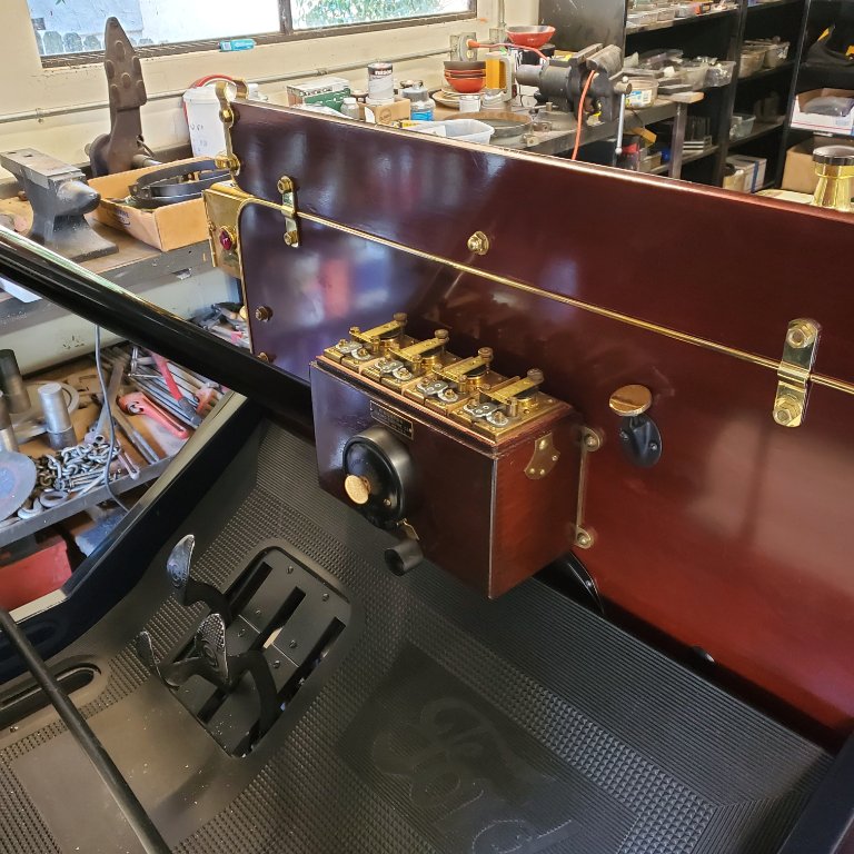

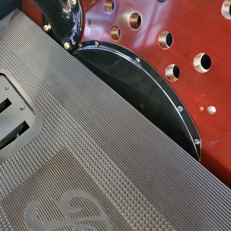

Continuing to make progress on the 12 roadster.
This week I finished the floor boards, cut the floor mats, modified and installed the heat shield and installed the coilbox.
The coilbox is my own creation . A smaller repro box to accomodate later coils with a repro Kingston switch and Splitdorf brackets.

Replaced The Mincie in the fire truck, Changed to a 10 tooth pinion, cleaned the block & radiator out. Much better driving now & runs in 115
degree heat without boiling when you shut the engine off.
