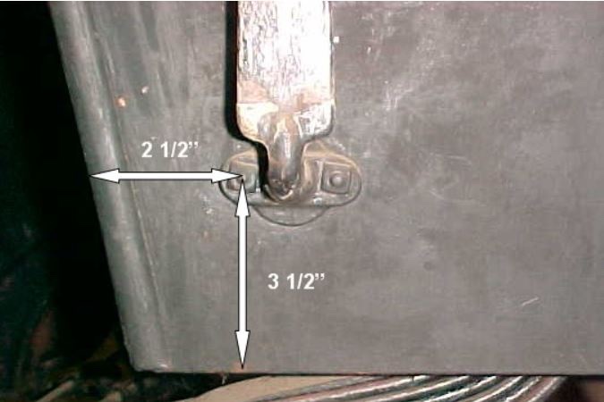

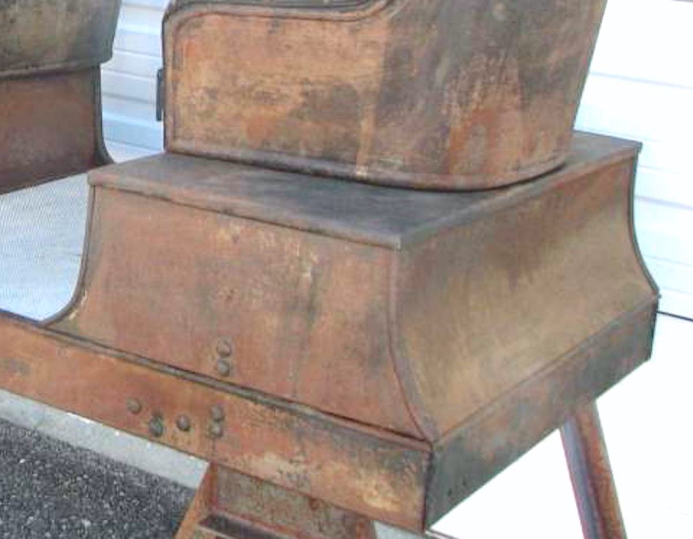

These photos may help.
The rear shot is from a 1912 Commercial runabout that has been for sale on eBay. Close up shows holes where the taillamp bracket would be. Wood screws won't hold the hanging weight or the vibrations. Carriage bolt on the wood side, and square nuts out. The other photo is an original1911-12 touring, and shows the mounting hardware.
View of taillamp position.

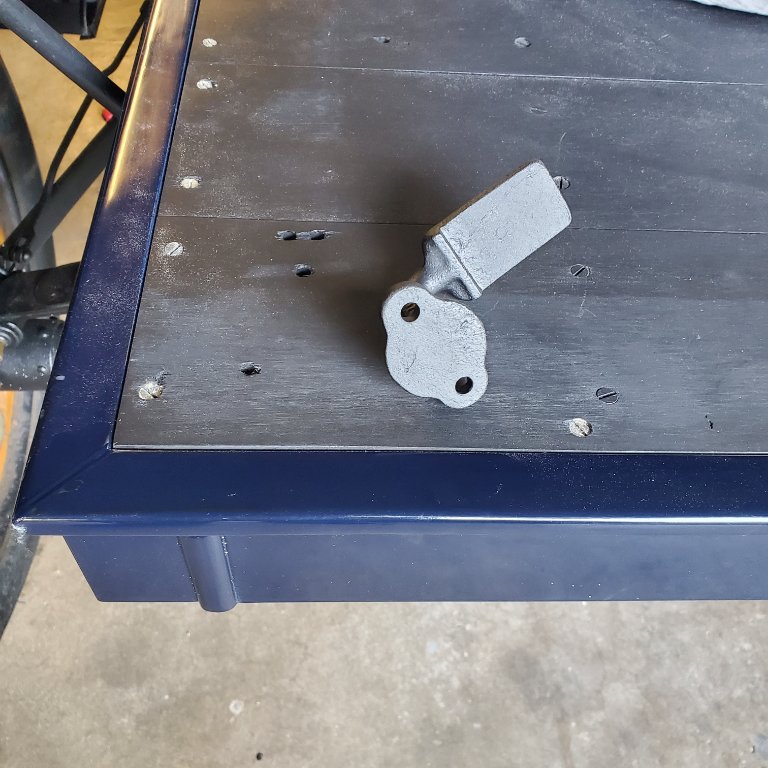

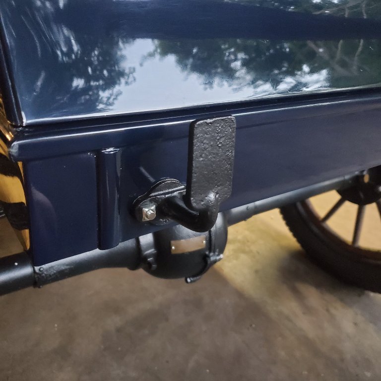

Re: Position of tail lamp bracket, 1912 roadster
Lamp bracket Installed. My rear panel is not quite the same a the original picture but the placement of the bracket is close to the same.
