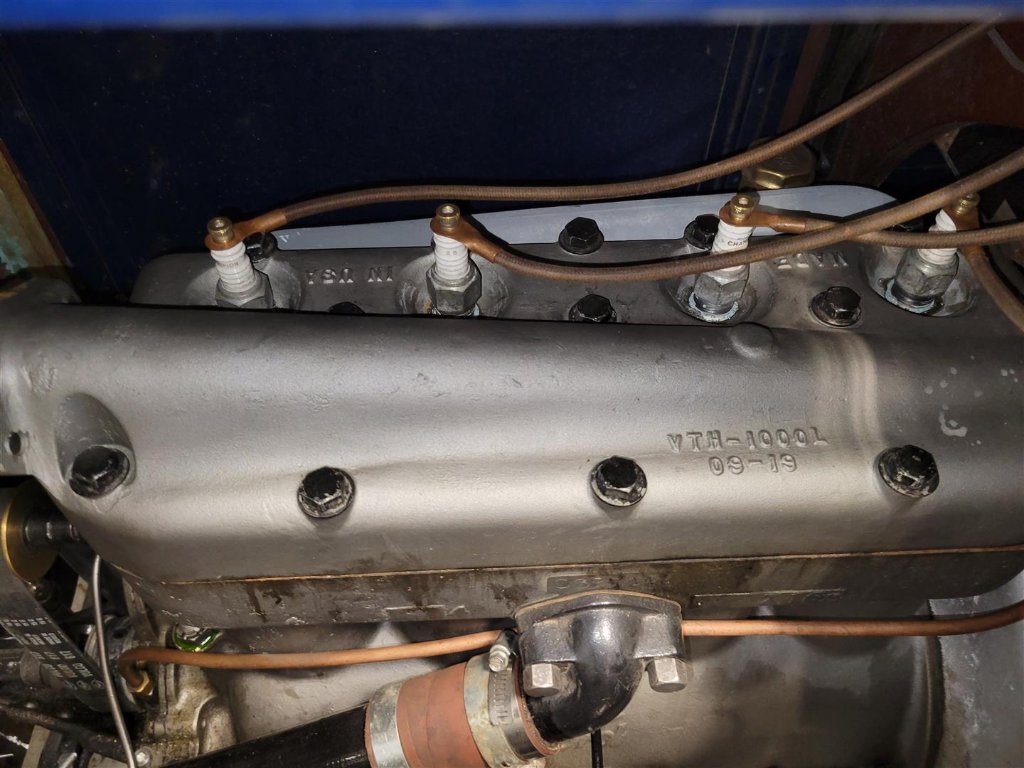

I have this high compression low head on my 14 roadster. I'm wondering what make it is. My 11 has a factory Ford head on it and doesn't perform nearly as well. I'd like to find another one of these heads

That head comes up for question every now and again...I don't think anyone has ever positively identified it. I find that a little surprising as we have some vendors who have been in the game for a very long time and I'd have thought that someone would remember, but they apparently don't.

Look inside the water outlet passage and you will see Reeder cast in it. It’s almost a 6-1 compression ratio.
Early Ralph Reeder head.

John, thanks for that. Learn something new every day or the day's wasted!

Thanks John and Scott. I had suspected it might be a Reeder head.
Now the search to find another one.

Reeder even made some ford script high compression low heads in the early days.

I have a Ford script Reeder head on my '23.

PARKER was another maker of low aluminum heads, also his name inside the water port.
