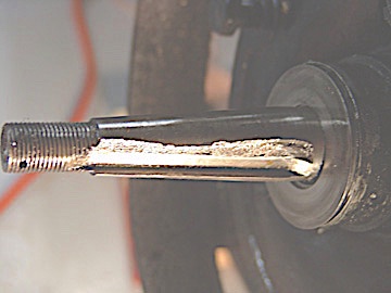

Hi All,
I've seen an example of a rear axle where the keyway was very damaged, and wondered if anyone had attempted to do any welding and grinding to get the keyway area back to normal. Is this a practical thing to do? I have some slight damage on the axle at the keyway and wondered if I could/should attempt to repair it so the key will stay in the slot better. Thanks,
John

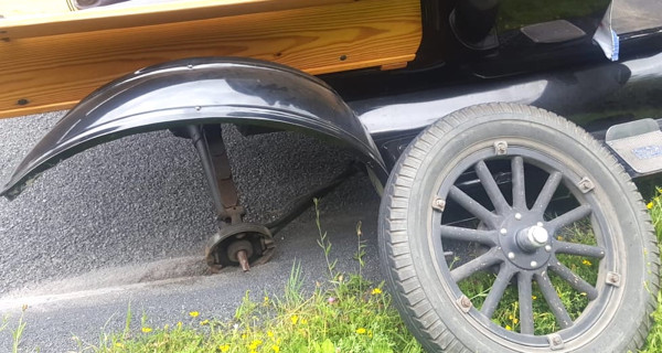

I wouldn't do it! Breaking an axle while on tour could cause you to get stuck or worse cause you to roll over.

Re: weld repair on axle by the keyway
As a farmer I would make it right. not all of us are idiots.
but it would really be nice to see a Picture of said axle!

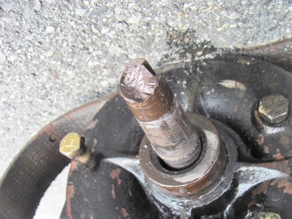

Hypothetically speaking one could be on a long tour, say the one approaching in eastern Europe. One day you get something that warrants looking at the hub and a worn keyway is found. Do you abandon the tour? Stop and wait for a new axle to arrive? Or try to repair and keep going? I'm betting you could find a shop for a temporary repair. Although sometimes those temporary repairs outlast the car . .

Dan said the word I have been waiting to hear…..fatigue! As a lifelong machinist and metallurgist with years of test experience, I can, without reservation, say that most if not all T catastrophic axle failures are the result of fatigue. The T axle is continuously flexing. It doesn't take much of a stress riser to induce the start of a fatigue failure millions of flex cycles later. The NOS TT axles that I recently modified and installed had a HORRIBLE stress riser as machined. The turning cuts on both ends of the axles contained a dead sharp 90 where the turned section met the unturned diameter. I removed the sharp corner with a .06”R and then polished these areas. No doubt, any PROPERLY done repair cost would exceed the purchase of a new axle.

Chadwick, we need to differentiate between patch and repair. For a tour patch I would find a way to keep the key in place (gum, glue, whatever) and tighten the s**t out of the hub. Leave the cap off and check it often. By now it should be clear that welding is the worst option. As John mentioned in the first reply, you can fashion a stepped key if need be.
Andy
Andy
- Posts: 5267
From Oldav8tor:
"FWIW - the buggered keyway is probably due to the axle nut being loose. I have seen dozens of axles ruined in this manner. Check you axle nuts - they need to be tight, really tight!"
The root cause of your axle keyway wear was a loose moving axle & hub.
The key isnt supposed to hold the wheel from turning. Its a proper fitting taper on both mating parts.
Ideally or correctly, You want to restore the taper fit before finish install. Thats done by lapping the axle & hub with lapping compound. That will take down the high spots in the tapers. The wheel fit is more important than the key fit.(think of your chuck as held in a drill press. taper fit, no key.) Then keep the nut tight. The axle nuts will need 2 or 3 torquings after a re-install, typically, as the high spots on the tapers wear down(unless you lapped the tapers), making the wheel loose again. Make checking the axle nut torque part of your annual service @ a minimum.
If I have understood your situation correctly. your "slightly" loose key could have been solved with a few prick punch hits on the key on the bottom edge to hold it securely to install the wheel & not have a loose key move inward to damage the outer grease seal.

I've welded one for a guy. He drives next to nothing and did not want to spend any money. It's still in the car. I would not tour with it but a parade would be fine.
- Posts: 5267
Unfortunately, the next caretaker might be a gung ho driverCordes_jeff wrote: ↑Sun Aug 27, 2023 3:48 pmI've welded one for a guy. He drives next to nothing and did not want to spend any money. It's still in the car. I would not tour with it but a parade would be fine.
with a possible surprise waiting.

I agree with mike and would prefer a new part. I was going to post something about stress risers if the machining doesn't properly radius any cuts. Think crankshaft journals.
