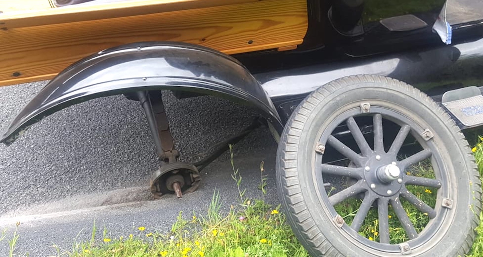

Post by DanTreace » Sat Aug 26, 2023 9:56 am
Replacing with new is much safer. T axles are now over 100 years old, and fatigued. And many do fracture at the keyway, from loose hub.
Cutting a new key way 180 degrees away would induce more chance of fracture in such an aged used axle. MY 2 Cents.
So nice to have new quality T axles made in Taiwan, to the Ford print, and correct in all aspects for just $115.
Where and why could you have an old busted T axle welded-up and machined back for the little expense of a new?
broken axle at keyway.jpg (115.36 KiB) Viewed 4430 times
busted keyway.jpg (31.41 KiB) Viewed 4430 times

Chadwick, we need to differentiate between patch and repair. For a tour patch I would find a way to keep the key in place (gum, glue, whatever) and tighten the s**t out of the hub. Leave the cap off and check it often. By now it should be clear that welding is the worst option. As John mentioned in the first reply, you can fashion a stepped key if need be.

From Oldav8tor:
"FWIW - the buggered keyway is probably due to the axle nut being loose. I have seen dozens of axles ruined in this manner. Check you axle nuts - they need to be tight, really tight!"
The root cause of your axle keyway wear was a loose moving axle & hub.
The key isnt supposed to hold the wheel from turning. Its a proper fitting taper on both mating parts.
Ideally or correctly, You want to restore the taper fit before finish install. Thats done by lapping the axle & hub with lapping compound. That will take down the high spots in the tapers. The wheel fit is more important than the key fit.(think of your chuck as held in a drill press. taper fit, no key.) Then keep the nut tight. The axle nuts will need 2 or 3 torquings after a re-install, typically, as the high spots on the tapers wear down(unless you lapped the tapers), making the wheel loose again. Make checking the axle nut torque part of your annual service @ a minimum.
If I have understood your situation correctly. your "slightly" loose key could have been solved with a few prick punch hits on the key on the bottom edge to hold it securely to install the wheel & not have a loose key move inward to damage the outer grease seal.

I've welded one for a guy. He drives next to nothing and did not want to spend any money. It's still in the car. I would not tour with it but a parade would be fine.

I agree with mike and would prefer a new part. I was going to post something about stress risers if the machining doesn't properly radius any cuts. Think crankshaft journals.
