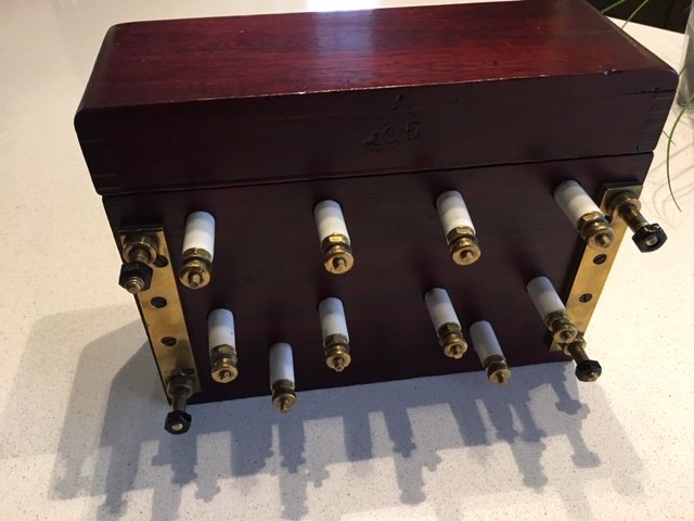

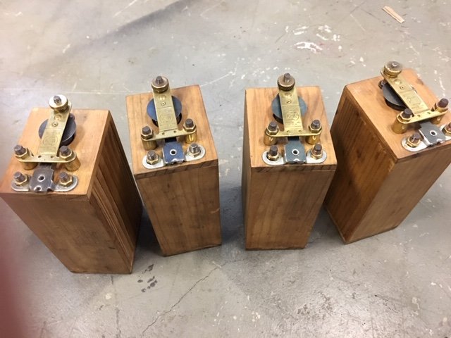

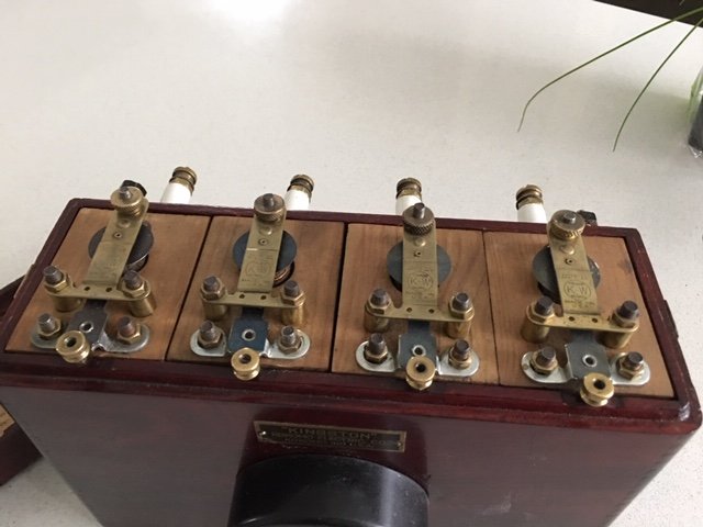

I bought couple years ago at Hershey a Kingston coil box for my 1911 touring car with coils. But I do not know how the wiring inside the coil box is supposed to be from the coil box switch. The one I bought do not have any wires inside. So, I need to know how to install wires in the goal to switch from coils to Magneto accurately. Can someone send me pictures and Diagrams in the goal to understand how to fix that please?
Here couple pictures of what I have.
Thank you in advance for the help.

Well, you do have quite a mix there. I had not seen the modification done to the coils which was obvious in the pictures, but did not notice. Someone has grafted new/wrong points on those coils? The correct coils come left/right, with offset contacts on the "front" of the coils so as to line up with the contactors in the coil box which you will see are not perfectly equal in spacing.
Take a look at this for information...you'll see there is quite a variety of coils that many folks are unaware of...
http://www.mtfca.com/coils/Coils.htm
Turn your coils around so that we may see the side that faces the porcelain posts/contacts. Need to see all 4 at once. Thanks.

So let’s answer the wiring question first. If this is the box you’re talking about and it came like it looks now more than likely the wiring is connected in the box. There are slots and holes that are drilled in these older coil boxes that exit out behind the switch and connect inside the switch. Don’ fix it if it’s not broke. The coils you have pictured look more square than rectangular which leads me to a couple of thoughts. Can you take a picture of the bottom of your coils? Looking at the picture supplied leads me to believe that someone modified some coils to fit the box or modified the points to fit the coils. If the first is true you will need to look on the bottom to see if the contact is in the center of the coil or on the edge of the bottom so it will make contact with the spring in the bottom of the coil box, if the latter is true I noticed that the back of the points have been cut or at least it appears to me to be so. If the retainer thumb screws are used to hold the coil down it could change your spark. As Others have Said RV IS THE MAN ON EARLY COILS. REACH OUT TO HIM.

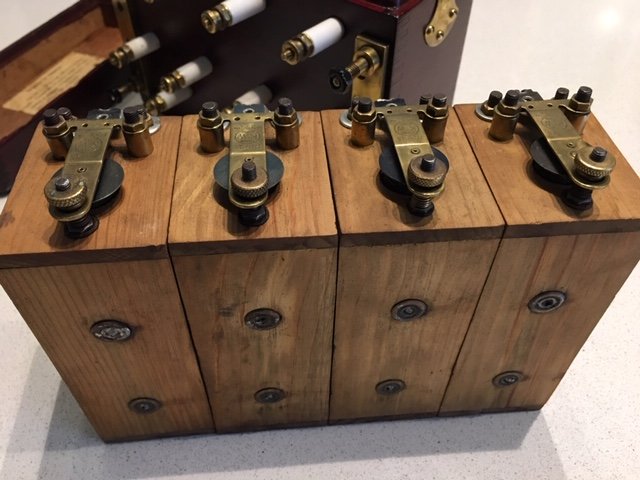

Also I check the all 4 coils with my tool and they work properly. Here other pictures:

Well, you've made a liar out of me...sure looks like everything lines up.
OK, the center/off position of the switch should have a contactor under it that goes to the lower/bottom strip that forms the common connection on the bottom.
The driver's side lower porcelain post should have a wire routed from it to the switch that would correspond to the MAG side of the switch...meaning that when the switch is moved over to MAG connection, there should be continuity from the MAG porcelain post to the bottom of the case (all four coils) and NO CONTINUITY to the other lower (BAT) porcelain post.
Passenger side lower porcelain is the BAT terminal and all advice above is applicable to this side as well.
good luck! and sorry for the bad info, the last photo you just posted pretty much answers it for me (certaily helped!)...I just wasn't expecting to see modified Williams style points on what you have... :)

Just got back from Luray, as most of you guys on the Forum should have. Great little meet that is on the way up. For its proportionate size, I believe it has more early parts than Hershey or Chickasha. Y'all owe it to yourselves to CHECK IT OUT.
It looks like Mario has set of home built coil units that someone put together using KW style points.
Dan's photo shows the general plan of the switch wiring except that the "common" connection to the spring contacts in the box bottom is at the top of the switch rather than the bottom.

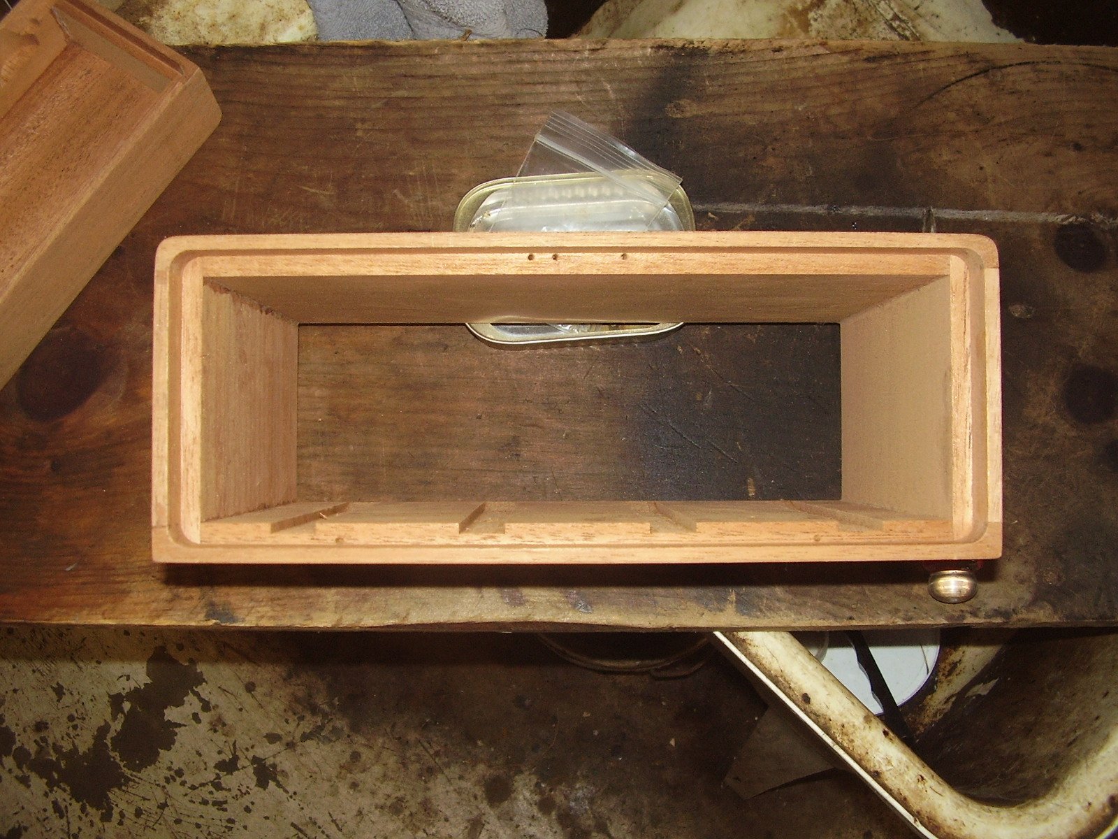

Here is a new Kingston coilbox. The first photo shows the recess on the box underside where the two pieces that make up the bottom fit into. On the side closest to you, you can (faintly) see two holes out towards the box sides. (They are each located just inboard of the outermost grooves for the terminal spring ends.) Those holes are drilled at an angle and they intersect with the lowest holes on the engine side of the box, the MAG and BAT terminal bolt holes. The wires for those bolts are soldered to them, and then they thread through those angled holes and come out of them where you see their ends in the photo. The wires then go into the narrow grooves in the panel that you see in the next photo; the BAT wire heads off toward the right and the MAG toward the left, looking at the bottom of the box as shown. The wires follow and lie in the grooves, making two right angle turns as they head towards the switch side of the box. Once they get there, the wires go into the holes you see in the first photo on the side furthest from you, where you see the three holes that are somewhat close together. The BAT wire goes into the hole on the right and the MAG goes into the hole on the left. From there they both head up into the switch wire holes where they exit the box and are connected to the switch. The center hole (of the three) is for the "common" wire, one end of which goes to the coil springs in the box bottom. The other end goes directly up into that center hole and exits the box through the uppermost switch wire hole, where it connects to the switch at its uppermost terminal. To be safe, I always cover the wires in the grooves with a strip of electrical tape to prevent shorting with the "common" wire.
When assembling the wired box, you have to pull the wires tight as you go. It's very easy to "pinch" a wire and this leave a bit of it exposed, which you definitely don't want as it could cause a short.
Hope this helps.

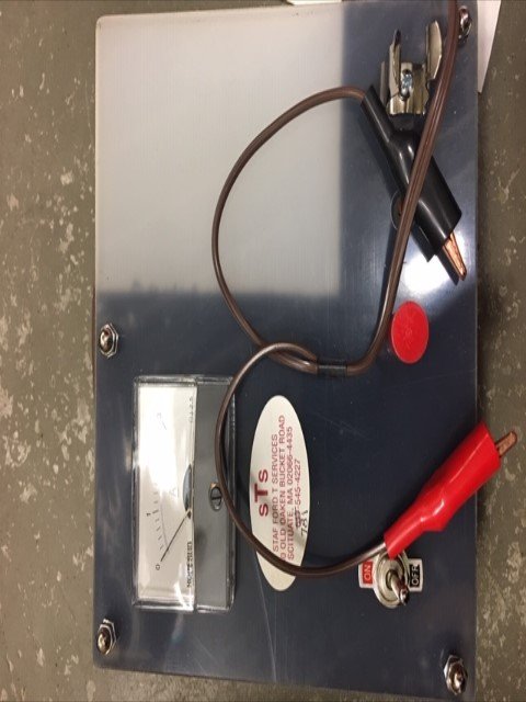

My 1911 Coil-boxes' connections were on the customary way, with the MAG on the driver's side and the BAT on the passenger's.
I also check the Ohm resistance and it’s look great. I also check the resistance on each coils and they look good either. What is your recommandations about adjusting early coils. I will post a picture of he tool I used usually.
Kind regards,

Unfortunately, because of their designs, the only sure way to calibrate the early coils is with a hand cranked coil tester. The so-called "buzz box" style of "tester" will not work for them. You can use it to find out if it works and to set the amp draw but that's it; you won't be able to check for proper operation on the magneto or to check for the double sparking that is the bane of these early units. Coils with new points are highly prone to this. The armatures are essentially sheet metal which is usually loaded with stresses that must be worked out before they can perform their best. The best way to do this is to drive the car to break them in, realizing as you do that an occasional, irregular "hiccup" from the engine is normal and will disappear in time. Because of this, I set up newly rebuilt or reproduced coils on the tester and ignore occasional, irregular double sparking. Steady or constant double sparking, however, is not acceptable and the coil will need its points re-set or in rare instances replaced before the coils are released to the customer.
None of this is available to users of a "buzz box."
