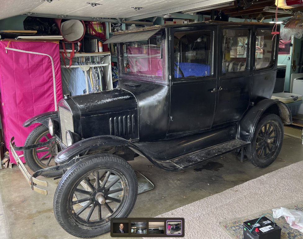

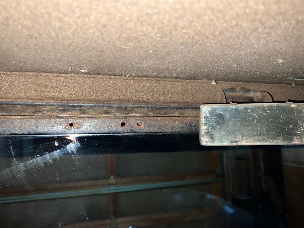

Hi All,
I'm looking for a manual windshield wiper for my 1924 Model T Fordor. There are three holes above the glass and I'm not clear what's supposed to go into each hole or where to source a proper wiper assembly. If anyone has any reference pictures of a 1924 closed car with an original or nice aftermarket hand wiper correctly installed, I would appreciate it. I searched the Internet and found the 7801LSS wiper assembly on Lang's, but it says the shaft has to be lengthened and I'm not adept at welding or fabrication. Would like to install a nice period-correct appearing wiper in the car. What are my options to fill these empty windshield frame holes?
Thanks,
Jeremy
Thanks,
Jeremy

Your T used a hand operated wiper that needed only one hole directly in front of the driver. The other two holes are not needed and can be filled in. There may have been, at one time, a wiper operated by a vacuum motor. Hand operated wipers are a pain to use. Luckily, Your T has a sunvisor (rainvisor) that really helps to keep rain off the windshield so you can spend your time wiping condensation from the windshield inside the car. Jim Patrick

Thanks Jim, then I’ll install a new hand crank wiper using the hole closest to the driver’s window if I can find one that fits my Fordor. What are T owners filling the extra holes with? Perhaps, some JB Weld and then sanded down smooth and painted black?

Jeremy, the scratches in the glass indicate that the larger hole between the two was where the wiper was fitted.

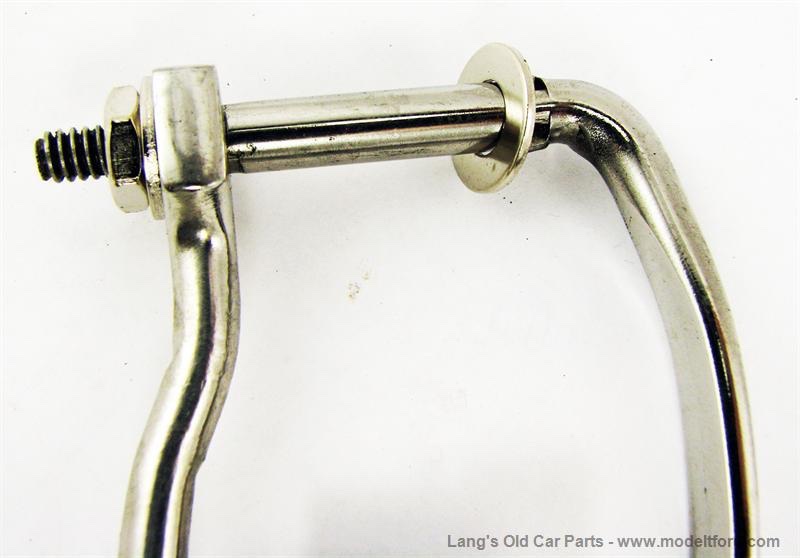

How does one go about extending the shaft on the wiper that Langs sells to make it work on a closed car? Has anyone done this and is there a write up or pictures anywhere? Otherwise, if someone has a nice period correct looking hand wiper that fits my Fordor they want to sell, send me a message with details and price

Yes. JB Weld, Bondo putty, or Aluminum Devcon putty will work fine to fill the holes. My Fordor had a steel sleeve the length of the shaft through the hole that was flush with the exterior frame surface, with the extra length protruding into the cab. If your wiper hole was above the windshield frame hinge, through the headliner, there would be a problem because the wiper, being above the hinge, would prevent you from opening the upper frame, but the hinge of your windshield is above the wiper hole which means the wiper hole goes through the windshield frame, which when the upper windshield frame is tilted out, the wiper will tilt out with it. No problem at all. Jim Patrick
PS. Jeff, being spring loaded by means of a flattened upper vertical wiper shaft (see closeup photo), it stays tight against the windshield so it stays up out of the way until the next rain, when you use it, but for it to work, it must be tight and there can be no slack. You may want to call Lang’s and ask them if they have the sleeve, or whether or not they offer the horizontal wiper shaft in a variety of lengths.

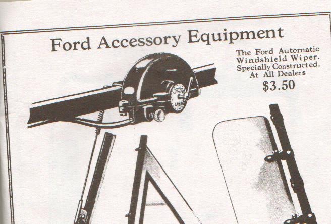

It appears there was an accessory wiper, most likely vacuum (maybe electric if some wiring was present) mounted at the 2 outboard holes & which usually had a "manual" knob or lever to activate the wiper from the inside. As Allan eluded to the larger hole was where the wiper shaft went through due to the glass scratches showing.

The hole, being larger, the horizontal wiper shaft will most likely require the sleeve (adapter) I discussed as the shaft will be too small to fit the selected hole. You’ll need to make one. Jim Patrick

- Posts: 7156
Re: Hand Windshield Wiper for 1924 Fordor
If patina/history is the aim, just leave the holes as they are. They are part of the car's history. Just make up a story to explain them.
If you do make a sleeve to take the wiper shaft, take all necessary steps to make the hole/sleeve square to the glass. When they owners fitted a wiper to Henrietta, the hole they drilled allowed the blade to make limited contact at one end of the stroke. I corrected this when fitting a sleeve in the frame.
Mention was made of keeping the blade up when not in use. One one of my cars, a brown shoe lace is tied to the mirror, and a loop goes over the arm knob. I even polished the brass aglets once.

Considering the holes are there, why not install a Model A vacuum or electric wiper?

The sleeve is like a tube with a outside diameter the same as the hole opening and an inside diameter the same diameter as the horizontal shaft and a length the same as the length of the shaft from front to back. It should be positioned with the end flush with the outside surface of the frame. I would secure it with a two part epoxy inside the frame to hold the sleeve from the inside of the frame, or if you are good at soldering perhaps you can solder it. Whatever way you choose to secure it in the hole is up to you. Maybe you can tap the inside of the hole and thread the outside of the sleeve so it can be screwed into the hole from the interior by means of a large screw driver inserted into two opposing grooves cut into the rim of the sleeve on the interior side.

The sleeve may or may not be needed, that depends on the size of the hole the shaft that goes through the frame and how loose it is. You could make your own out of brass tubing if needed. If the blade does not stay up out of the way on its own, it does not have enough pressure pushing it against the glass to wipe. The arm between the blade and were it goes through the frame would need to be bent a little at a time till it stays in place.

OK, so a brass sleeve for the wiper shaft to rotate in, got it. I'll MacGyver something as I don't want the shaft just spinning freely in the frame hole.
If anyone has any close-up pictures of a wiper installed with sleeve, feel free to share them. I also ordered the Lang's chrome side hinge mirrors for my car and understand I'll need to do some filing/grinding to make them fit. The car will feel "complete" to me once those accessory pieces are installed.
I'll update this thread with photos after I get the hand wiper installed

Thanks Jim, you are a wealth of knowledge! Do you know if the sleeve welded or pressed into the frame on that car? The wiper looks very cool when properly installed. I can't imagine ever using it, but showing someone a vintage manual wiper might strike up an interesting conversation.jiminbartow wrote: ↑Wed Mar 08, 2023 10:36 pmI found a picture online of a Fordor that may help. Being black, it is a little hard to see, but if you look hard, you can see the sleeve. You can enlarge the picture with your fingers on the screen. Jim Patrick

If the hole in your frame is a little big you can use a piece of plastic tubing, plastic bushing or etc. You can find them at Ace hardware in various sizes. Find the correct size and cut to fit. Should work OK. They also have metal sleeves and bushings in various styles. That might work too.

On the assembly line, the sleeve was probably spot welded or brazed when the windshield frame was being made, but since using heat now, would damage the paint patina, burn the rubber, or break the glass, I would not try that. Instead, I would consider getting a sleeve tube slightly larger than the frame hole and threading the end of it enough so that when it is screwed tight into the hole, the end would be flush with the outside face of the frame, then tap the hole the same thread size and TPI as the sleeve threads. Use some thread lock to keep it tightly in place. Once you get the wiper, you can drill the center hole the same size as the shaft. Slightly bend the vertical shaft toward the windshield so that there is enough blade tension on the glass to hold it up and out of the way. People really get a kick out of seeing a working hand wiper. Good luck. Jim Patrick
PS. Go to www.McMaster.com and type “spacers” in the search box and you may be able to find some sleeve stock for your project. They come in various materials, finishes, O.D. and hole ID sizes and lengths. You may be able to find others by typing different names in the search box. They also sell taps and dies for threading.
