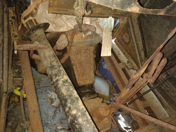

Here is a picture of what I came across.

- Posts: 5545
Re: Center Brake Lever?
Could be something like a Chevrolet transmission added on that would have had the parking brake lever mounted on it. Many cars and trucks were made that way. Not an aftermarket one built for Ford T's, most all of those would have used the stock parking brake rod and lever.
Duey_C
- Posts: 1558
- First Name: Duane
- Last Name: Cooley
- Location: central MN
Neat pic.
Aww poo, I was hoping to see a version of a centered brake handle and accoutrements.
I believe the user of the late TT here unbolted and tossed the brake/control shaft since he was in and out of the door a lot.
Couldn't blame him. This truck is easy to get in and out of without.
With the Warford in neutral, start it up, center the clutch pedal, step on the brake and put it in gear.
A lever in the middle would be neat and more handy. If time allows it, I'd like to try doing that.
