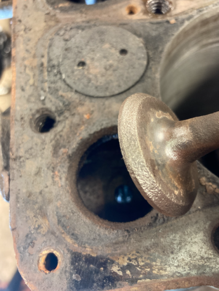

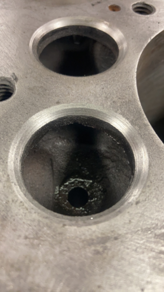

My T sat for a while, and at least one of the valve seats got rusty and pitted. I have all new valves coming, and i'd like to clean up the seats also. I see various valve seat cutters on eBay used for under $100, but I'm leery. I don't want to spend $350 on a Neway tool that I'll probably never use again. Who can help me out?

Without knowing how much other work you plan on doing, my suggestion, if the motor is out, take to machine shop with one of the new valves and have the 3 angle seats done there. The 3 angle will give better sealing and flow.

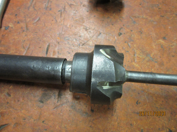

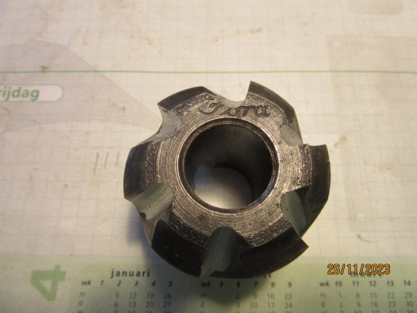

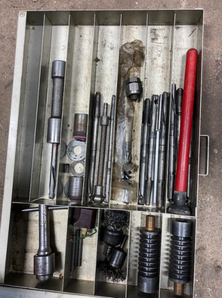

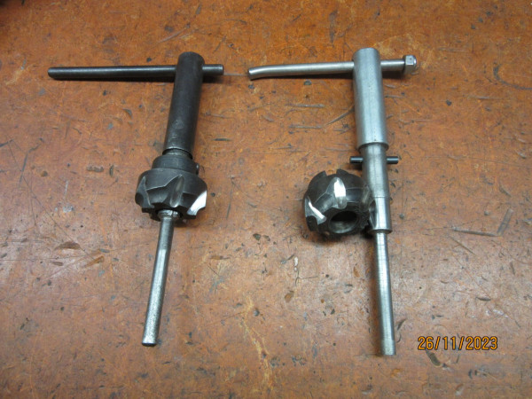

I have lots of used valve seat cutters. They all have one thing in common: they're dull and very hard to get a good result. My advice, either pay to have someone do it right, or buy a new, high quality cutter and do it yourself. If you plan to only use it once, then resell it when you're done. How much is your time & frustration worth when you've spent $100 and the job doesn't last long or work well.
And, BTW, you've got lots of reaming to do in order to clean those seats up! A used, dull reamer will be something like torture by the time you're done.

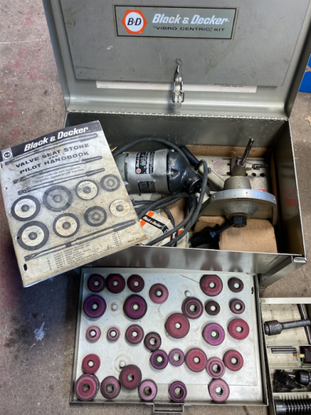

I had forgotten that I acquired this machine last year from a friend. Do I need three angles, or is 45 sufficient?

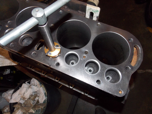

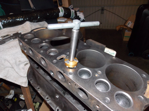

Your grinder will do the 3 angles. I see a diamond dresser unit in the box. 3 angles will give you a defined width which has a concentric (top and bottom) seating area. So if the valve turns it will still be seating on a clean seat. The width and location of the seat is important too. Cast iron grinds fast, so short bursts and check often. Dress the wheels often as well.

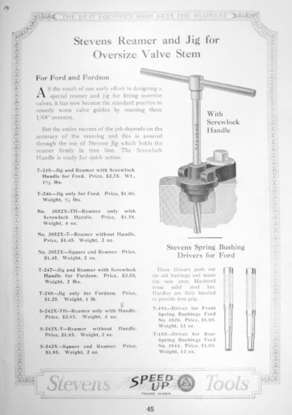

When reaming valve guides i use tooling that controls the location of the reamer at a point about 2 inches above deck height. This point is established by using the grinding arbor.
The arbor is replaced with a bushing matching the reamer diameter.. The leading end of the reamer has a pilot. Consequently, the two points provide the alignment.

My grinder only has 45 and 30 degree stones, so a two angle valve job it is.

Your set has a stone resurfacer. It can be set for 60 degrees. Seat shown looks good, but is way to wide for reasons already mentioned.
You are 90% to doing the job right.

Need to see what the contact on the valve looks like. You have plenty of stones that can be dressed to the desired angle. The current contact width is too wide .

Re: Valve seats
I use the Newark tools to make the seats right.
They are easy to use and make the job right.
Three angles : 45° for te seat; 15° for the top and 60° to finish the job.
Good luck

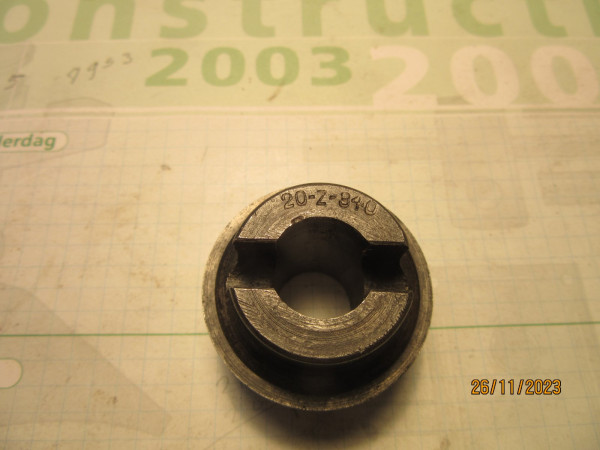

HI ; do one of you us this Ford Tool # 20-Z-340 .
Toon
Toon
- Posts: 210
- First Name: Steven
- Last Name: Park
- Location: Paris
Re: Valve seats
Rounded valve seat cutter! First one I have seen. Really neat.
