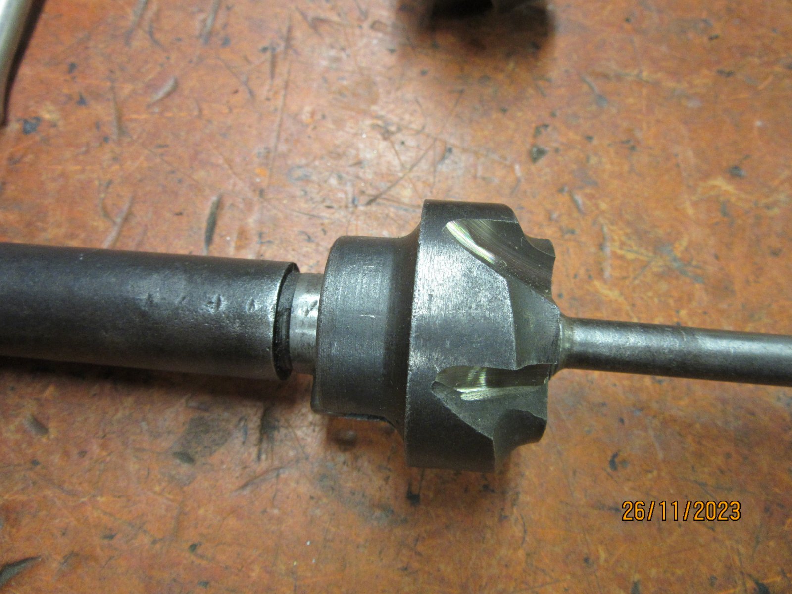

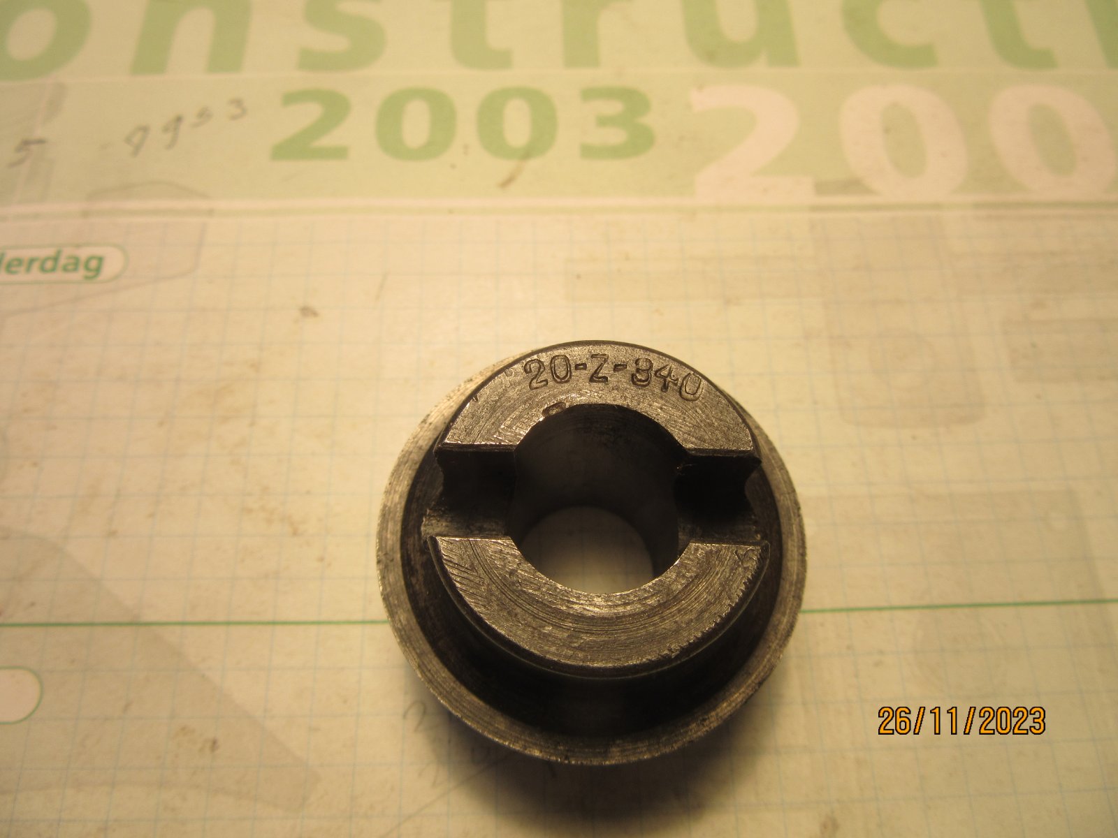

HI ; do one of you us this Ford Tool # 20-Z-340 .
Toon

Re: Valve seats
Post by Flivver » Thu Nov 30, 2023 6:22 pm
ABoer wrote:
Sun Nov 26, 2023 5:44 am
Rounded valve seat cutter! First one I have seen. Really neat.
