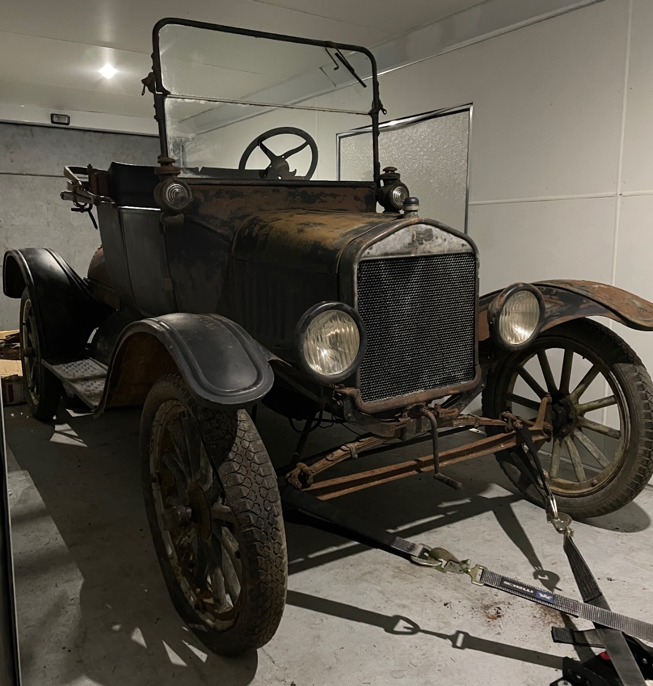

Hello,
I recently purchased a 1918 Model T Roadster and thought it would be beneficial to join this forum since I am not very familiar with the Model T. The vehicle I bought is complete and seems to be all there. It doesn’t run but I was told it last ran about 15 years ago. The engine appears to be a later engine since it has electric start but I am not sure how to tell what year it is. I wanted to check compression on engine but when I crank over the engine by hand it wants to move forward and I cannot seem to find neutral. I pulled the cover off the top of the transmission and everything appears to move as it should. Would this be the clutch plates sticking together or could it be something else? Also, if I do need engine work done, is there somebody in the PNW that is reliable? I am in SW WA.
Thank you for the help!

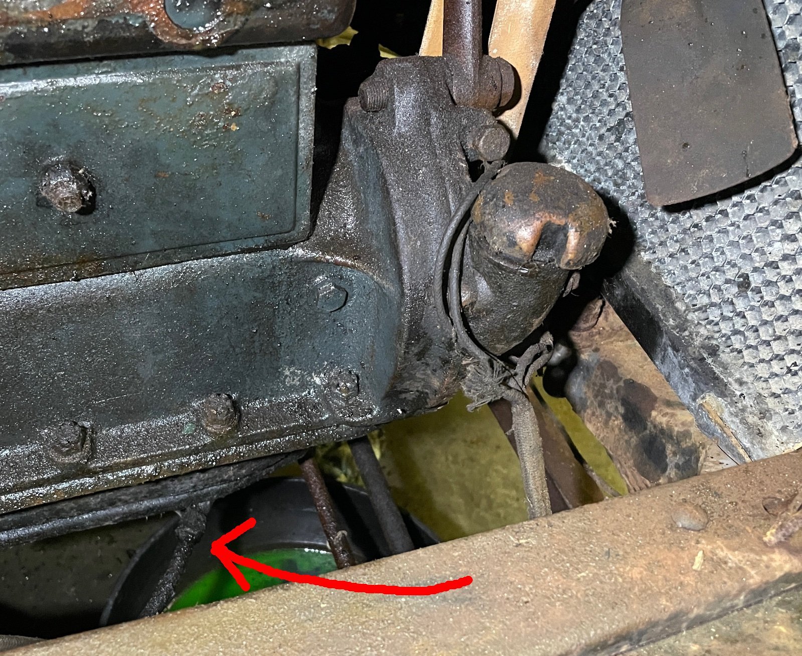

Did you have the hand brake pulled back ? Straight up should be what neutral there is as it's a wet clutch so not the same as a friction clutch. Did you remove the band access door or the transmission cover itself ?????
I'm up north near Tacoma/Gig Harbor - retired but can assist if need be AFTER I get the 2 other T's out of my shop !
A better place to grab the front end would be up near the frame/spring connection.

Yes, I tried the hand brake but still no neutral. I tried different pedal positions between high and low but still no neutral. I believe I just removed the band access panel. It’s the one with the 6 screws, correct?
Good to know on where to tie down the front ends of model Ts. . I wasn’t too sure so I chocked the wheels to keep it from moving back and forth during transport. Thanks!

Best to get someone near you who knows how to drive a T to help you start it and teach you to drive it. Otherwise you could get injured or injure someone else. The position of the left pedal is very important and if not adjusted correctly, you will either lose traction when in gear, or have no neutral. And the brake pedal must be adjusted correctly or your brake will either drag or no brakes. So have someone explain it to you and drive it around, then try driving yourself. Also the T will not stop as quickly as a modern car so you need to be careful about following distances etc. And also going downhill, it is harder to stop.

It would really help if you get the Ford service manual for Model T’s. It’s good to know what NOT TO DO when learning about a T. Good advice here on the forum too!
As in the last post Model T’s don’t have real brakes! It’s best to learn to drive them on a big parking lot or on a country road. Hopefully there is some one in your area or a club that can you acquainted driving it. It’s definitely not like your modern vehicle and it’s best to expect it not to be.

Thanks for all the replies. Although I’m new to Model Ts, I am not new to vintage automobiles and motorcycles. I’ve driven a Model T a few times so I am familiar with starting and driving one. I am just not familiar with the drivetrain or what would cause there to be no neutral. I did order a Model T service manual but have not receive it yet. I did a lot of searching for an answer to my question before I joined and posted here. Maybe someone here will have the answer or maybe I can figure it out after I get the manual. I am not trying to start the car right now. I just want to be able to crank it over and check compression before I pull the head off. Seems like that’s the best place to start. Thank you TRDxB2 for all the links. I will dig thru those. Whether my T is actually a 1918 or if it is only a year on the title is yet to be determined. It’s not really all that important to me at this time but I will eventually figure out exactly what I have. Right now I just would like to take the proper steps to get it running and driving. Just need to determine what will need to be done to achieve this.

Lift 1 rear wheel. Put the parking brake lever forward. Do your compression tests.
You will have taken the dragging clutch out of the equation.

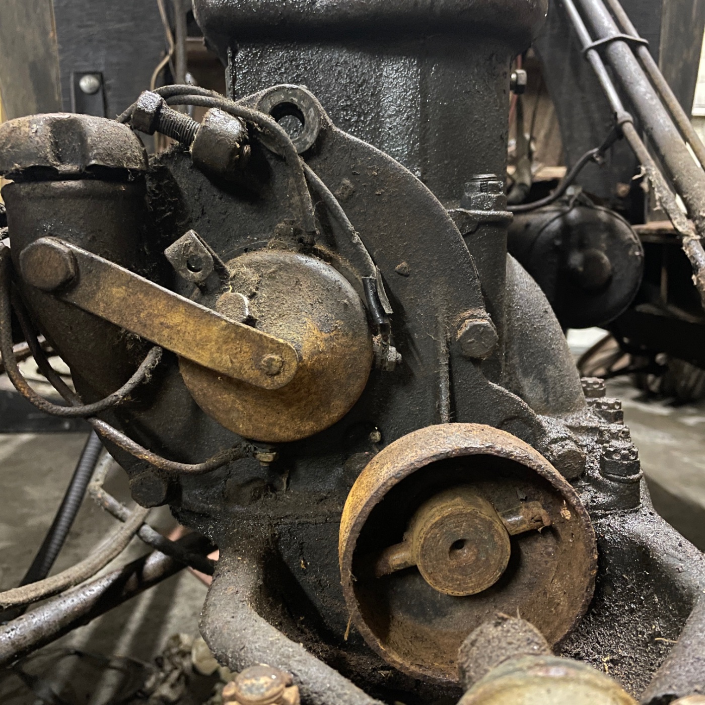

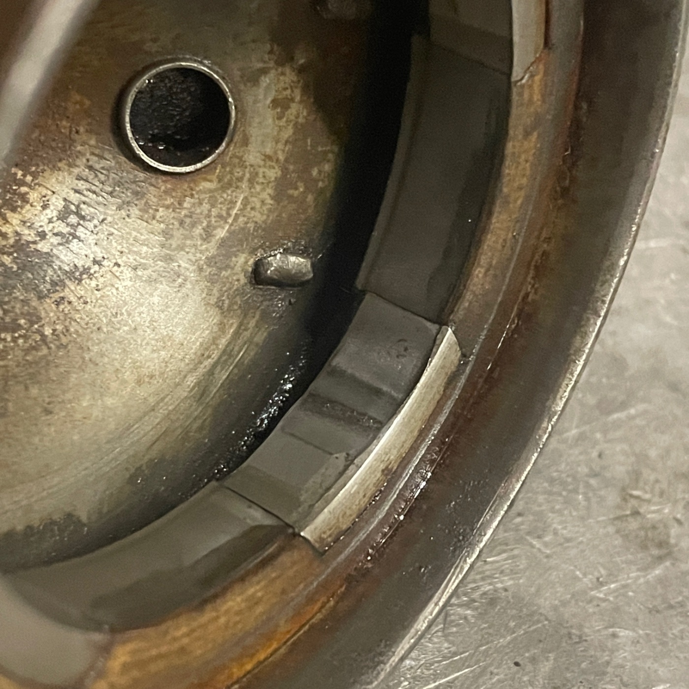

When I got my T a few months ago I was told the clutch was stuck. I looked through the forum at what to do and decided the easiest thing was to put the rear end of the car on jack stands so I could get the engine sorted out first. I ran the engine many times with the wheels spinning and magically that somehow broke it loose. Probably caused by oil splashing, vibration, and just some load. Also, I did mix a full quart of transmission fluid into the oil when I filled it up the first time.
Good luck! One way or another it will eventually brake loose

My 23 touring was stored for 23 years. During this time, The clutch plates were stuck when i got it out of storage. My friend rocked the car back and forth. Eventually the clutch became free. We cleaned the coil points, spark plugs, carberature, aired the tires then started the engine. I foolishly used a 12 volt battery to jump start the engine. The mag worked well, so I took it for a short ride.
You are much further ahead than I was at that point. After you get it running I am sure you will enjoy it.

JR, I would jack up the rear, chock the front wheels securely, and try to start it. Then, if you can't get it to start, it's time to diagnose, and make repairs. Don't fix it, if it ain't broke. Dave in Bellingham

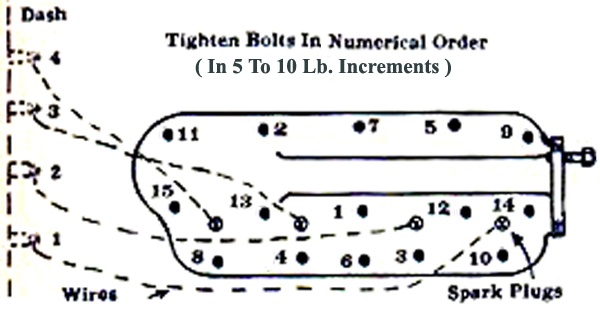

Here are a couple of informative articles that will give you the basics your Model T. The first article is about the development of the T and the second article is on how to drive the Model T and some things to beware of. Jim Patrick

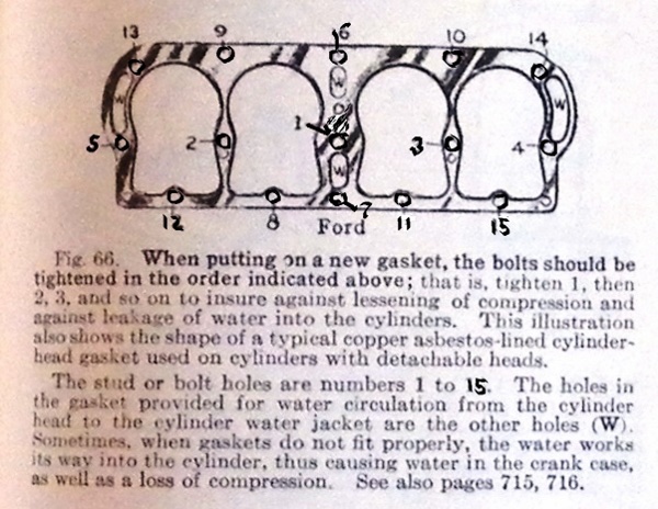

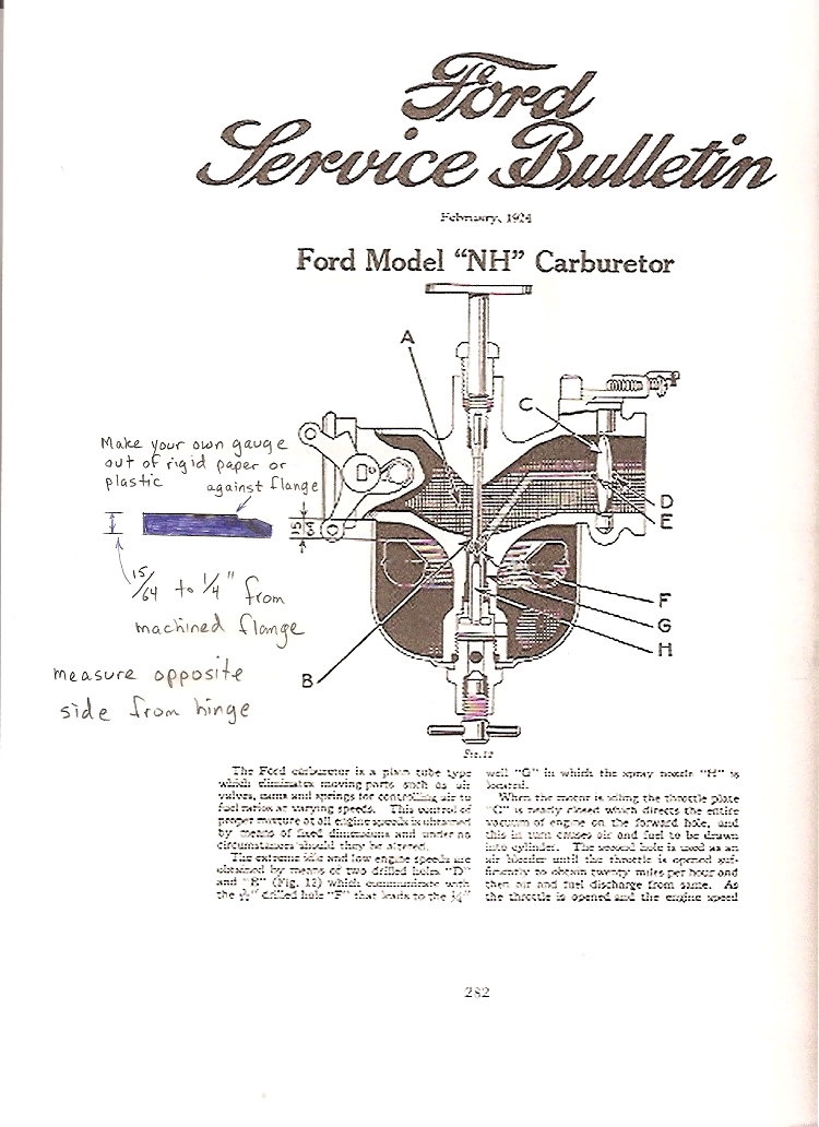

I am wanting to check condition of motor and refresh at least the top end if it needs it. I’m not worried about removing the head bolts. I’ve taken apart at least half a dozen flatheads and removed head studs on the early V8s. This little 4 banger with a fraction of the bolts doesn’t scare me. I’m not going to just top off the gas tank, throw a new battery in it and take it for a spin. As good as my life insurance is, I’d rather take the time to ensure things are mechanically sound before I hit the road. This T has been sitting a long time, and I don’t know much about its history before it was parked. Besides, I would rather fix something before it breaks rather than after.
- Posts: 6587
Re: New T owner looking for some advice
Hope this helps

Getting it running with fresh oil will eventually wash out the sticky stuff in the clutch pack.

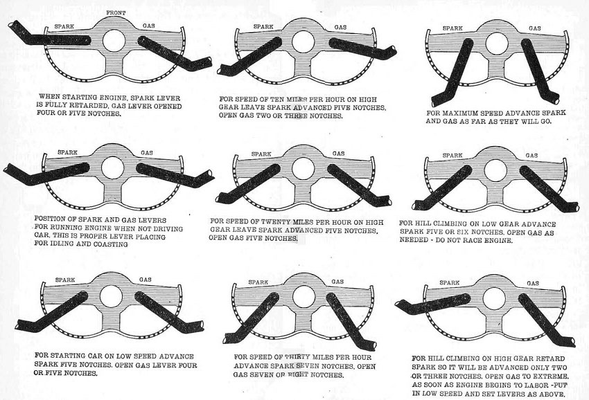

A few helpful diagrams:

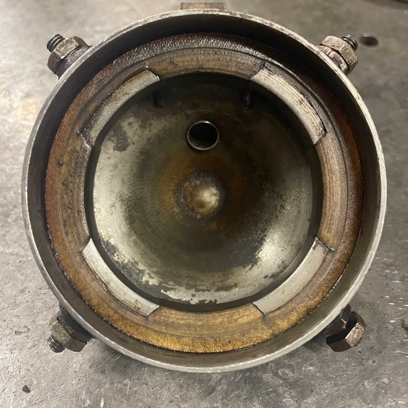

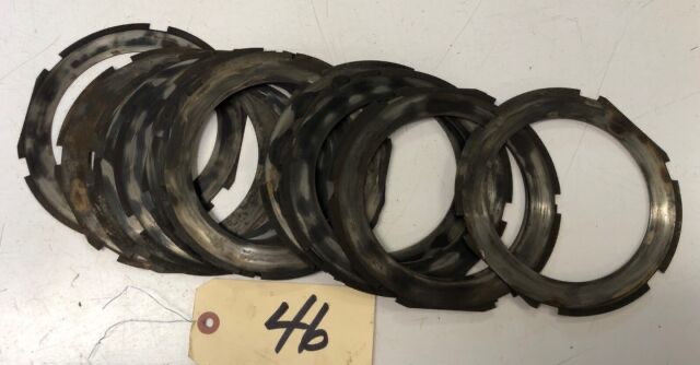

A couple things can cause the clutch disks to stick. One is thick oil between the disks which can enter when it is parked with the brake lever in park or neutral. As the oil gets thick in colder weather it will cause the disks to stick. Best when you park for long periods to leave the lever forward into high position which will force the oil out when it is hot and will not coo off between the disks. This is especially true in the old non detergent oil with single weight is used, which was the norm many years ago.
The other thing which will cause to stick is worn grooves in the brake drum in which the disks are located. Those grooves will cause disks to stick and a combination of cold oil and grooves can make them very hard to dislodge. If you can jack up the rear wheels and try to start with the parking lever forward. after you get it running and warmed up a while, then , with engine idling, try pulling back the parking lever. If it stops the engine, the disks are still stuck, but if it stops the rear wheels and the engine still runs, your disks are unstuck.

Your last picture upload shows a cylinder head bolt tightening sequence which isn't the best for a Model T.
This one is much better, and meets the Ford Service Manual instructions. The center bolts of the head must be torqued first, where the cylinders are spaced narrow, the smallest part of the gasket, then work out random in a sequence. Best to always tighten from the center row of bolts.

When the lever is pulled all the way back, you will notice that the clutch pedal goes down a little toward the floor. This is the lever automatically putting the C pedal in neutral (halfway down between low gear (all the way down) and high gear (all the way up), while also engaging the rear drum brakes. This holds the car in place while you start it. If you push the lever forward a little, it keeps the car in neutral, while releasing the rear drum brakes, allowing you to manually push the car. All the way forward, and the clutch pedal goes into high gear. If the car is running, you must press the C pedal halfway down, putting her in neutral, before pushing the lever forward. Now she is ready to drive. Push the C pedal all the way down to move forward, let up on the C pedal to put in neutral before engaging the R or B pedals and while engaging these pedals, your foot must remain on the C pedal to keep it in neutral while going in reverse or braking.
It is essential that the lever is adjusted so that you have a strong neutral when the lever is pulled all the way back or the car will creep forward when running. This, you do not want! Many a past T owner has been pinned against he back wall of the garage because of this and many a T has crumpled front fenders, also due to this. Jim Patrick

There are multiple clutch plates that should freely move by eachother. If the lever has been set for a long time, compressing these plates against eachother, the oil between these plates may have coagulated, causing them to stick together, resulting in no neutral. You may be able to dislodge them with Gunk Motor flush. It will also clean the rest of the inside of the engine of old sticky oil. Jim Patrick

The hand lever doesn’t seem to be adjusted properly. The wheel brakes engage before it can engage the clutch. I have printed off the instructions on how to adjust this. Also, I bet the clutch plates are just stuck together since the car has been sitting such a long time.
- Posts: 5597
Joshua - was the car parked with the hand brake pulled back ? That surely could congeal the clutch plates together.

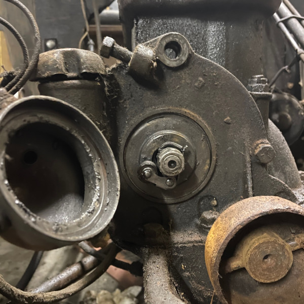

Here’s another question… my car is a 1918 but at some point someone added a later transmission with electric start and a battery, but no generator. Should a generator have been added? Should I add one?
- Posts: 5263
If your block is 18, you dont have a mount for it. If a later block, then, yes.
Show a picture of the right front side of the block. Behind the timer.

I will take a picture when I get to the shop later but I don’t recall seeing any provisions for a generator. Should I consider adding one or will things work fine as is? Is it capable of providing a charge to the battery or will I just have to trickle charge it when not in use? Forgive my ignorance, I’m still learning about the electrical system on pre-electric start Fords.
- Posts: 5263

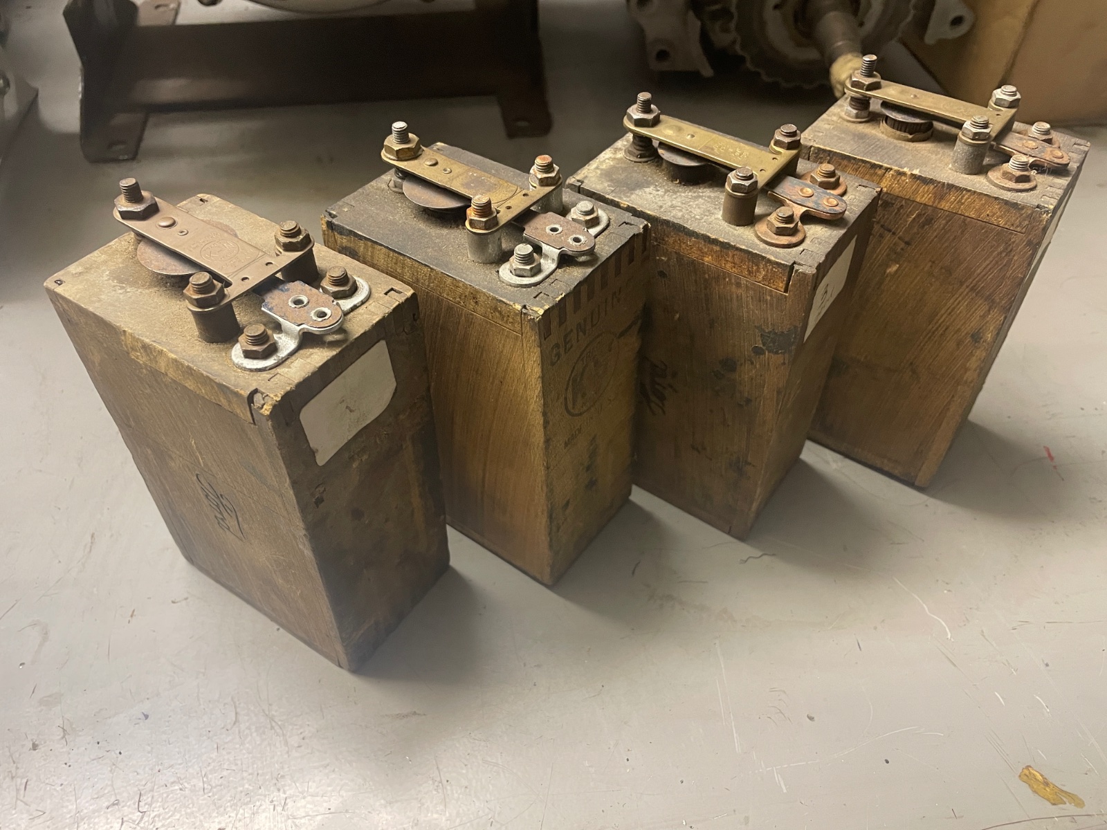

You can use a rectifier to charge your battery from a working magneto. I have built 2. They produce about 3 amps @ 12V.
You can run total loss. Limit electric starts. A T will run several days or more on a full size charged battery.

Yep, no generator mount. I may have to look into the rectifier but the total loss doesn’t sound like an issue to me.

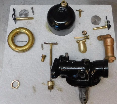

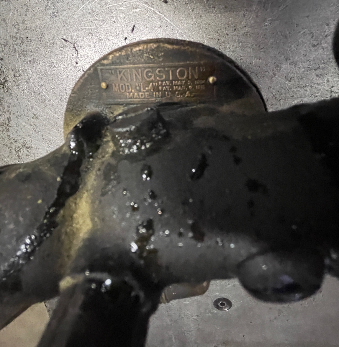

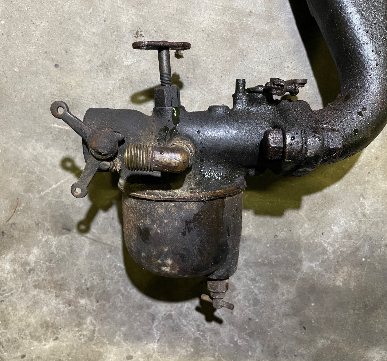

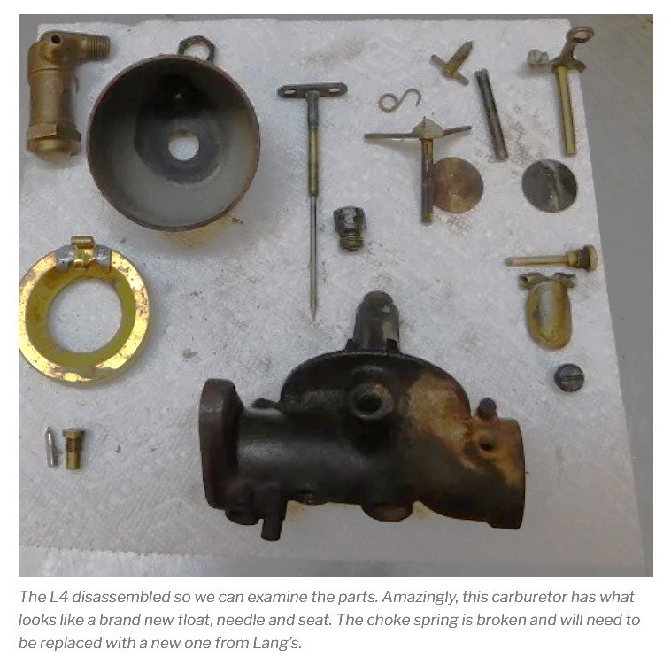

Here’s my carb. It’s a bronze Kingston L4. I’ve been reading that these can be a good carb choice as is the Holley. Just like everything else with this T, I am unsure of its condition and I don’t know anything about these carburetors. I am sure they are somewhat simple but am also wondering if there are little tricks to rebuilding them, adjusting them and getting them to operate well. Makes me wonder if I should send it to someone who specializes in these carbs. Thoughts? If I do decide to send it out, who do you all recommend?
Thanks!!!
Thanks!!!
- Posts: 6587
Posted on January 31, 2019 by Royce Peterson
Kingston introduced the final variant of it’s L series carburetor for the Model T Ford at the beginning of the 1922 model year. It was the iconic Kingston L4, used on millions of Model T’s and TT trucks from 1922 – 1927. A good performing carburetor, it provided years of trouble free motoring and simple design that could be repaired easily. Let’s take a look at how to restore one.
Repairing a Kingston L4 Carburetor for your Model T Ford
https://modeltfordfix.com/repairing-a-k ... el-t-ford/

Thanks. I did come across that article when searching for answers. Very helpful. I will have to open up my carb tomorrow and see if the float is brass and if it’s usable.

- Posts: 4694
I have not seen a bronze Kingston L4. The one I have looks like the one in the pictures posted by Frank. Mine is cast iron. A weak point on the Kingston and on the NH is the fitting where the fuel line enters. Be careful to use something like Teflon tape or a fuel proof sealer when you install and very carefully tighten just enough to keep it from leaking. Over tightening can crack the carburetor body making it useless.
- Posts: 5597
Norm - one should not use Teflon tape with gasoline.
- Posts: 4689
There is a yellow Teflon tape made for gas fittings. It’s supposed to work.
- Posts: 5263
No one should use Teflon tape.
I have had many people crack the inlet casting on carb bodies using Teflon tape.
Use permatex.
Use permatex.
- Posts: 5597
The yellow tape is for "natural gas" - not liquid as I understand it !

Nice car! Lesser men might be overwhelmed with all these excellent responses but you take it in stride and have done 1/2 the research already!
Only thing I could possibly add is about the ?oil line? in your pic if that's what it is. (My red arrow.) Accessory oiler on the mag post perhaps.
When I got my '18 with a later engine there was an accessory oil line installed in about the same position BUT where it was screwed into was a blind hole.
I moved it.
The internal oil line was also plugged so the engine suffered a bit.
That's for another day. If you put oil in from the front, you'll fill the troughs to get you going.

Thanks! Yeah, it’s been interesting, but fun. I wish I had more time to work on it. Just been learning a lot. I believe that oil line runs to the Ford Faithful oiler. I haven’t learned much about that but it’s pretty obvious what it does. I have a feeling someone will educate me on it. Thanks for your comments.
- Posts: 4689
Hello again
Your T was upgraded back in the day! This is what people would do to upgrade here and there to improve their car. More than a few bought accessories that got to be abundant for a Model T. Your car probably has the original engine it since it was a non-starter and generator car to begin with. Have fun!

The serial number on the engine is within the 1918 range.

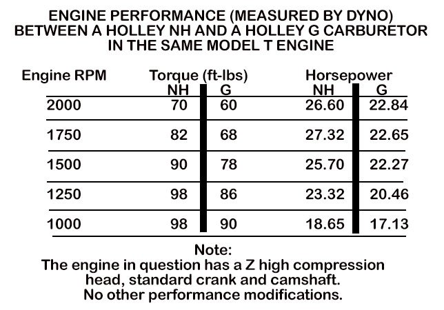

A friend of mine had a Kingston L4 - we replaced some parts and followed the instructions but dang if we could never get it to run right. He missed half of his first multi-day tour with carb problems. His solution was to buy a Holley NH from Russ Potter. Worked great out of the box and cured his troubles!
My car came with a Holley G - I also had it rebuilt by Russ Potter. Afterwards it started and ran great. Later I had reason to have my transmission repaired by the same folks who had previously rebuilt the engine and tranny. Before sending it out of the shop they put it on a dyno and run it for you. Just for fun they ran it with my G and a stock NH. Look at the chart below and you'll be surprised by the difference. Result, I bought a rebuilt NH from Russ Potter and then replaced the float valve with one of Scott Conger's excellent "full-flow" valves. Now I have a great running, reliable carb.
Also - good warning about not over-tightening the full inlet elbow. I've been told to NEVER use teflon tape on any aircraft connections, fuel or otherwise, so I don't use it on my vehicles. I use Permatex 56521 designed for the purpose.
To keep my wife happy I do whatever I can not to be "FORD" (found off road, dead) on a tour. So far, so good.

Another area I am learning about is the timer. I am not sure if this current one worked as is or anything about it for that matter. I’ve seen a few different brands of timers for sale online and wondering if I should run what I got or if I should replace it or upgrade to something else. I appreciate all input. Also, if I’m asking for too much info, just tell me to get lost. Thanks all!
- Posts: 4476
The timer doesn't look too terrible. Clean it up nicely and show us what's under all the gunk.
Last edited by Jerry VanOoteghem on Fri Dec 01, 2023 5:06 pm, edited 1 time in total.
- Posts: 4694
That kind works well if you keep it clean, the contacts are clean and it is centered. There is a tool sold by the vendors which fits where the cap runs in the timing cover which must be centered with the camshaft. Use a non conductive oil without any graphite or moly in it. Regular engine oil should work. The new day timer has a brush which runs on the front of the cover and also is very good. Hardly ever needs to be cleaned and it does not need oil. The Anderson timer has a flaper for the brush and runs on contacts inside the cover. Each type needs the correct brush with cap made for that type timer.
Mark Nunn
- Posts: 1289
- Last Name: Nunn
- Location: Bennington, NE
The phenolic material inside the timer appears to be maroon in color. That would indicate a Tiger Timer, which is a good roller type. I have one that has nice and smooth roller surface and it works very well. Having smooth transitions between the metal contacts and maroon material is important to keep the roller from bouncing. I would clean and use it unless the roller contact surface is rough.

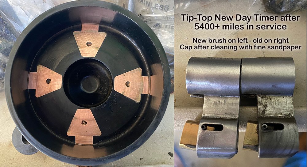

I have put many thousands of miles on a reproduction New Day timer from Tip Top Timers of Spokane Valley, WA. Mark Hutchinson <hutchmc@comcast.net>. He's associated with Spokane's Antique Auto Ranch.
Tip Top makes Anderson and New Day Timers that are excellent quality in my opinion. The New Day is simple, does not require lubrication, just clean the dust out and brighten the contacts with some very fine sandpaper now and then. Also, it looks like your camshaft seal (behind the timer) is the old felt type. Get a modern neoprene seal from one of the vendors and throw the brass disc away that rides between the felt seal and the brush. Put a very thin run of UltraBlack sealer around the metal outer edge of the neoprene seal. Buy or borrow a centering tool and check that the timing cover is indeed centered on the camshaft. They have a little wiggle room and can be off center, causing some timers to run poorly. The New Day is probably the most forgiving of misalignment.

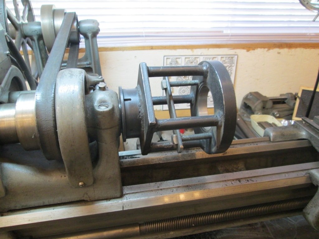

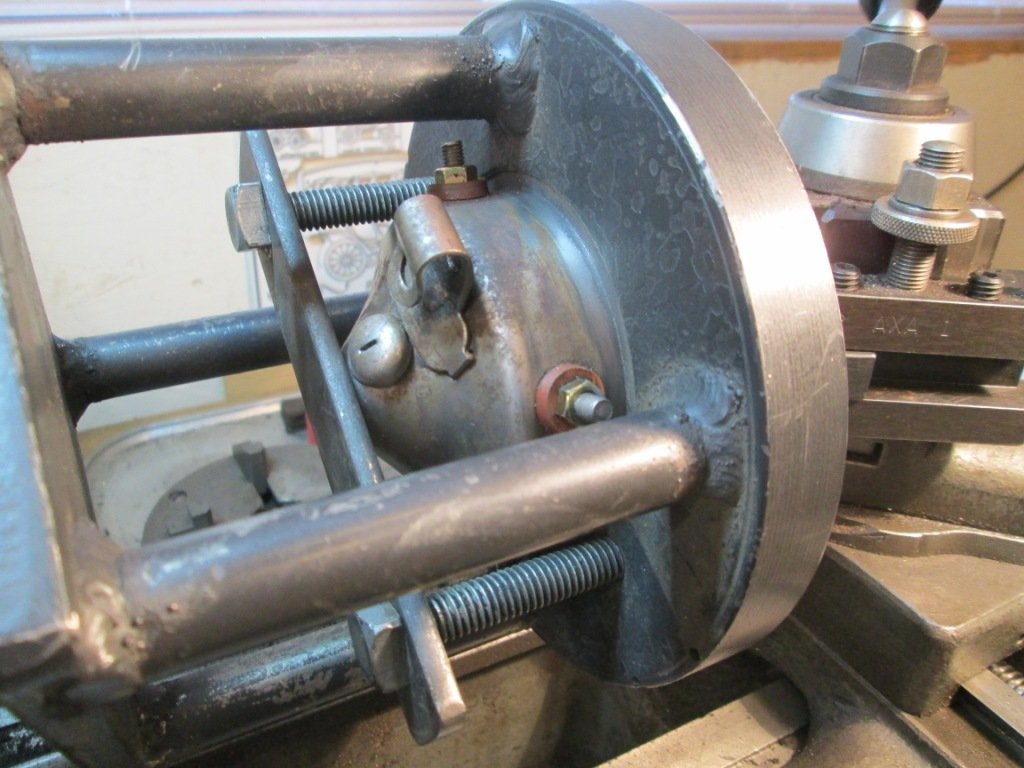

I did come across and article showing a timer being resurfaced in a lathe. I thought about it but would probably spend more time on a fixture than it's worth, since I don't plan to turn many timers.
I didn't realize there was two types of centering tools, a large and small. Which one is the large one? I will probably just buy one versus machining one, we'll see...

Hey Steve!
I really like your timer fixture setup for your lathe!
- Posts: 5597
I can't take the credit for it's construction - my good friend (now deceased) master machinist Otis Clinton made it many years ago !

I had a little time today to work on this project so I decided to test the coils. I initially thought about sending them in for a rebuild but was curious if they were any good. All but one buzzed and created a good spark at the spark plug. The one that did not work had dirty contacts. I cleaned the contacts and it worked just like the others. I’ll have to clean the contacts on the other three just to be thorough, and I should see what the procedure is to set these contacts. I think I’ll hold off on sending these coils in for now. Maybe this week, if parts show up, I can see if it’ll run.

For long life & low maintenance, have the caps replaced with new ones. Then have them set with an ECCT.
One of the coil rebuilders will do a great job. Well worth the money to have a pro change the caps.

I’m sure you’re right. I’ll plan to send them in.speedytinc wrote: ↑Sun Dec 03, 2023 4:04 pmFor long life & low maintenance, have the caps replaced with new ones. Then have them set with an ECCT.
