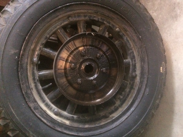

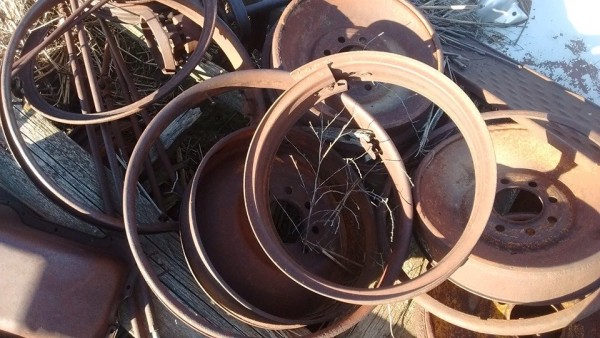

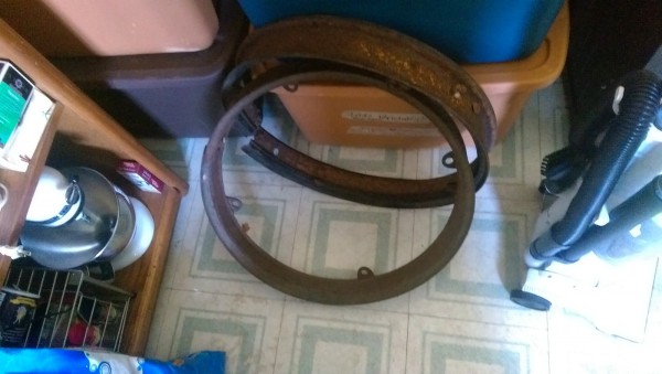

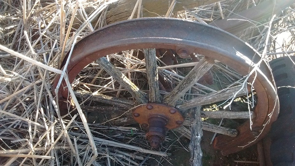

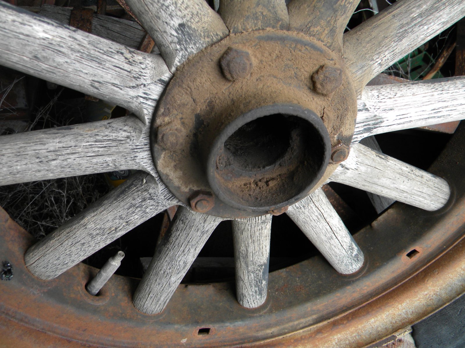

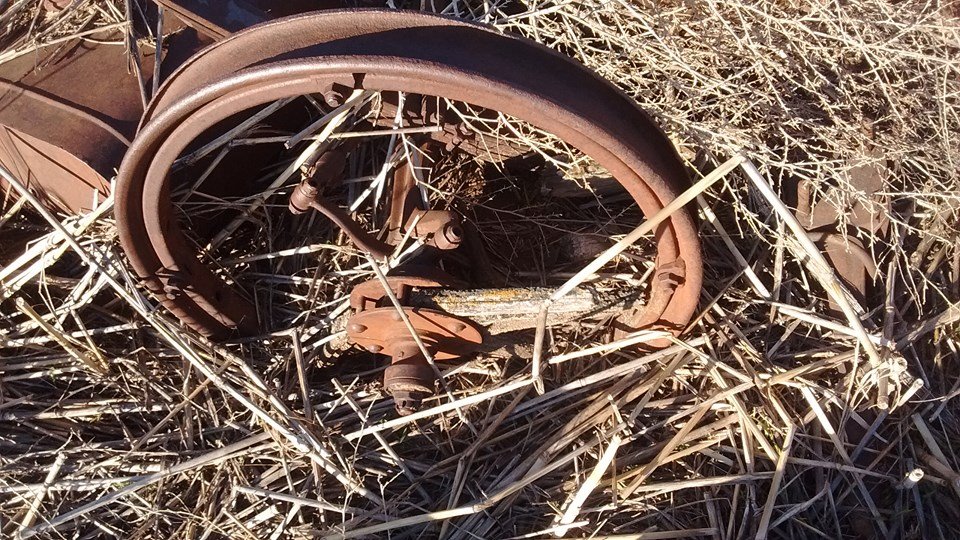

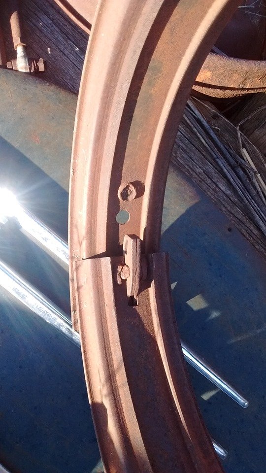

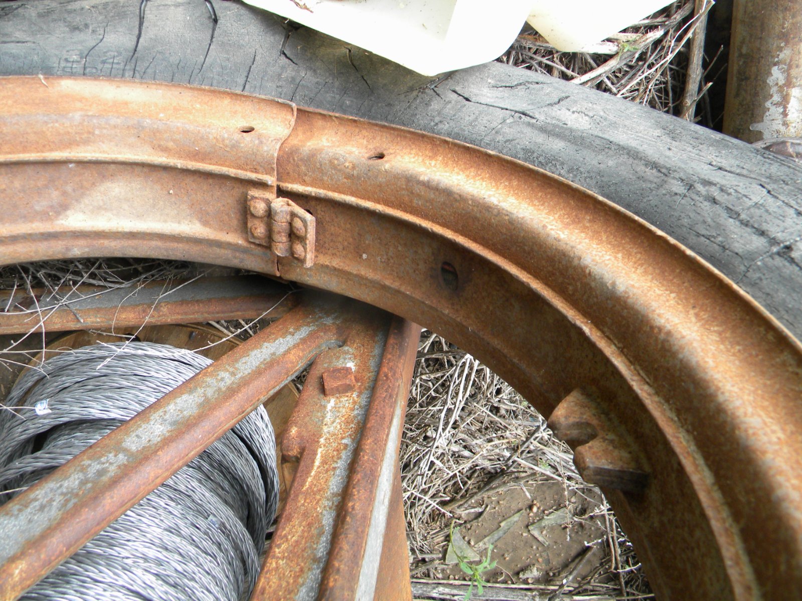

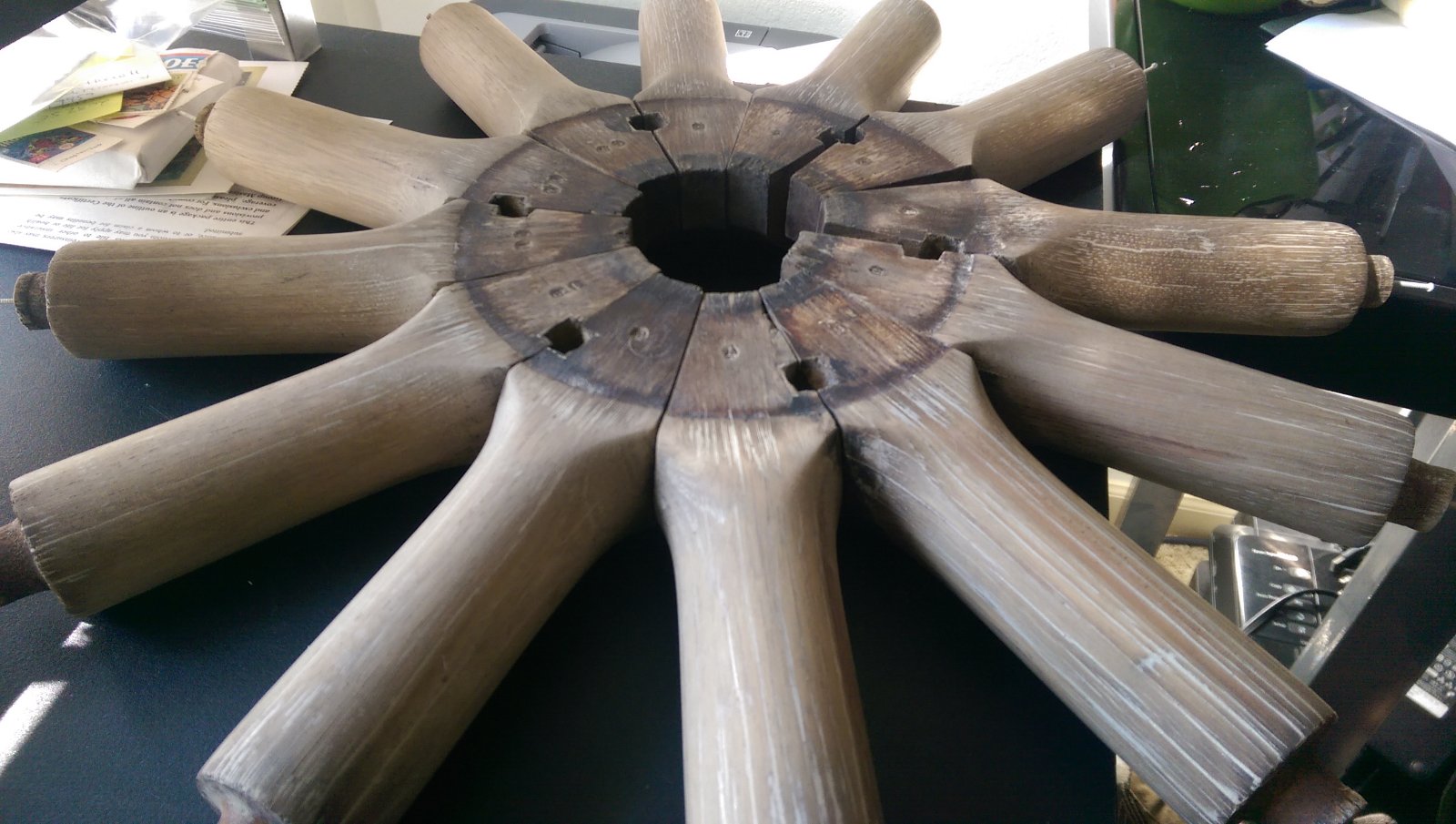

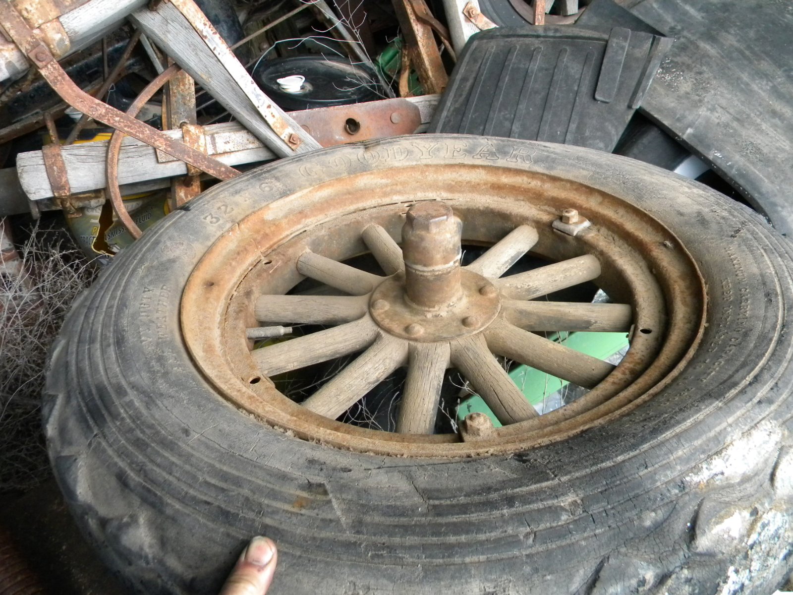

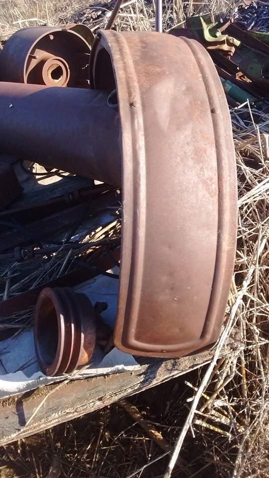

Hi, first post. I am a farmer who is wanting to do threshing shows and that got me into Model T trucks to dump the grain into. I have picked up parts here and there but rear rims and wheels have kind of eluded me. I found a set of rims and tires (junk tires) listed at an auction that were the right size so I went and bought them. The people selling them thought they were really Chevy but the rims look about right. One still had a decent spoked wheel that I have posted pics of that had a plain hub cap. I don't think the wheel itself is Ford but can I use a Chevy rim on a Ford wheel? I don't yet have the TT rear wheels, just a bare axle with brakes so I don't have anything to compare. The clincher type looks kind of the same? Sorry for the stupid question but I am just starting out. Its been a lot of fun so far and if this truck turns out I could see a car in my future. Thanks for any help you can give me.

Not going to comment on the wheel photos but the first/top photo is of a Canadian rim - they use a "special" rim tool inserted into the small holes on the outer rim area and that's a removable pin holding the joint together, which apparently, the latch has become un-riveted !

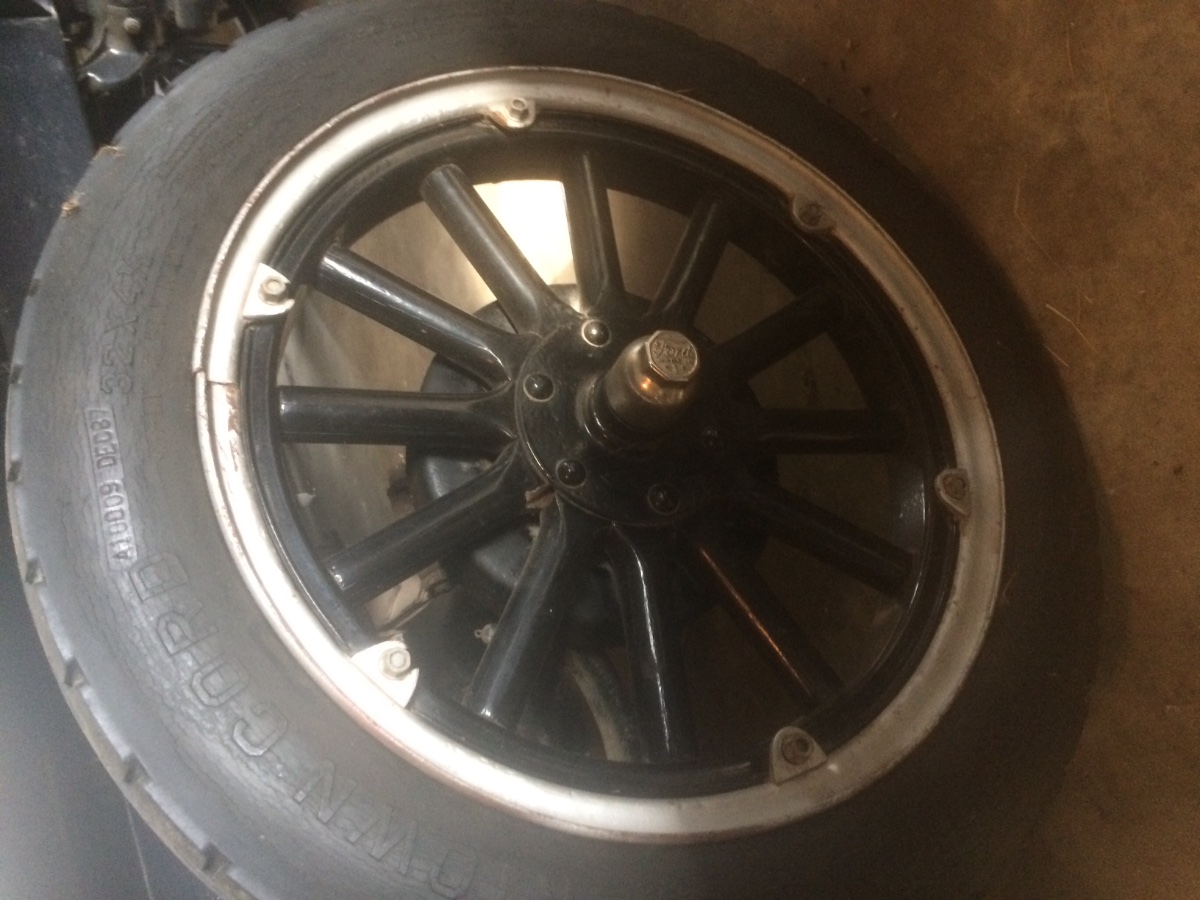

I don’t think that’ll work farmer Aaron. The inside pic of that hub appears to be for a front wheel. Don’t see any way a brake drum can be fastened. The taper for the ends of your TT axles probably won’t match that hub either.

That is a good question about the year, was the original engine the only way to tell? I got a replacement out of a car, the original frame is TT with the worm gear rear end. I suppose I could tell some by the height of the radiator and firewall? I have not got a hood yet, or a good one, cattle tromped this one. I do not have the fenders or brackets so unless I can tell from the frame I don't know? Like I said, I am very new to this.
I didn't know they put front tires that big on back then but I see what you mean about the brake drums, Thanks. Kind of confused about the Canadian rims, these had been in the family of the people who sold them for as long as the 65 or so year old man could remember?

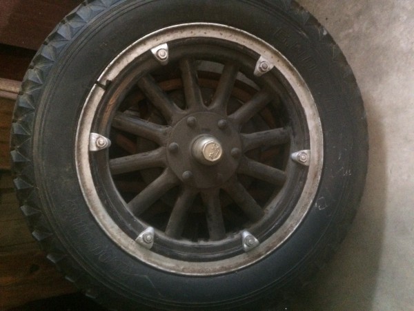

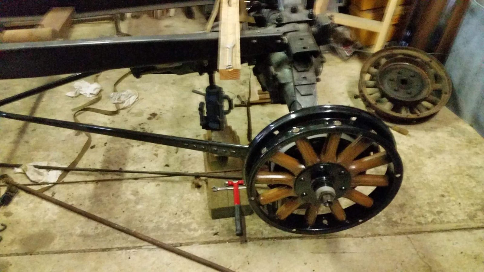

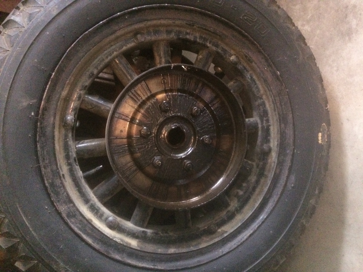

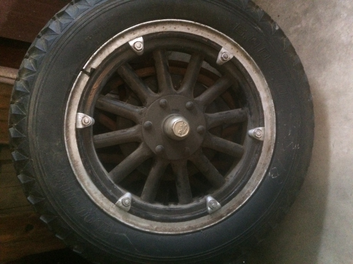

The interior and exterior view of a FOR SALE TT 6.00-20 wheel, rim and new tire and the mounted wheel picture is of a TT 32-4.5 wheel, rim and tire. Both will have the emergency brake drum. I also have some good TT emergency brake shoes for sale. I hope this helps

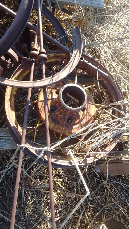

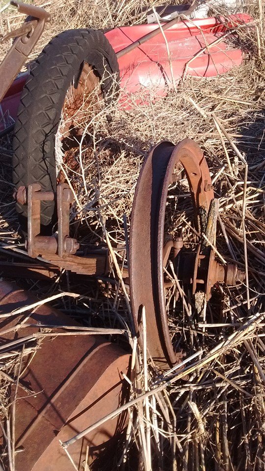

Thanks for all the comments and photos, those wheel photos were great! So you know, I am in SW Kansas, basically half way between Dodge and LIberal in No man's land, not many Ts out here, a few As but the clubs are not active like they used to be. I am trying to plant milo so I may not check this for a while but I did get over in a "goodies" pile and found some items, some T parts and some Maxwell and some I don't know what. I don't think the rims I took pics of are Ford, maybe they go on those disc Maxwell wheels? I think the wood wheels are Ts, there is a pretty good pile of wire spoked wheels, I assumed they were Model A as there was a couple firewalls and frames that I know were but there was a set of wires with a smaller hub that I took a picture of, I am sure its not T but I thought I would post it. I am almost positive this fender is a T and later I found what I think is the mate, I don't know what year they would be but they are repairable. Thanks again everyone. I really appreciate your help, I farm and have another job so it is hard for me to go anyplace and look so the net is my best source. I ordered a Ford body parts book, a reprint, what other books are good for learning how to ID different years? Thanks

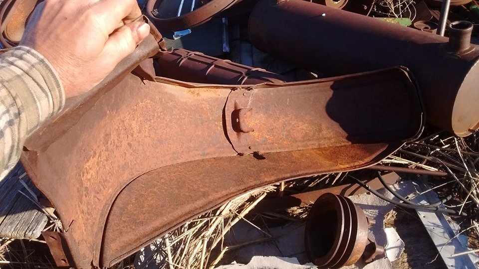

Here is the fenders and small center wire wheels, Thanks

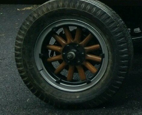

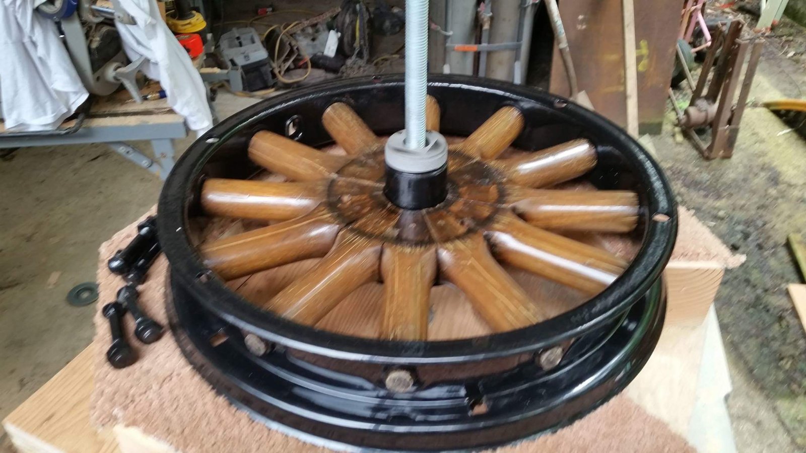

Here are what mine on a 25 TT look like before and after refinishing
1925TT
Posts: 48
Joined: Wed May 15, 2019 10:45 pm
First Name: Forest
Last Name: Ledbetter
* REQUIRED* Type and Year of Model Ts owned: 1925 TT Holmes tow truck
Location: Oregon
Board Member Since: 2014
Re: Model TT rear wheels and rims
Post by 1925TT » Fri May 31, 2019 12:02 am
Should have clarified, mine are 20's with 700 20 tires

That is a Model A wire wheel. I have a friend in Salinas(sp) that might be able to help you out. Is that relatively close to you?

Looks like a great project Forest, thanks for the pics. D Hart, Its about 225 miles so yea, pretty close. If that is an A the bigger diameter centers must have been V8 Fords, there was a pile of them. I am going to be in the field for a while but will get back to this later, can anyone think of any books I can buy that would help someone starting out? Thanks
