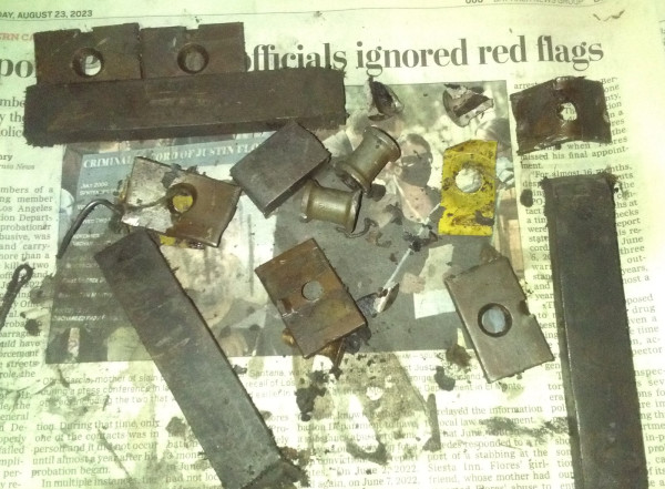

Dan McEachern
- Posts: 1510
- First Name: DAN
- Last Name: MCEACHERN
- Location: ALAMEDA,CA,USA
Re: Brass ring gear screws, change them or leave then alone?
"A picture is worth a 1000 words........."

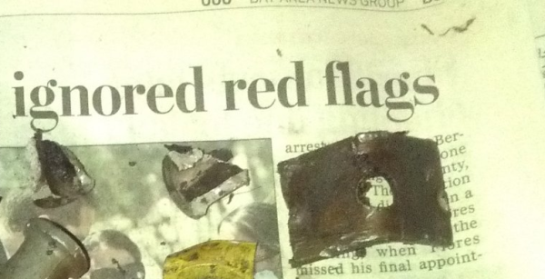

Chosen News Paper on Purpose?
Dan McEachern
- Posts: 1510
- First Name: DAN
Actually no, but when I went to snap the picture I just could not resist leaving the newspaper headline there! That was just the chunk of newspaper we grabbed when we took the shrapnel out of the pan. Perhaps there IS a higher power out there somewhere eh?
