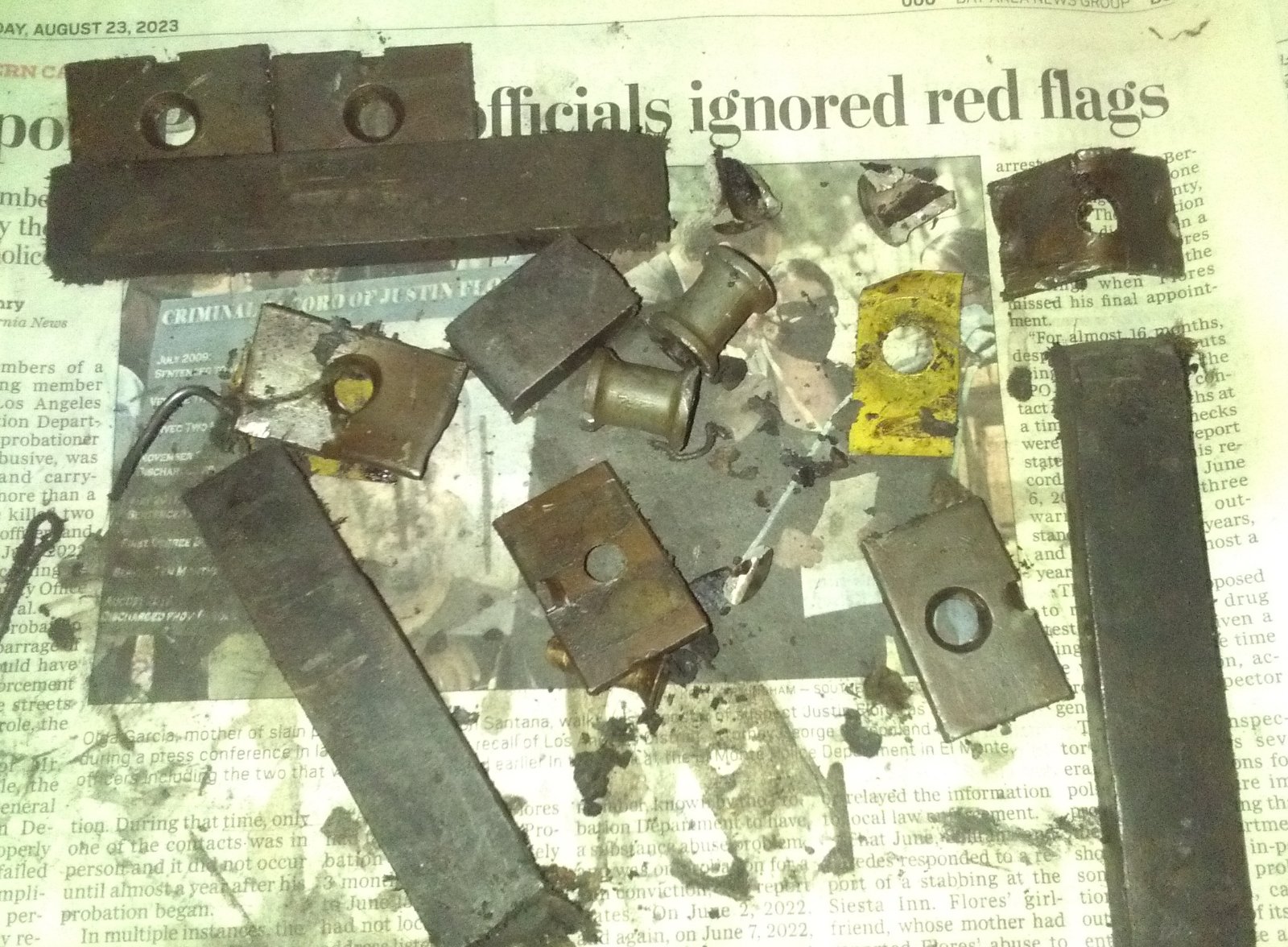

"A picture is worth a 1000 words........."

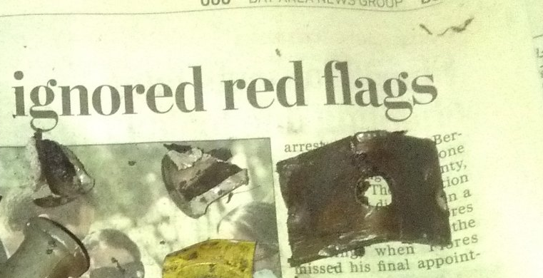

Chosen News Paper on Purpose?
Dan McEachern
Posts: 1446
First Name: DAN
Last Name: MCEACHERN
Location: ALAMEDA,CA,USA
Re: Brass ring gear screws, change them or leave then alone?
Post by Dan McEachern » Tue Feb 20, 2024 8:03 pm
Actually no, but when I went to snap the picture I just could not resist leaving the newspaper headline there! That was just the chunk of newspaper we grabbed when we took the shrapnel out of the pan. Perhaps there IS a higher power out there somewhere eh?
