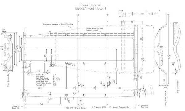

The issue with mounting is hole alignment to existing holes. Since you have matching splash aprons, fender supports to front fenders that should not cause issues. Also the Headlight arms work with the supports.
I don't think you need rear fenders for a WW1 Ambulance

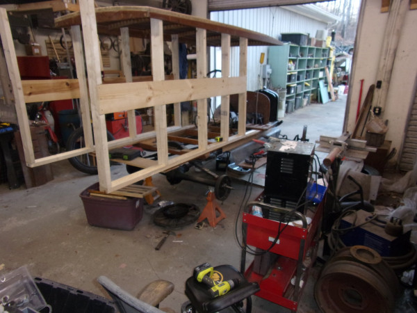

Hmmm...food for thought. Part of my design "dilema" is the Ford Model T 1915 ambulance DID use rear fenders and I have a set. And, yes, I do have the 17/23 splsh aprons as well. So, if I used metal fenders to lean towards the 1915 version, they would bolt to the correct running boards and the splash shields and I could bolt them direct to the wooden ambulance body and not deal with fender irons on the rear.
I do not have correct headlights or mounting uprights.
Hmm....
Anyways, a good day on the table saw.
