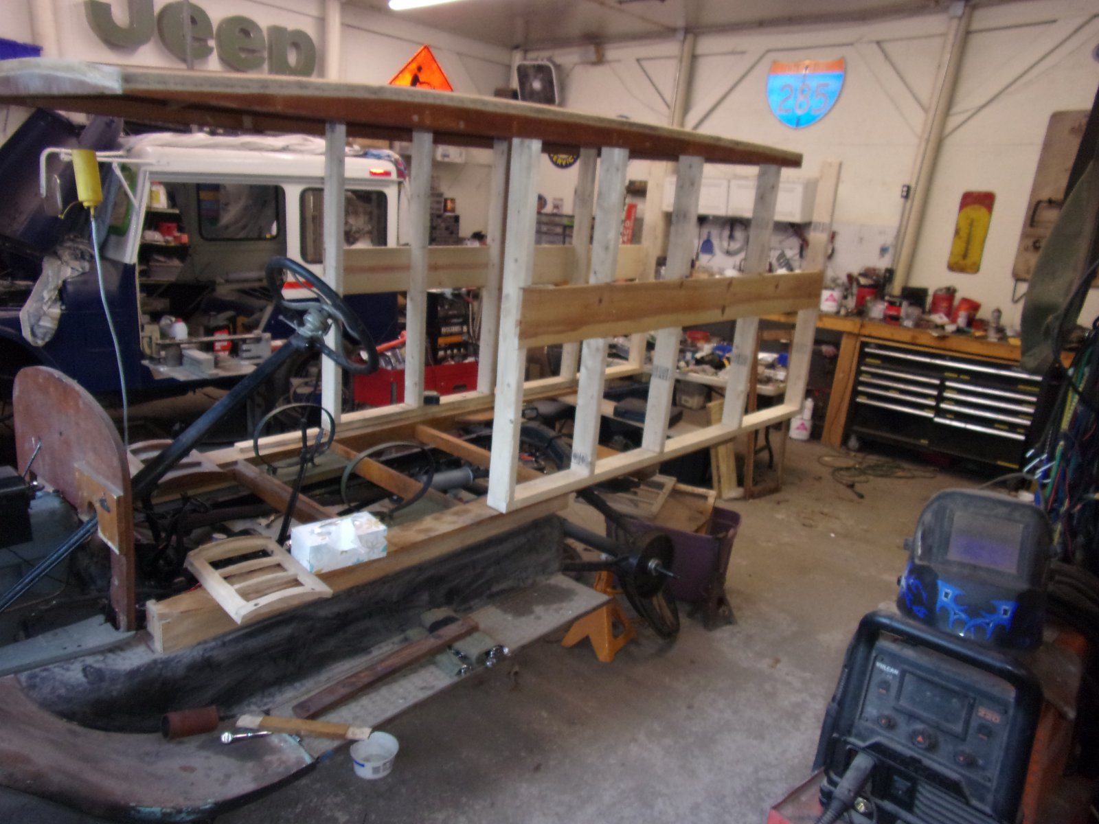

Hmmm...food for thought. Part of my design "dilema" is the Ford Model T 1915 ambulance DID use rear fenders and I have a set. And, yes, I do have the 17/23 splsh aprons as well. So, if I used metal fenders to lean towards the 1915 version, they would bolt to the correct running boards and the splash shields and I could bolt them direct to the wooden ambulance body and not deal with fender irons on the rear.
I do not have correct headlights or mounting uprights.
Hmm....
Anyways, a good day on the table saw.
Hmm....

Re: 17/23 sheet metal on 27 frame?
Good point. My last War Wagon WWI Model T light patrol vehicle was all OD Green, but I wasn't going to paint over that brass radiator. So, good point. I'll sleep on it, but it might be 27 sheet metal and no fenders, the wooden deck plank look, which I hate, but it would be more correct than metal fenders in the rear.
I am going to try to fit the 17/23 metal top cowl on my firewall to solve that situation.
Thanks for all the input, guys.
