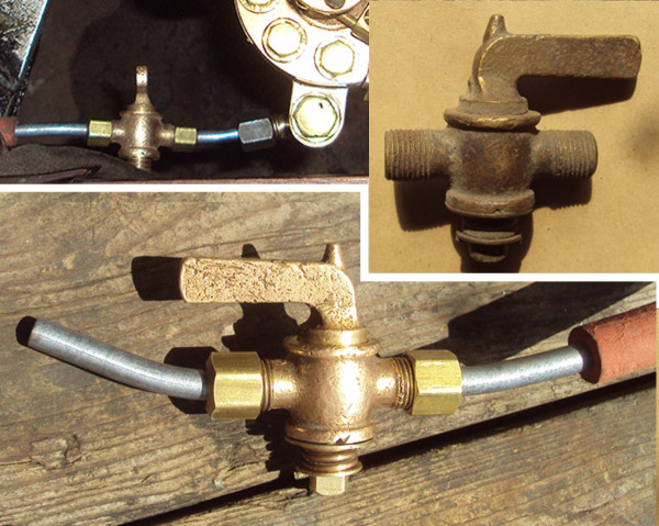

Some folks use a ball valve from the local hardware store. That will work if you don't mind the ugly modern appearance. That was a no-go for me, and I used the alternative shown on the model T pages at dauntlessgeezer.com.

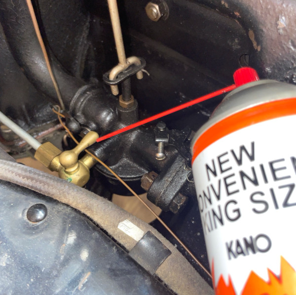

Re: Fuel shut off valve
Modern gasoline has so much environmental additives that gum up most anything
If the gas sits too long, like in a carb or shutoff, then things can stick.
My fix is simple, a shot or two of good penetrating oil. Lift the shut-off handle a bit, spray a shot, then twist a few times, spray again to freely turn.
Works for many months, then when sticky again, repeat the process. Easy peasy.
I found some old valves at a swap meet that I like to use. I don't know how old they are but I'm happy with the look and they work well.

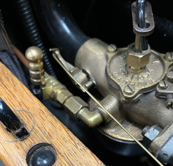

I used a modern commercial brass ball valve, but my son turned a piece of brass round bar stock with a hole up the middle. I JB welded the “vintage looking” brass piece over the ugly and modern looking sheet metal valve handle.
Not original or vintage, but it works for me and doesn’t stand out as out-of-place (except to the hard-core purist!).
