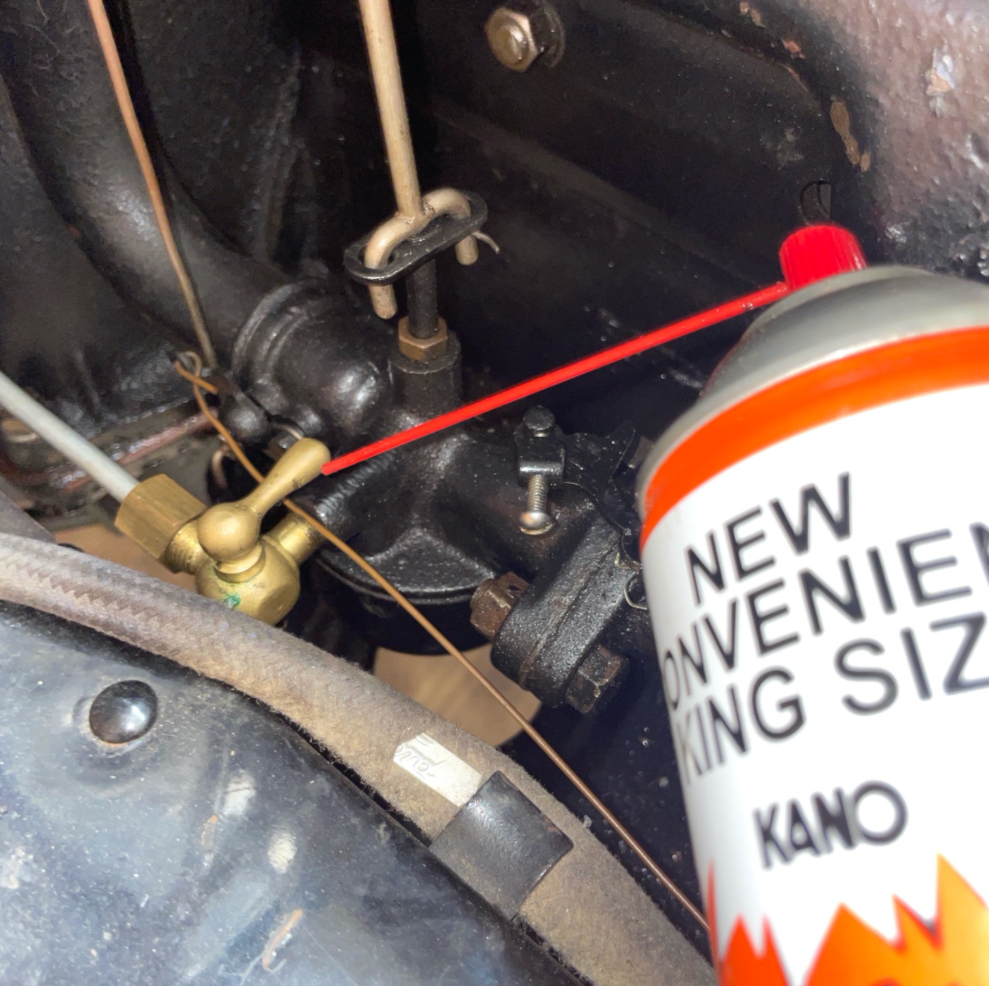

Post by DanTreace » Fri Mar 08, 2024 10:41 am
Modern gasoline has so much environmental additives that gum up most anything :) If the gas sits too long, like in a carb or shutoff, then things can stick.
My fix is simple, a shot or two of good penetrating oil. Lift the shut-off handle a bit, spray a shot, then twist a few times, spray again to freely turn.
Works for many months, then when sticky again, repeat the process. Easy peasy.
