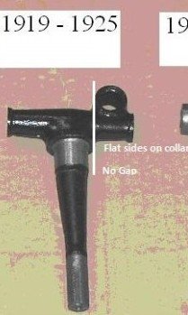

On January 31 (#36,972) the new axle with the two-piece spindles appeared. The tie rod now was below the wishbone. The steering drag link was threaded at the column end with a coarse thread (13 T.P.I.). Brass oilers on all joints except the drag link.
1911-1912
Same as later 1911. The steering arm with the hole for the speedometer, introduced in August 1911, was standard. Radius rod and drag link caps changed to forged type sometime during this era.
1913-1914
Steering drag link had integral ball sockets riveted and braced in place at each end. During 1913 the radius rod ball was secured with two studs, springs, and nuts, replacing the bolts used since 1909. In addition the cap was made a bit stronger by adding reinforcing ribs to the “ears” through which the retaining studs passed. The steering tie rod adjusting yoke now had its locking bolt parallel to the spindle arm bolt (vertical as installed on the car).
1915-1917
Similar to 1914 but the right steering arm no longer had the hole for the speedometer gear assembly. Oilers evolved from the brass type to the pressed metal type.
1918
The drag link now had integral forged ends, replacing the riveted-brazed type used since 1913. The steering tie rod was changed to the type with the integral left socket; the adjustment was now at the right end and was locked by the ball nut.
1919-1920
The front radius rod now fastened below the axle at the spring perch studs. Steering arms modified so that the tie rod now was above the wishbone. Oilers were all of the flip-top type. Spindles made a bit longer to better accommodate the new Timken roller wheel bearings.
1921-1925
Similar to 1920 but mounting holes in the radius rod now bored to fit a tapered nut for a tighter grip at the front axle.
Early 1922 Parts Lists show spindles with integral arms (one piece). These were described in a letter to the branches dated February 2, 1922:
T280C Spindle assembly, R
T281C Spindle assembly, L
“Starting Feb 6th we will begin making shipments of the above assemblies. The T-280C will eliminate the use of T280B spindle body, T7715B spindle arm, T77 nut, and T82 cotter. The T281C will eliminate the use of T281B spindle body, T7716B spindle arm, T77 nut, and T82 cotter. For some time you will receive both types� We will advise when full production will be new style.”
Then on another letter, dated May 17, 1922, the following”
“We have temporarily discontinued the manufacture of T278D and T279D, spindle assembly right and left. Therefore do not order any more until you are notified to do so. The above assemblies may be replaced with the T280 and T281 spindle bodies and the T7715B and T7716B arms.”
(T280 and T281 are spindles without the bearing cones, T278 and T279 are the same parts with the bearing cones. The one-piece type were never used again in a Model T.)
1926-1927
Similar to 1925 but spindles are higher on the spindle body to lower the chassis. New steering drag link which is about an inch shorter than the previous type. In late 1926 the axle was modified and now had a “droop” or “sag” between the perches.

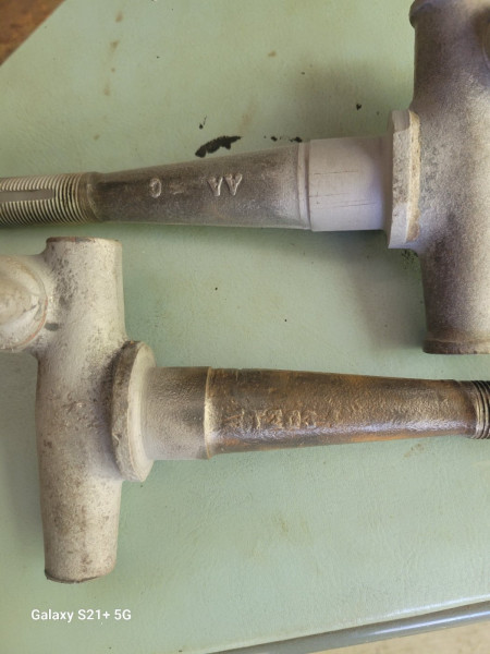

Explain why I have 2 different sized bearing surfaces.

John... You have two different spindles. What car are you working on?.. .....

You need to obtain matching spindle for the other side. These spindles use the tapered roller bearings in the wheel hubs, The earlier spindle use ball bearing style with separate races. .... Brass bushings go in to top and bottom of the spindle and should be fitted by reaming to the spindle bolts for that particular year car.

The lower spindle in your photo , Factory Number 203 B, Right, is for 1911-1917 cars. That spindle uses the ball bearing race and ball bearing inner, that is why the race shoulder is short.
The other spindle is later, for the Timken bearing race and inner bearing.
The Timken spindle will have Factory Number cast in the body '280' for right side spindle body.

He's building a building a 1924 depot hack and has two different front spindles. Should have looked at the picture.

John, to my eye, neither of your spindles is correct for a 1924 car. The lower one is early and takes the ball races. The top one appears to have the off set typical of the 26-7 cars.
The ones you need have the shoulders under the bushings like the 26-7 one but the spindle height in the middle like the early one.
